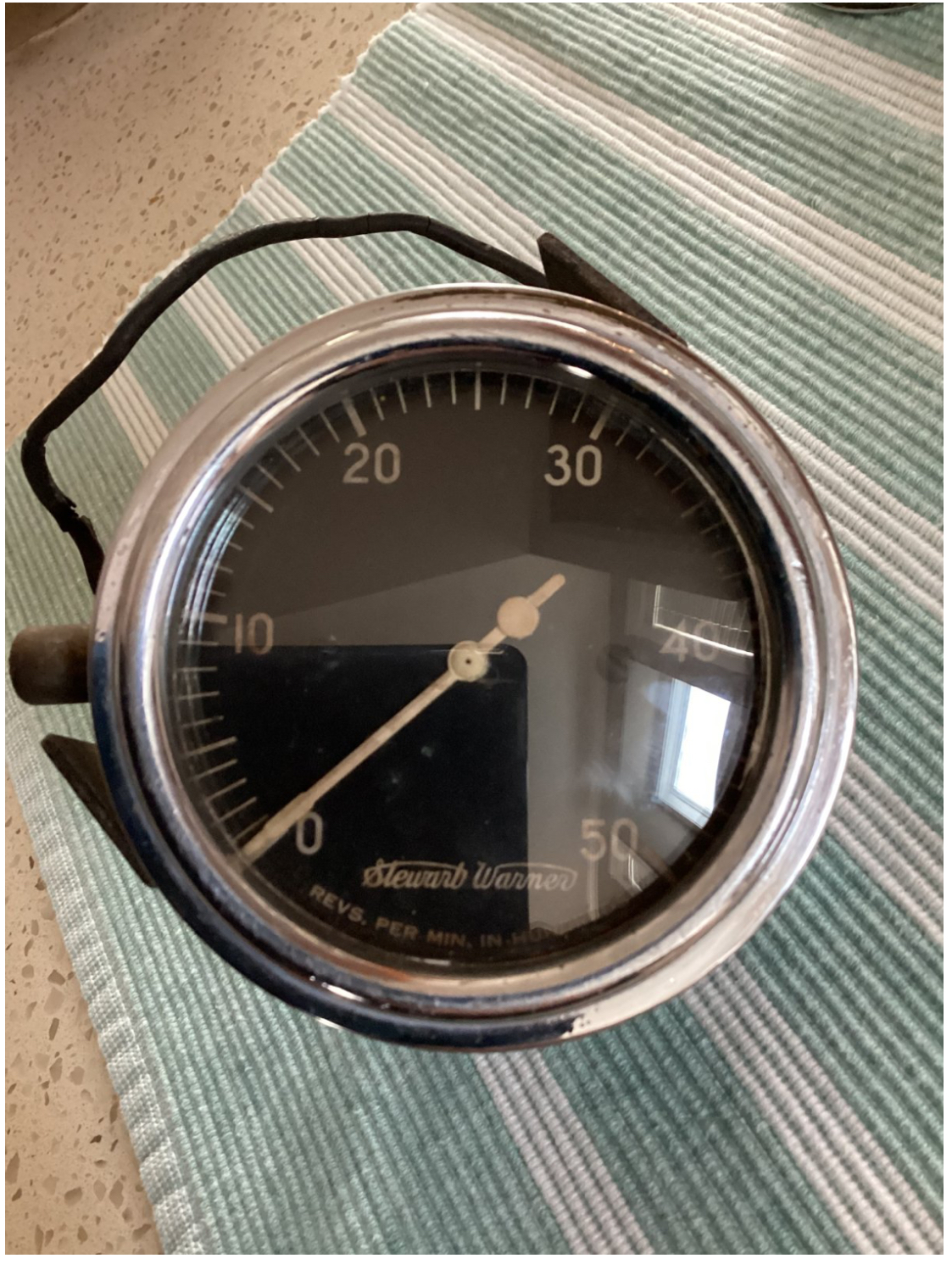

  1. My new to me 32 has a 401 without a tach. I have a vintage SW mechanical tach that I hope to utilize. I know that 5k is low but not racing either. IMG_1480.jpeg What are the options?

    Probably a couple of ways to drive it on your car. A vintage Mallory dual point with a tach drive or an early corvette generator with a tach drive. if you choose the gen you will have to match the lower pulley size of the corvette so it is reasonably accurate. Tachs that are driven from a dist are a different ratio than gen driven tachs. If you choose to use the vette generator your tach will read double actual rpms. they can be recalibrated or you can get a gear reduction (.500) to put in the cable
