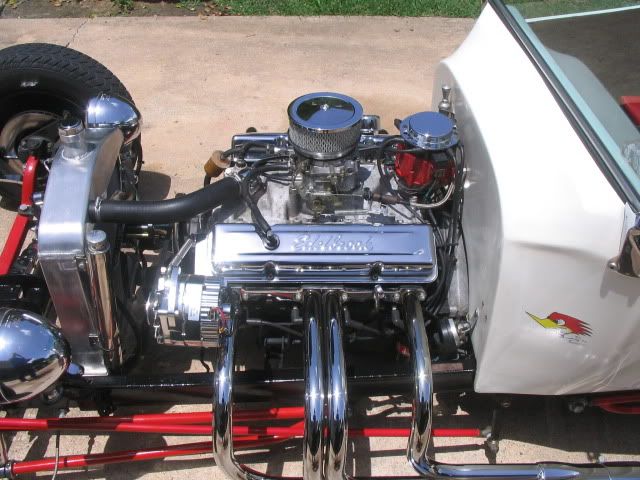

    I presently have a cable setup and I not only hate the looks, but about every other year, I end up replacing the cable because it frays and breaks. My car is a T Bucket. My assembly is mounted to the firewall and the pedal hangs almost directly in the middle of the tranny hump. On the engine side, the cable has to go around the distributer before it can connect to the carb. The sharp turn coming off the firewall is probably where the wire is getting frayed. It's almost a 90* turn.
    So, what I'm thinking is a throttle assymbly like a normal car, but reversed to put the linkage in a straight line to my carb. Speedway has something that could work, but I would have to reverse it and rebend the arm where the footpad would be attached. I have solid motor mounts, so engine flex is close to zero.
    Here is Speedways setup. I would reverse it, so the arm that connects to the carb linkage would be on the left.
    Would this work? Is there a setup already available for what I want? Is there a better way?

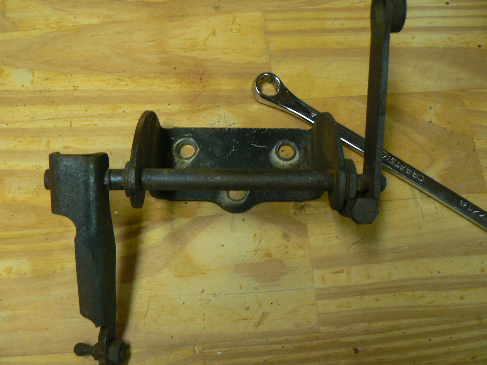

    I agree with Matt Thrasheer about fabbing one up. Here is one we are using in my coupe.

    I have that one. I need a way to connect a straight rod to it. Or could I use a rod and bend it the few inches to attach to this? That's what I thought of at first, but I figuered it would bind.
    See, I only need the rod to come over about 4". Could I use a "L" shaped rod without a bell crank assembly? It would be 18" long from the carb to the inside of my car, then bend 90* and run 4" to my pedal assembly. Could that work withoutt binding? That would solve the problem and I could get the rod at the hardware store.

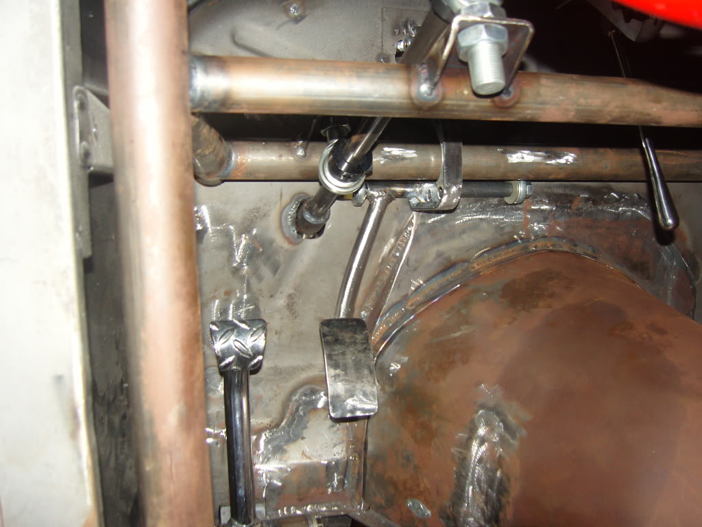

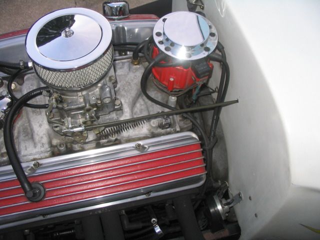

    After drawing out what I thought would work, this morning I got to it. I measured and figured that I would need 20" of tubing. I chose 1/4" steel brake line. I thought about using aluminum, but since I was going to put a bend in it, I decided to go with steel.
    I measured and bent it accordingly. It's an "L" shape. 15 1/2" from the carb to inside my T. Then bend 4 1/2" to my peddle.
    I mocked it up and drilled a 1/2" hole in the firewall, accordingly. Then I tapped the ends of the tubing to take a threaded 6.0 X 1 metric stud. On the carb end, I used the attachment from my cable set up. Inside, a metric bolt goes through the peddle arm and into the tubing. The peddle arm has 3 mounting points for tweaking the angle, as the arm moves back when the peddle is pushed.
    Total cost: $4.99 for the steel line
    $6.99 for the tap
    $4.99 for the metric bolts (I cut the heads off to make studs)
    Before. Look at the 2 crappy bends from the firwall and around the dist. :
    After:
    View from the inside (sorry for the bad lighting)
    Took about an hour. No binding. Just a nice, simple install and function. Not having the friction of the cable going arond the 2 bends in the previous setup is like night and day. Instant throttle response. I adjusted the peddle, so the lower edge of the trans tunnel acts as a throttle stop.
    Saved some money and got the satisfaction of doing it myself.
