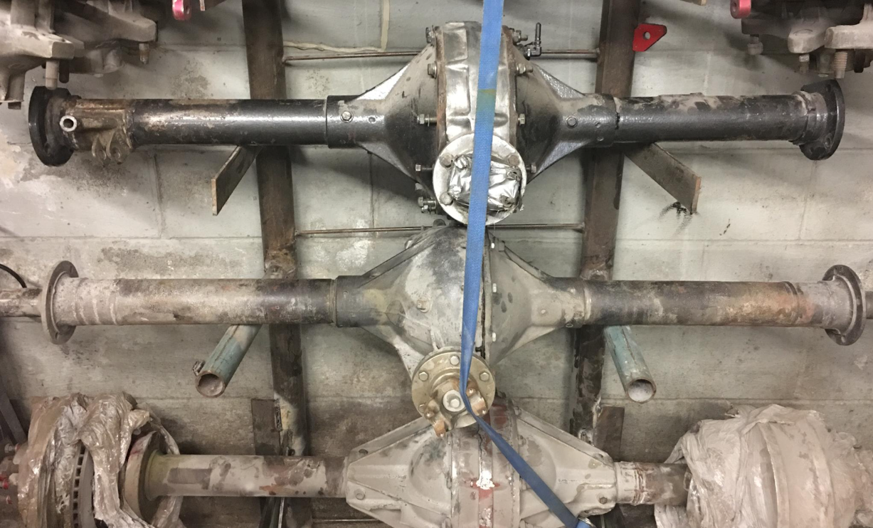

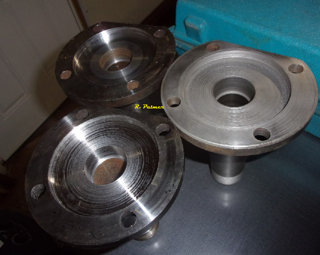

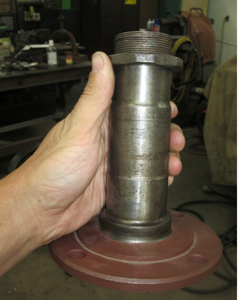

  10. As long as you don't mind changing to floater type hubs, if you use the old bolt on spindles disc brake oval tracks form the 70's to certain modern hub will go on early Ford axles.
    Most modern oval track parts are still based on the early Ford and Timken 3/4 ton floater that was used by Ford and Studebaker.
    I believe modern northeast Modifieds still run the same diameter and length axle kingpins as early Fords.
    My bolt spindle set up, however I am sticking with drums on my vintage stock car build.[​IMG][​IMG][​IMG]
    [​IMG][​IMG][​IMG]
    The 10 Spline (full size) Q.C. is based on the old Timken rear.
    The rear on the top shelf is an early Q.C. using to left side Timken side bells
    The middle rear is a stock Timken rear (likely set up for oval track rear)
    The bottom is a Q.C. with modern aluminum side bells with steel tubes note the aluminum side bells are copies of the old Timken.
    "Modern" Oval track cars run aluminum axle tubes.
