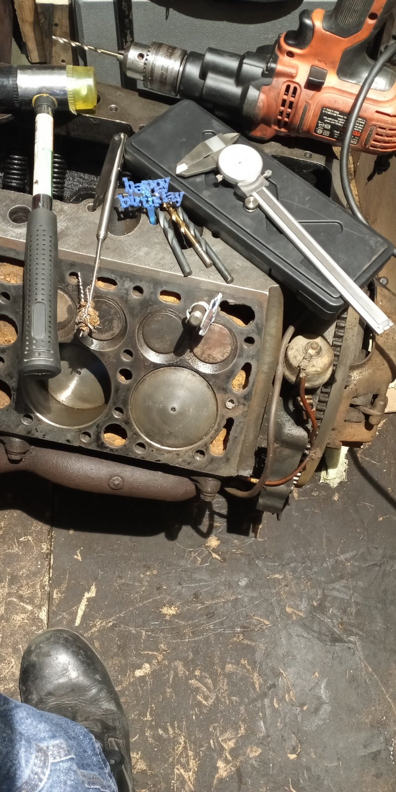

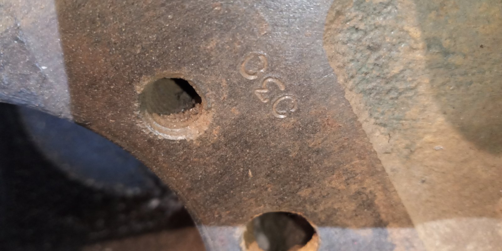

    So here 8s today's update . Some of these head bolts groaned and some were looser than others . This is a sign that either torque was not met properly or no 9ne retorqued . The head gasket was intact but rusty markings on gasket face . That's minor now that I cleaned up the left deck today and cyl 5 6 7 8 . The piston ac***ulator area is very nice indeed . Yes the all asked question , "How many ...?? "
    The answer is 3 . 2 broke loose a smidgeon and one fully froze . On right bank broke 2 for total of 5 broken head bolts . No cracks in left deck . Absolutely perfect deck . Check out these .030 over silicon popups cylinder walls fine slight ridge so MAYBE 30,000 on rebuild ? What do you think ? Here in order are cylinders 5-8 . Everyone enjoy your evening and stay well . Thank you

    This is surface scarring no pits a honing will rid all are alit less than half a thousandth and maybe ten over rings are necessary . The bad one is on the other bank it's spark plug had been left out so I slathered all cylinders with the Sea Foam Deep Creep I've been using . It's cleaned the cylinders well . I will let it all soak for a couple days so we see . If the cylinder on the other side cleans up it is a miracle but patience will be the one for that .

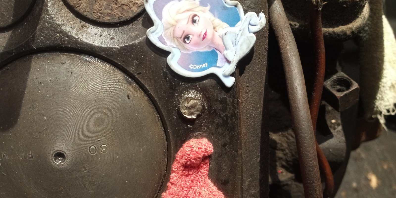

    Ok I see you are looking at the cylinder 2 from the picture I took after the first dose of penatrant . This I did clean lightly with rags shop towels and then a stainless steel brush and most rust has cleared up on this cylnder but not all so am soaking again . I'd I can bring back the silicon properties which have been transferred from the piston to the cylinder wall through the years then I will hone it and consider 10 over if necessary . To me it's still early in the game and so yes it's still rough but not deep . I may be able to save the #2 cylinder and will know if more damage is cleared in a couple days . So I shall return to Freddie and cut out more pistons with the SawsAll . It's also but that's just fine . Everyone have a nice evening .

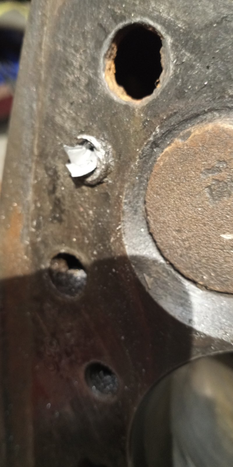

    Hi Everyone and thank you for your interest and replies filled with knowledge and experience . I am going purely old fashioned here with removing broken head bolts . Welding nuts on brings block temperatures way beyond 700 and even though itsomentarily I'm not going to crystalize or Martensite my block today . My same rules with Freddie go for Flo . So yes I am going to start with the bolt next to cylinder #8 located at 2-3 I clock . These bolt sheared real easy so have no tensile or compression strength in them anymore or someone didn't use a torque wrench I don't know just know heads are looking good no visible damage on them so I'm going to start drilling . I've been doing broken Flathead studs since I was 12 , my grandfather teaching me by telling me to be careful and it's going to take awhile ( on my 221 was 11 broken head studs and crystallized some were ) . I spent 2-3 months on those so hope these go a little quicker . The protractor in the picture is to keep a check On at the right angle so let's see if I can save the threads and not get any cracks . Thank you and please do reply I'd really like to hear your stories and comments on this one . Oh yes one stud is broken deep , it's last inch is in the block . Have a swell evening

    Do what @Mart did (I used his idea recently) drill a tight fitting hole on a length of flat bar. Weld the stud to the bar. (Through the hole). Let it cool.
    Start wiggling the bar and work the stud/broken bolt out.
    Very little heat actually gets to the block, but the bolt gets hot, expands and contracts when cooled and hopefully breaks the rust bond.

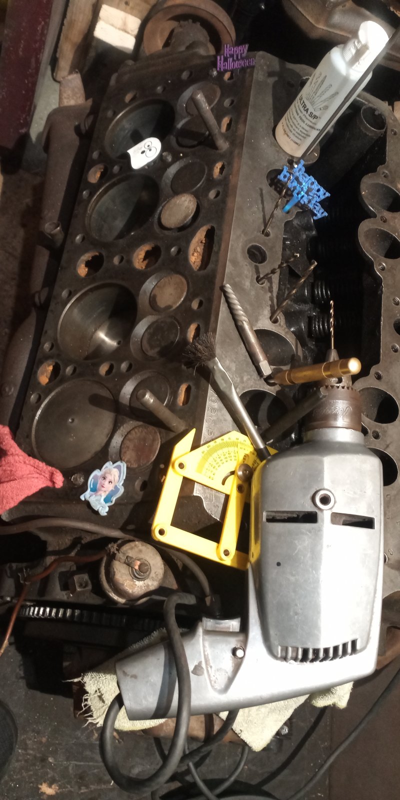

  20. With a lot of studs/bolts to drill, you might give some thought to building a drill guide that would have a big enough footprint to sit squarely over a fair large area of the block and ensure the drill goes 90* to the head face. It wouldn't help much in centering the bit, but would take out the perpendicularity issue.

    Great thought and definitely going to use it for future engines . Going to draw one up Tonite and go to Weldy School tomorrow and start building one . I got some drill guide inserts at. Freddie and Flo's . It's always fun building tools and jigs

    I remember this video now yes indeed when I popped Flo's heads off these head bolts were like ****er no mechanical properties left in the material and all of the bolt that came out intact were screaming and many I had to work back and forth due to the fact that Flo's heads had been off at least the two times to my knowledge as I can see once through a valve job and then a rebuild and now me removing these bolts . Flo's head bolts had never been replaced , so when they started shearing I thought about how I know how to remove the stubs and out of curiosity and searching for another approach I did a search engine after trying HAMB and yes the English guys video did pop up , I watched it and dismissed it as exactly what you said of him making it look easy and yes he had done. bunch of them . What made me dismissnhis video is the ease of which his bolts came out . It took me two days to take Flo's out it was quite a workout and I'm 6' 200 lbs of racing muscle . The English guy his bolts weren't really making much noise and Flo's bolts were screeching so that it echoed and that was after a couple weeks of penetrating oil multiple times . I used a 3 ft breaker bar and a 3/4 rachet and tapped them also with my array of hammers . One thing is someone before me should have replaced the bolts and was cheap about so the material was below tensile strength and ductility was zero . I havenothing to work with here except Playdoe . Funny before I left the engines after breaking off the Easyout I did drill through two of the three broken stubs so I can cave them in and penetrate oil some more . Ya like you said Tommy it looked to easy and his bolts weren't noisy and no real power was out into his project . So I'm drilling out to the threads collapsing and penetrating but I promise I will use the English guys process on the other bank and we see how effective it really is . Have a nice evening
