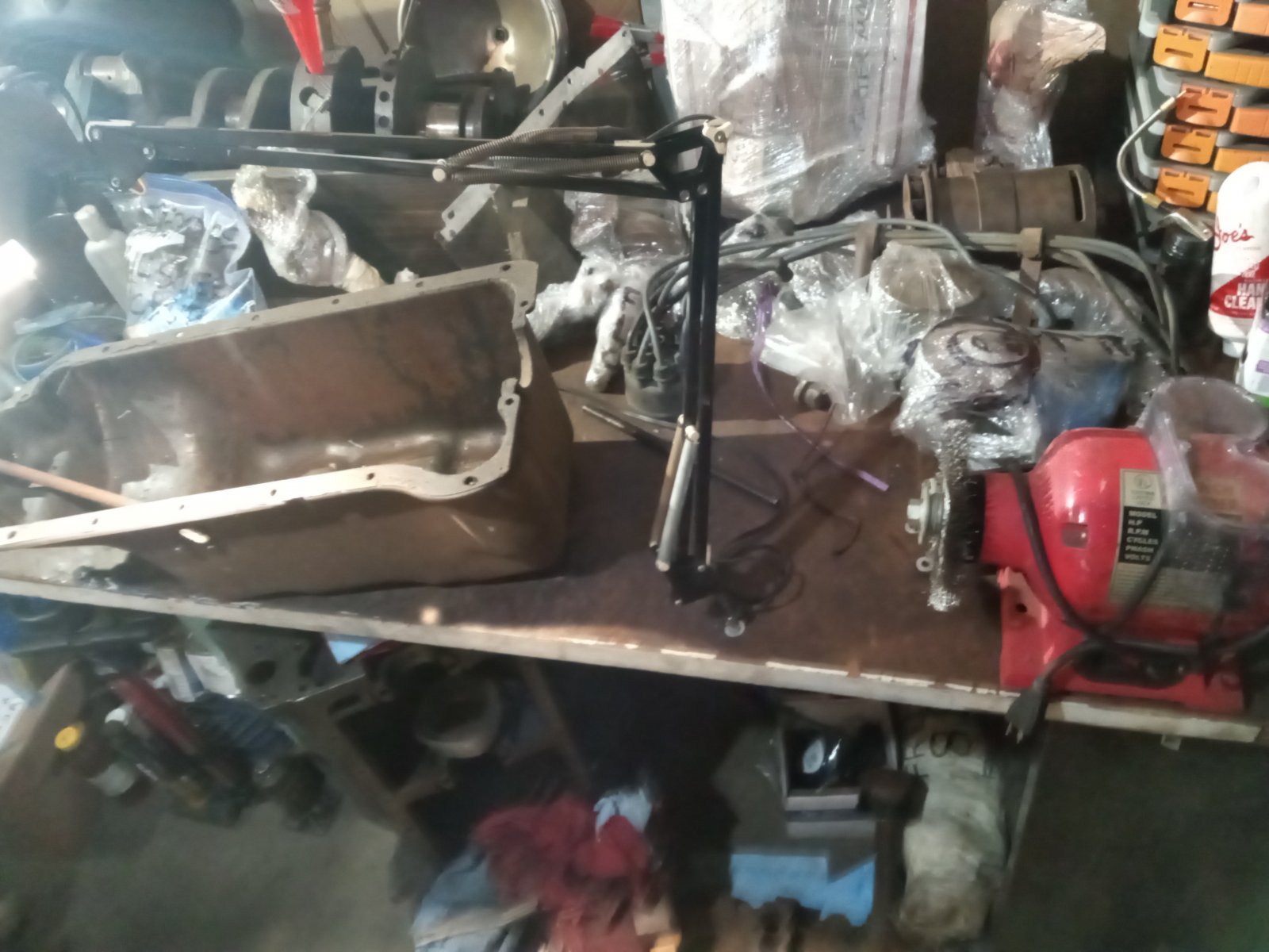

    ... since any kind of work let alone progress and really wish your alright and making it in a positive note , well I had to work on myself for the last 3 weeks due to that accident 10 years ago funny tomorrow is it's anniversary in my head it's like it just happened and a grand glory indeed has taken me this far instead of taking my life so I did start planning this project in a hospital bed back then so this is truly my miracle project my it took 5 years to get my hand back and everything else is still coming into place and I say this because I am a tool in this project this project is bigger than me and I'm proud to be it's chosen one so I make every bolt and screw count I just don't know any other way and I am amazed at the parts that have come my way towards this project and all vintage no catalog yet !! I know I said it before so let's get to now .

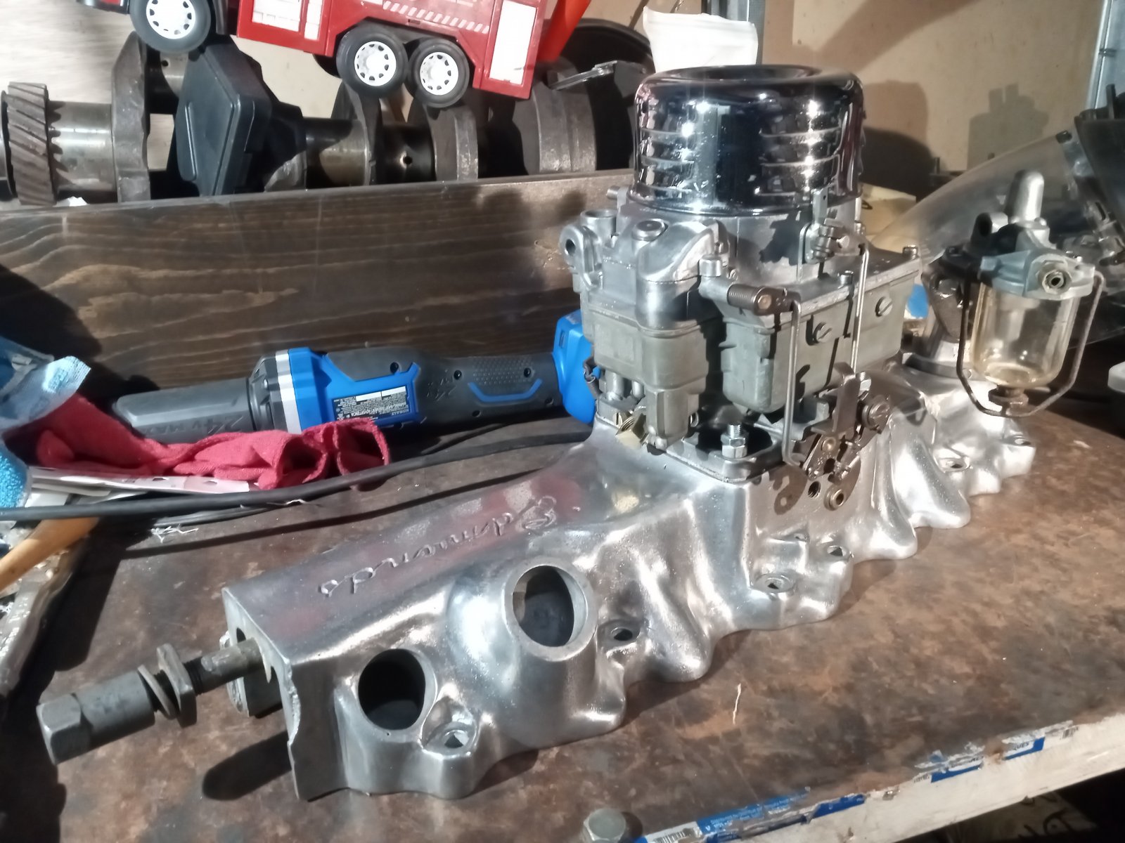

    You never know who you meet when doing a build see I walked into the Auto Zone see if I could supply up you never know what a place has until you walk in their door and walk the aisles . I needed some sandpaper and couple cushioned sandpapers and that's what I got there it is good enough to satisfy the projects needs so as I walked to the counter one of the employees ( manager ) said he liked what was on my TShirt it was a string of F100's so I told him thank you and I got a couple '53 Flatheads I'm building and socking away '32 parts but who knows maybe I find a truck or a Shoebox it's still early in the build and he says to me , " Oh that's super I've got a Shoebox at home I'm not done with it yet got some problems with it's 327 I put in it ! " So we talked for few minutes he showing me on my phone and when I saw his car picture I told him a place he can get some real vintage parts local he has been catologing it thru his project and going to Pomona and Long Beach swaps , well I thought today I go back and offer a hand with the 327 it keeps breaking stuff so I ain't going to charge anything it's great to know someone as yourself at just a walk thru a door .
    Well here's the Edmunds manifold and polished more on the fuel pump also the manifold is coming out good getting all the pock marks I can out of it cross sanding with 1000 then clean with MEK on a.detail rag then again and .... ..... .....
    ...then fiddled with the 2000 and the 3000 and it ain't ready yet for 5000 got alot of hours to go it's just good to be here I'll get myself in shape for porting the rest of Flo and matching up this manifold in a week or two and things are going to slow down for the next 9 weeks on this project as I got welding cl*** to coach and Im going to upgrade my AWS certs see COVID is over and the good jobs want higher grading of Certs now see during COVID they take any certs so gotta stay with the times ya know so have a good evening and it's good to be back with you keep your foot in it !

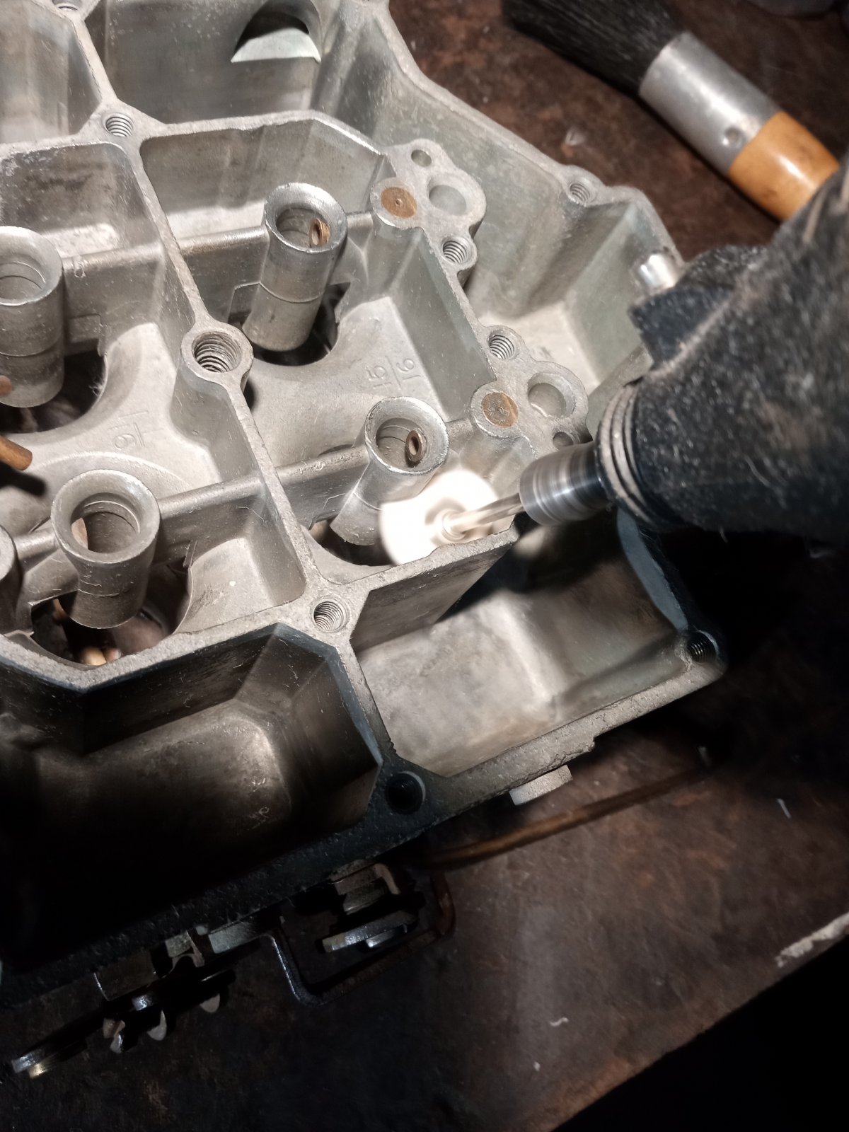

    Today the WCFB and Edmunds Intake got some more work you can see how first I used a Dremel with a funneled very fine wire Dremel attachment this one was good till it was a nub and used the nub to clean the corners and inside the jets I had already run fine wire through the jets like I did on the Chandler Grove earlier so after the I used the scrub brush on the die grinder around and inside the venturi system as much as one should I keep the tool moving around I'm not out to transfer material here just clean up just spiffy up a carburator to restore it's original condition and install a master rebuild kit and other necessary parts .
    So after the scrub brush attachment I went back to the Dremel and used the softest wooly attachment that came in an Amazon grab bag with attachments designed for 18k rpm . It's a steady hand for sure you don't want any nicks on the venturis so glad to know I still have a touch today !
    Did some more on the Edmunds piece started with some 3000 I still have the left side to do it's coming around and it's time to go I'm on my way to Alan's look for a choke ***y ( if not I don't really need one in L.A ) and some idle jets that are probably unnecessary with the Clay Smith 282-2 cam but it's unnecessary things that make it a complete project like the 2 bbl hats I got over the weekend at Vets Swap of Unnecessary Things ! Lol and the identical twin prewar oil pressure gauges from Lostmind one for Freddie one for Flo to be plumbed direct on block .
    If this all bores you you must be using carb dip and the internet Lol well on this thread we are in the business of acquiring grubby old unwanted parts and putting them together I call it cantankerous fun and as Spock would say , " Most logical Cap'n " .

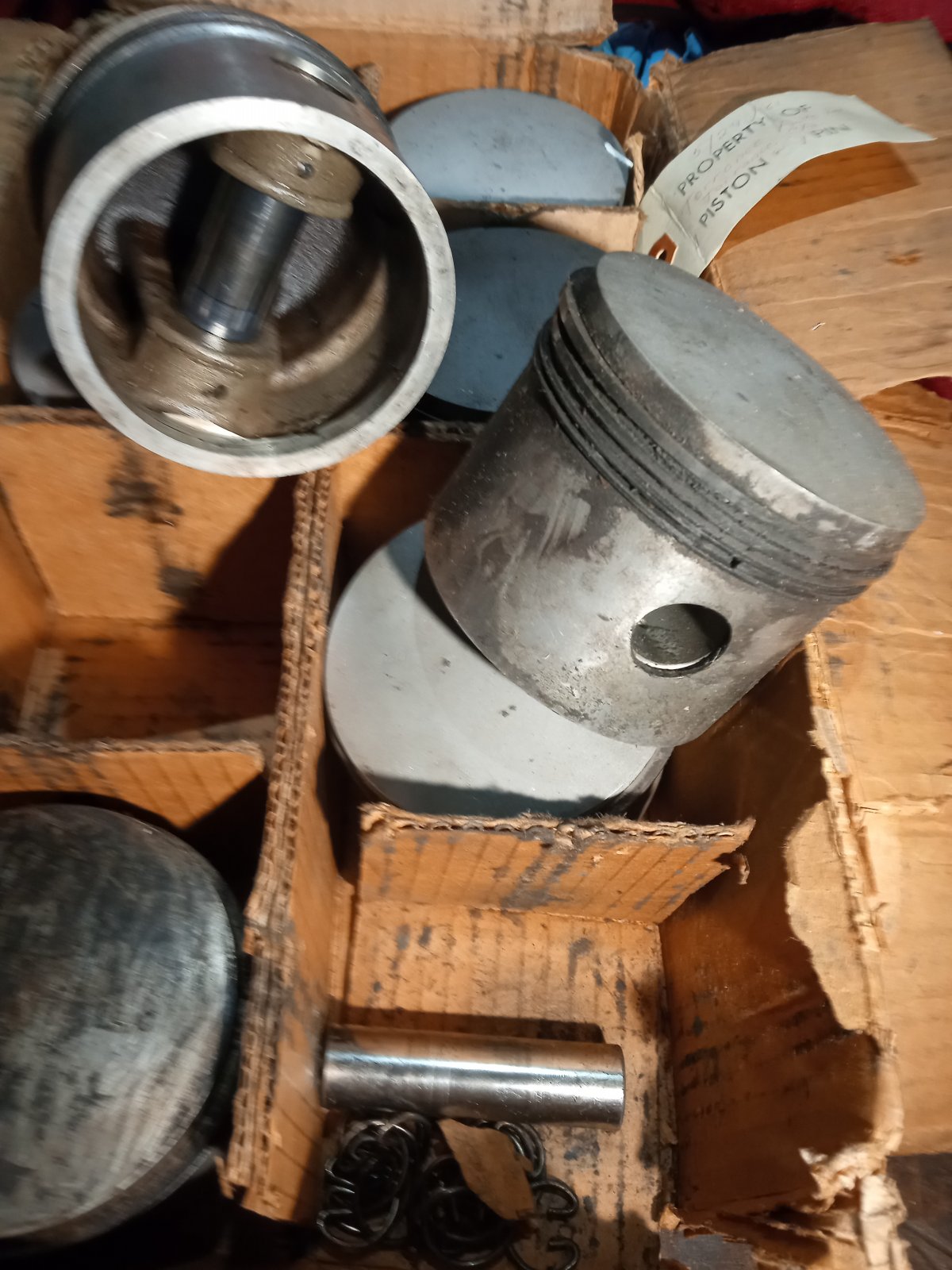

    Hi Freddie. The ugly curb rash on the cranks was part of the manufacturing process. The cranks were cast more than one in a bunch at a time, all joined together. The ugly broken looking area is exactly that, where the cranks were broken off the central sprue. Think of it like parts in a model kit.
    Shame about the oil filter. "It happens".

    Now editing : How could I forget such a thing as Pistons !! Seem to be chrome moly rings too !
    Yes the tag says 1961 but I don't think are for these pistons but tag was in this box . I can throw a blower on her now !! Also picked up an Extra Fine sanding kit has 320 - 12,000 grit yes 12,000 ! from Hobby Lobby also

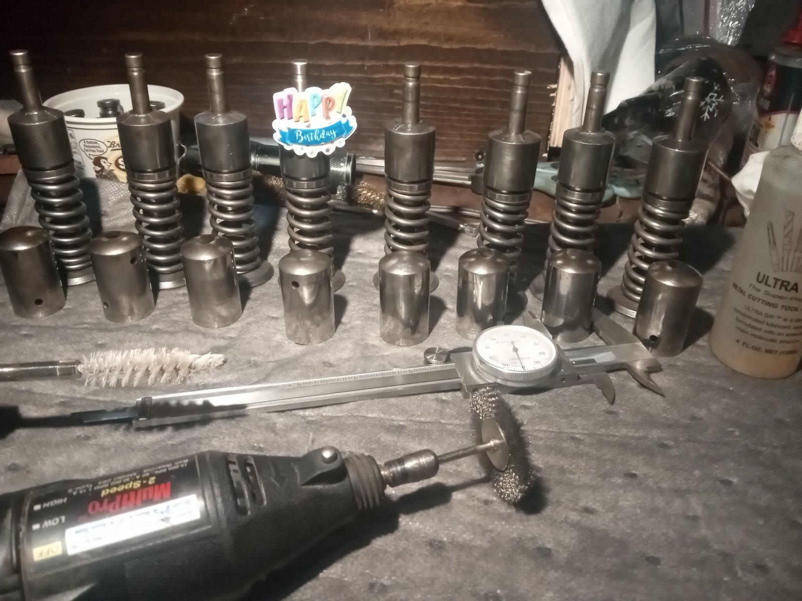

    We have serious parts on the bench we are cleaning and inspecting you can never inspect too many times with rotating ***emblies I triple check and if necessary take an average from the three measurements . I also have the Bench Mounted Inspection Light and a Magnifying Gl*** and a Jewelers/hobby headset/LED equipped Spectacles with head strap . The head strap looks kinda mental I'm gonna keep it in the box I'm not wearing Oxfords today .
    Also today we are going to break in the new WEN Rotary Tool and that doesn't mean we are going to burn it up at 32,000 RPM till it smells . It does come with instructions and they are going with the head strap for now but if you never used one please do read the instructions and abide by the instructions as Everyone deserves to go home happy .
    We have another new friend today it is an accessory bit by Dremel it is good for 15,000 RPM and is Nylon head designed for cleaning and polishing so exciting to try on the cast iron crank and th aluminum pistons . I don't think I should use MEK to clean the bit as that will harden the bristles according to my knowledge of materials and chemicals so first we are going to see how the nylon bit works on the crankshaft since aluminum will imbed in the nylon bristles easier than cast iron and we don't want aluminium transfered into the crank . If this nylon bit p***es certification by the Flathead God's lol we will continue to use it on the connecting rods next and aluminum pistons last . Everyone have a good afternoon and away we go ,
    ! I would like to post later in the evening as to how this all works out . The WEN comes with a Flex Shaft I gotta read those instructions for that lol lol !! 1668197508980321908008455068216.jpg 16681975594588567200273444088484.jpg the two journal on the left are as prepped as any of them are going to get . So the process in stepped order goes like this :
    WEN used lightly
    Clean with MEK on Handi-Wipe cloth
    Use stainless wire brush ( soft-med bristles )
    Clean again
    Use WEN
    Clean again
    Lightly oil journal
    We have two journals to go so we are closer to the starting grid ! It's off to the races !!

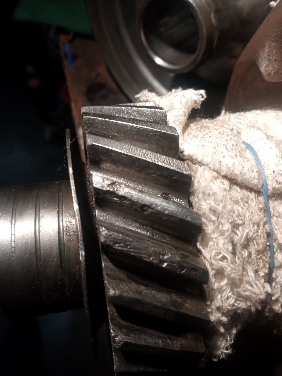

    1668450935098706542205961987730.jpg Hi Everyone , we hope your weekend was grand I rested yesterday so today decide to show you just what is the problem here and you know when you start picking parts some you don't realize will not fit till you get to fitting it all together which is what we are doing here along with reinspecting all parts and more cleaning . This is not an engine with it's parts anymore it's an engine project that is building itself and the aluminum timing gear is not going to work with the Mercury cranks gear . I've read a thread on here a HAMBer posted you have to change both gears out when upgrading to aluminum cam gear and you can see why so it's off to Alan's maybe one is inside a tire or on top of the roof ! Maybe I get the one off the engine he is putting together ! Lol Don't think I make it down the driveway to far Lol .
    So you can see in the picture both gears are cut for left hand teeth they never mesh running parallel!
    Saturday we finished the journals lubed and blanket for a two month nap .
    I don't want to but safer and smoother if I have **** shave another .005 " from the rod journal that will put Rods at 30 under and same done on the main journals will put them at 20 under if I recall my old measurements correctly . It can only be what it is and so far everything here is quite the survivor I do say now it's an interesting project . The details must be precision and proper or I'm wasting my time and money . So off to Alan's and the postal service has a delivery a brand new in the box Standard Dual Point Kit for 8BA distributors from Lostmind yes it's from that time era . That will be a nifty project when engine is getting a full treatment .
    Have a grand day and week also Everyone sorry not more progress but this is REAL not you tube . Gotta go

    Great things occuring we now have our feet into a car build we don't know which one now I'm getting kind of antsy and looking for anything with wheels that will hold the engine and that fever came around yesterday at Alan's as I got a left tooth cam gear from him . I thought what is needed next and that would be a transmission and I've wanted an overdrive and Alan has trans lined up and standing like soldiers on pallets all indoors and so I took a nice innocent walk through the transmission patch when all of a sudden there was one with white marker on it said 53 Ford and the word good and I see the solenoid actuator it's got the hump on the long tail housing and that ****** looks sleek I pictured it on my head dressed with Cornflour Blue Metal Flake so I put a hand on it and turned the output shaft for about 30 seconds it is as smooth as can be and shift levers p***ed feels tight and not even a scratch on the case .
    So my next thought was well now I can put all this in a 53 anything Ford this riding a bicycle thing ain't going to last forever it's healthy and in LA it's deadly so I won't be stubborn about being adament on the 32 Tudor but that is still the project I am collecting parts for but I want it light if running ONLY one engine cause I'm not running two engines with the 53 ****** with me that would last about a hundred yards of rubber and be parked and I ain't into that . So progress !
    So the crank is done I spent the morning on it's front ***embly we need a oil seal sleeve gonna get a full donut setup talked with some Shoebox owners works great so it is and with the proper left-hand tooth cam gear decided to restore the crank gear that is on there and worked out quite well . I've worked on alot of machinery and ships so it's just a must do for me I took out the pits and dings with hand files by smoothing each tooth top edge smoothing the sides and the troughs and depitting 4 teeth that had been 9n the bottom side soaked in water in the oil pan for 25 years and polished it up with the wire wheel in the die grinder and the WEN and cleaned up the snout with the wire wheel and working 2000 grit like polishing your shoes . I straightened the oil slinger cleaned up the pulley that took 2 hours it's grooves are showing signs of being a pulley again and polished it's inner sleeve and now it slides on and off the crank this is very important in a build . Now what did I do with the crank bolt it's in a box marked Flo somewhere ...
    After thought :
    The machinery and ship auxillary units do not spin at 4500 rpm like a Flathead can so I am sure **** is going to change out the crank gear he considers every pit as a crack and that is absolutely correct . That is an irreplaceable cam that is going in the engine I would commit myself if I blew it out of stubborn ways .
    So on that note let's get back to the '32 Tudor build Erika of course gets the whole back of the car so for upholstery came up with this idea it's glittery as she likes and her eyes are green and she born raised and lives in Gardena and she is quite the girlie this the pink . Course this is wild but so is most of the build . Just haven't figured how it's going to fit with a Cornflour Blue/Midnite Blue flamed Tudor maybe double tint the rear windows . I was surprised thought I'd experiment on her birthday gift it's tomorrow . It's a HW transporter/car set I usually get her a German car HW not this year I got her the HW Demon issue only like 8400 made of correct it's a purple '69 Dodge Daytona and a Dodge 800 Roll-off Transporter . Got her a movie book too she really into cl***ic movies and knows alot about them .
