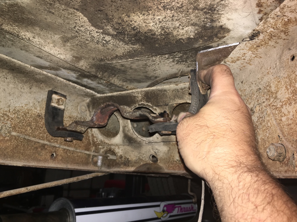

    Got the exhaust cutout installed on the rear driver side k-member and got the hanger installed for the muffler. ImageUploadedByH.A.M.B.1468787847.336331.jpg ImageUploadedByH.A.M.B.1468787876.035738.jpg ImageUploadedByH.A.M.B.1468787887.503377.jpg
    This stuff came off the original frame for the merc. So the muffler is hanging is I can bend up the other tail pipe. ImageUploadedByH.A.M.B.1468787992.495014.jpg

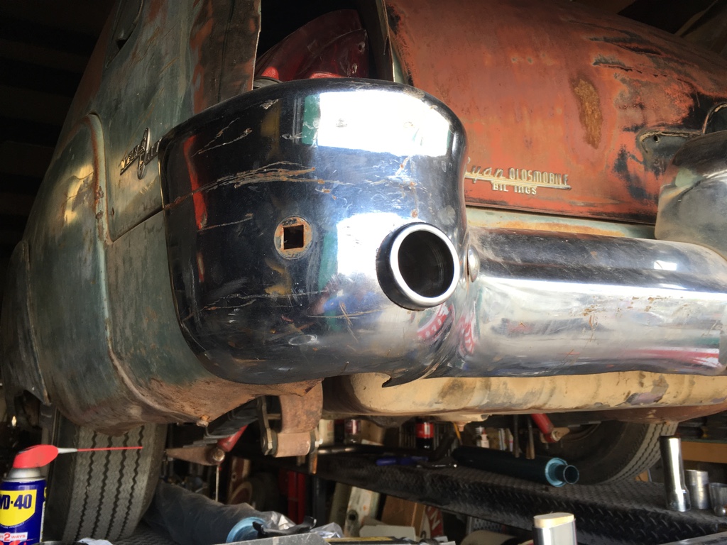

    And I got holes cut in the bumper for the exhaust tips. Found this car on kustomrama.com that was done in 1953. Philip Sauers merc has round tips thru the bumper.
    ImageUploadedByH.A.M.B.1469065904.376096.jpg ImageUploadedByH.A.M.B.1469065913.262755.jpg
    So mine will too.
    ImageUploadedByH.A.M.B.1469066007.516895.jpg ImageUploadedByH.A.M.B.1469066018.834837.jpg

    I like the exhaust through the bumper.

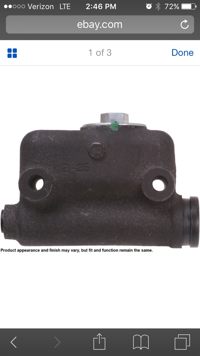

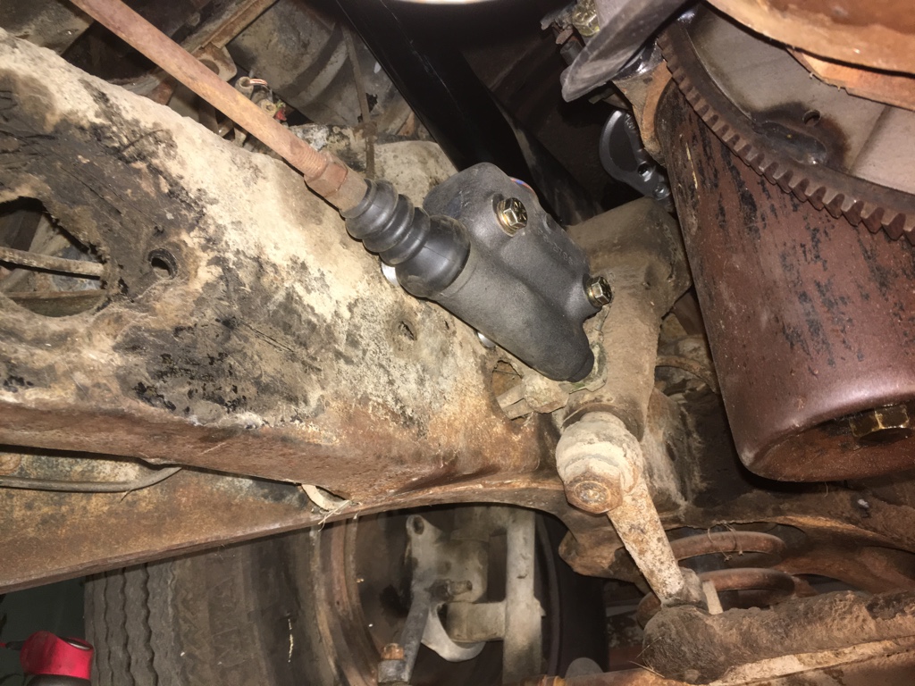

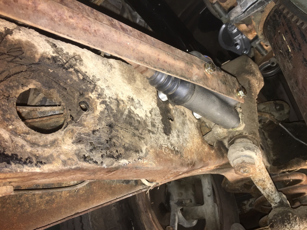

    So if anyone was wondering about a replacement master cylinder for the merc that will bolt on, well I found one. Dorman m2796 for a 66 jeep. 1 inch bore and mounts thru the side. [​IMG]
    New master along with the Mercs master cylinder [​IMG]
    And bolted on the car with spacers for the automatic pedal. [​IMG]
    And the automatic brace. [​IMG][​IMG]

    FYI; regarding the exhaust tips-the Phil Saures Merc was found and owned by HAMB member 51 mercules.

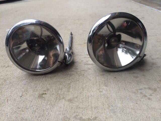

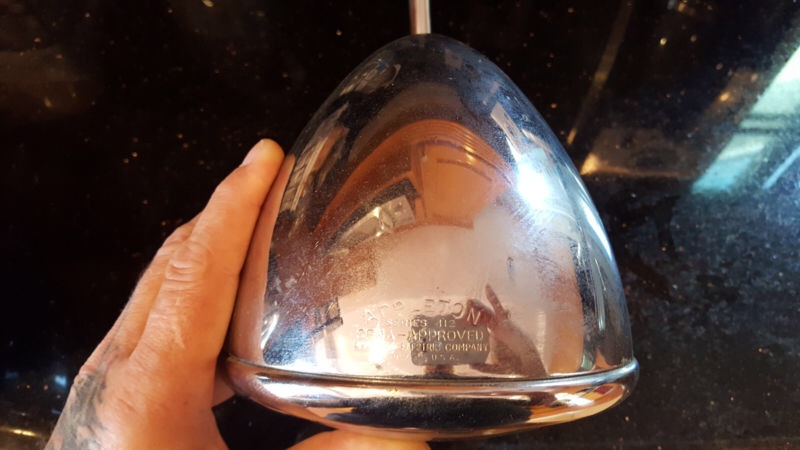

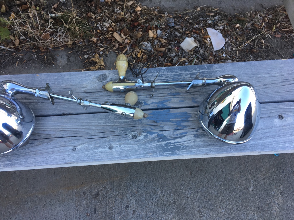

    Here is what I got, a pair of rechromed 112's. One light has most of the marking gone but the other is good. Has sealed beams in them but the wiring is gone so they need some work.
    [​IMG][​IMG][​IMG]

  28. drdave
    Joined: Jan 3, 2006
    Posts: 5,366
    drdave
    Nice! Dunno what to suggest about the stampings. Maybe an engraver? Most folks would never notice, though. ;)
