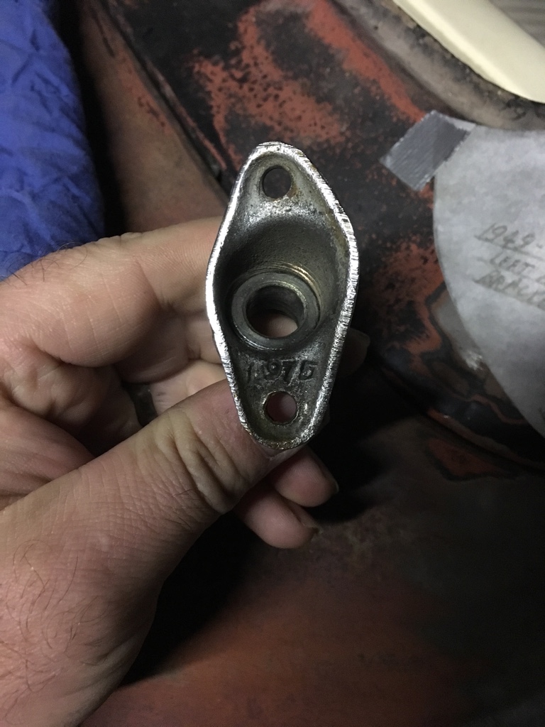

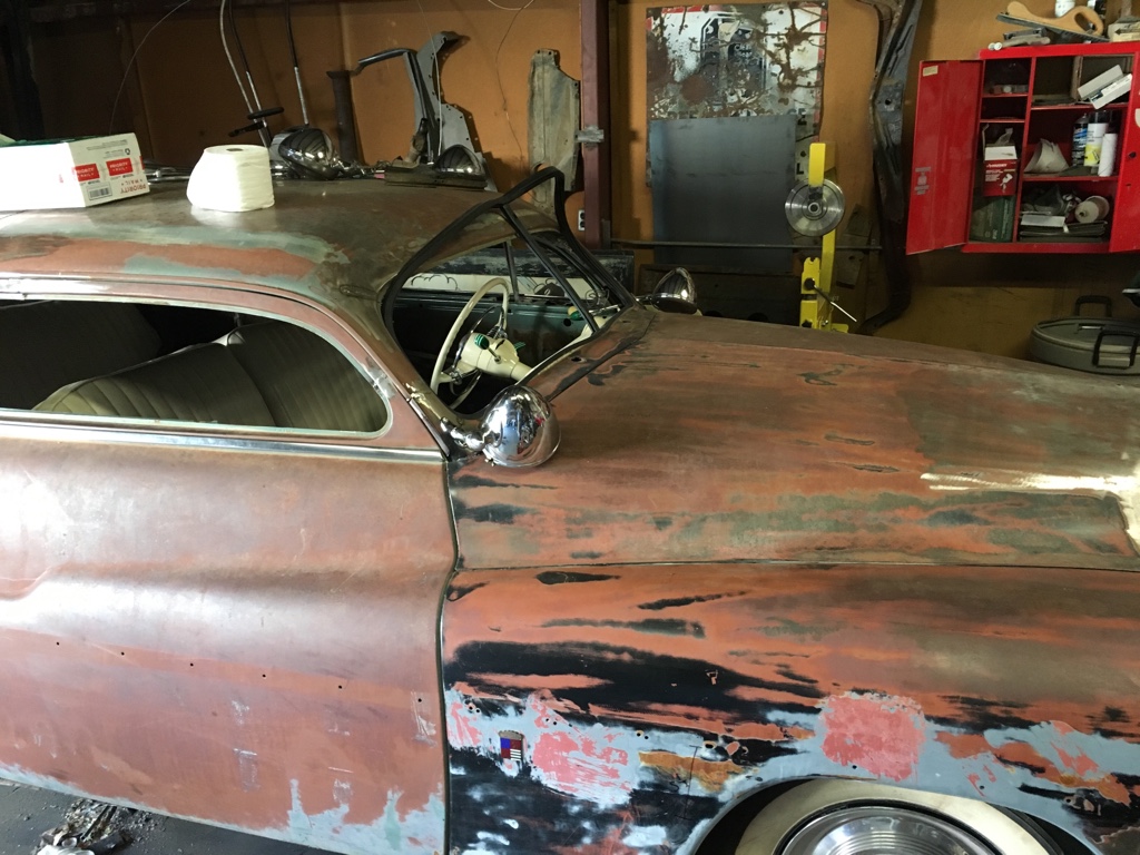

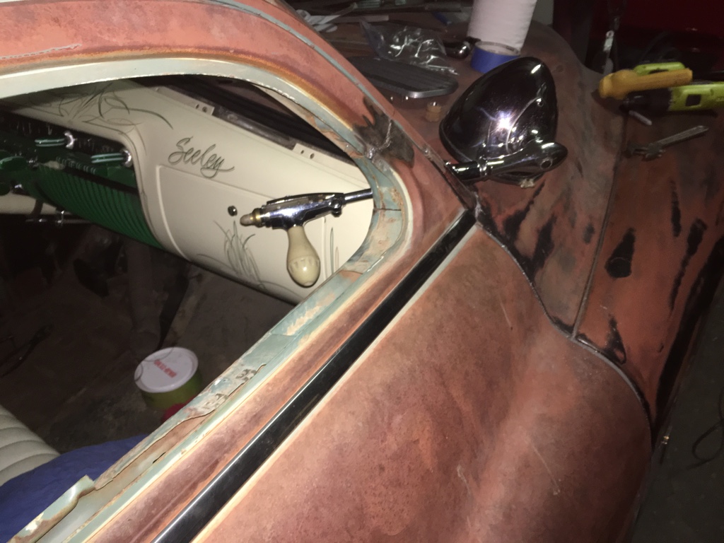

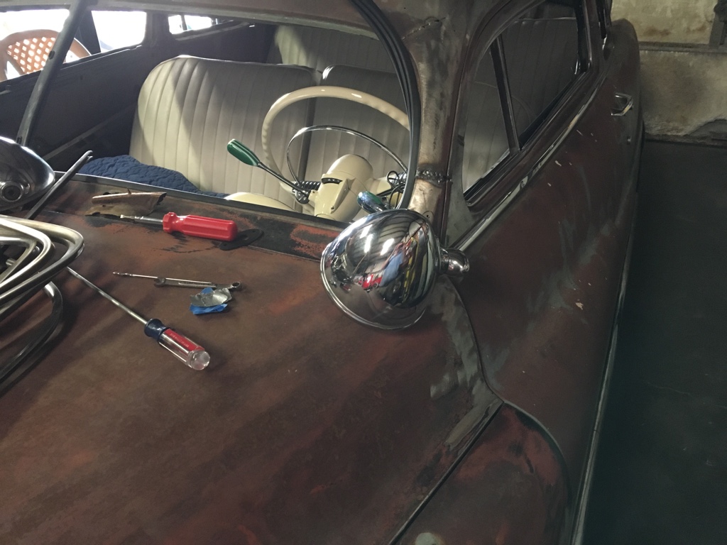

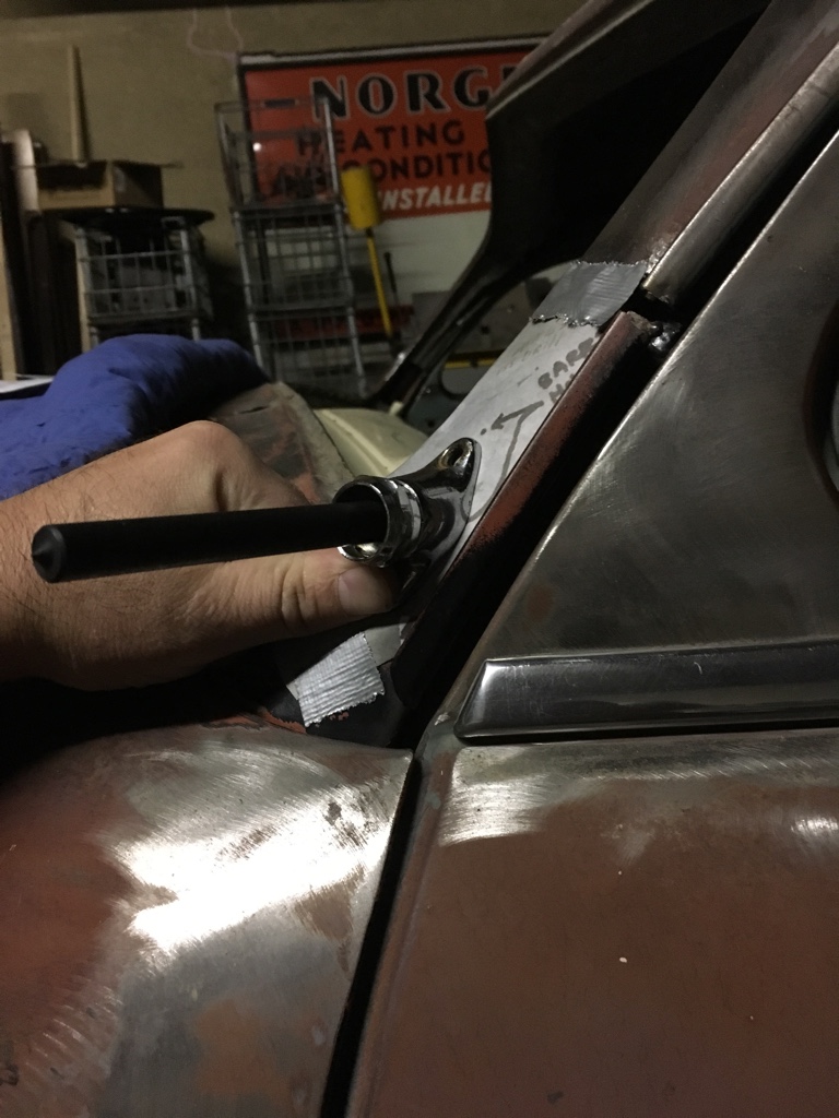

    Well I'm playing around with a template I found on the custom chronicles site and my L975 bracket. It seems to fit the Mercs window post really well and just has the slightest angle to it. I'm hoping to hear back from accessory land on Monday. If the don't have a L999, maybe they might have the L976. [​IMG][​IMG][​IMG]
    [​IMG][​IMG]

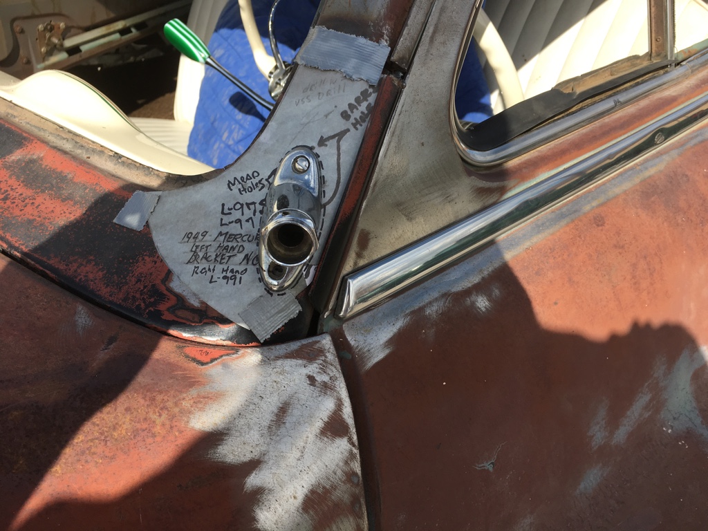

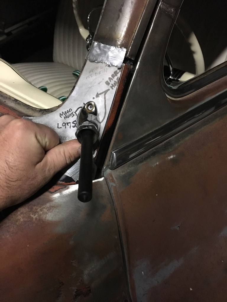

    I tried the L994 bracket and that one sits even leveler. The mounting is wider but that would be ok. Hopefully I can find a p***enger side mount. [​IMG][​IMG][​IMG]

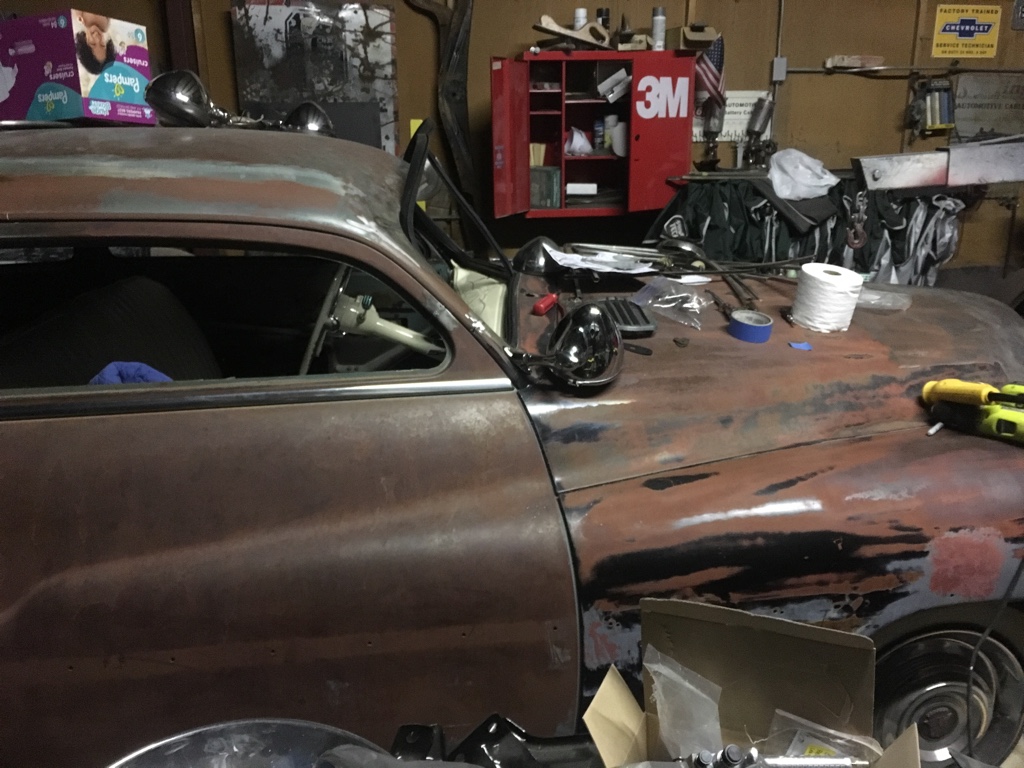

    And the back window is in and fits ok. Got alittle more adjustments to do but it's in. [​IMG][​IMG][​IMG][​IMG]

    Thats coming right along Keep up the good work Son!!!

    Both those brackets look like a pretty good fit and put the shaft pretty level, that's awesome! Glad you got the back window in. Sure has a nice flow to it. I really need you to get busy and finish welding that top and start installing your headliner so I can see how that's going to work out. LOL

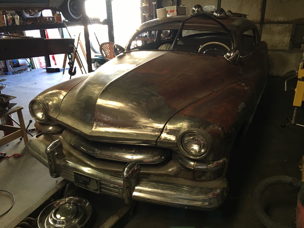

    Well I got a p***enger side L995 bracket coming from accessory land. Hopefully it will be here Friday or Saturday. Started making the handles for the spotlights and ended up getting an original drill guide! May have spotlights on the merc this weekend![​IMG]

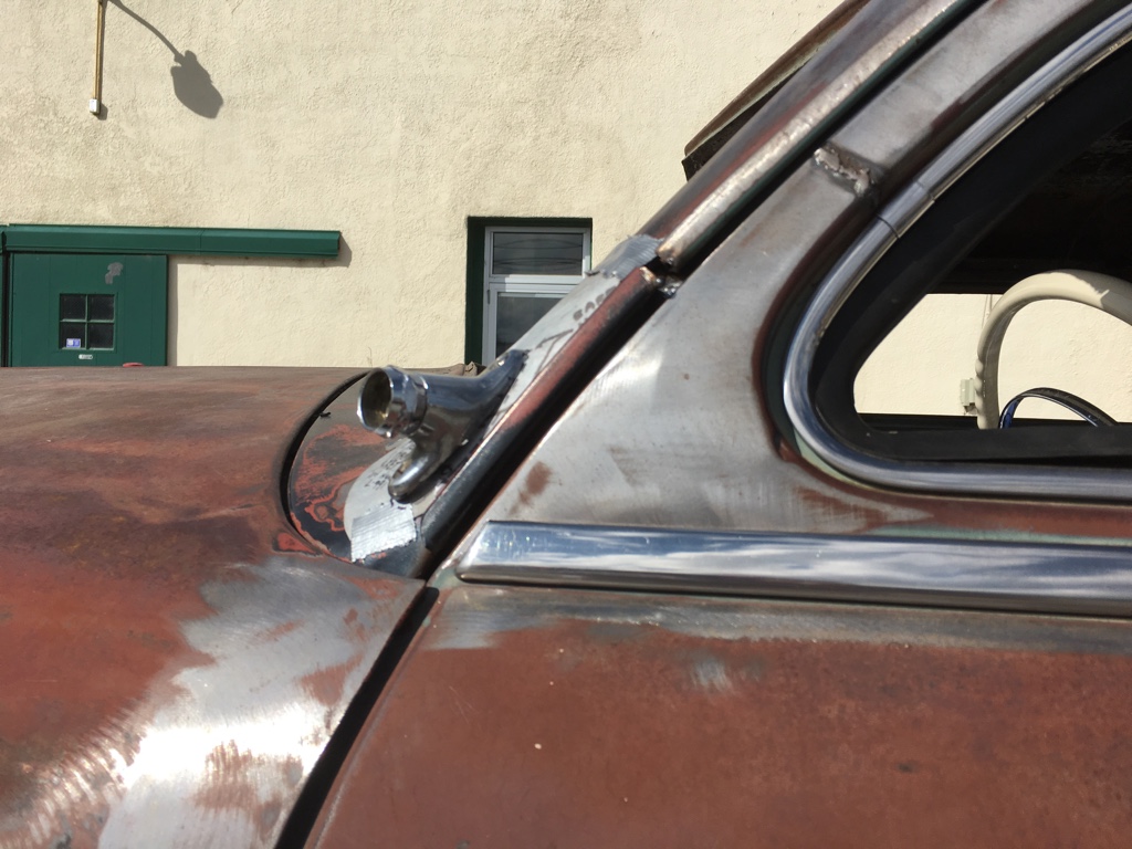

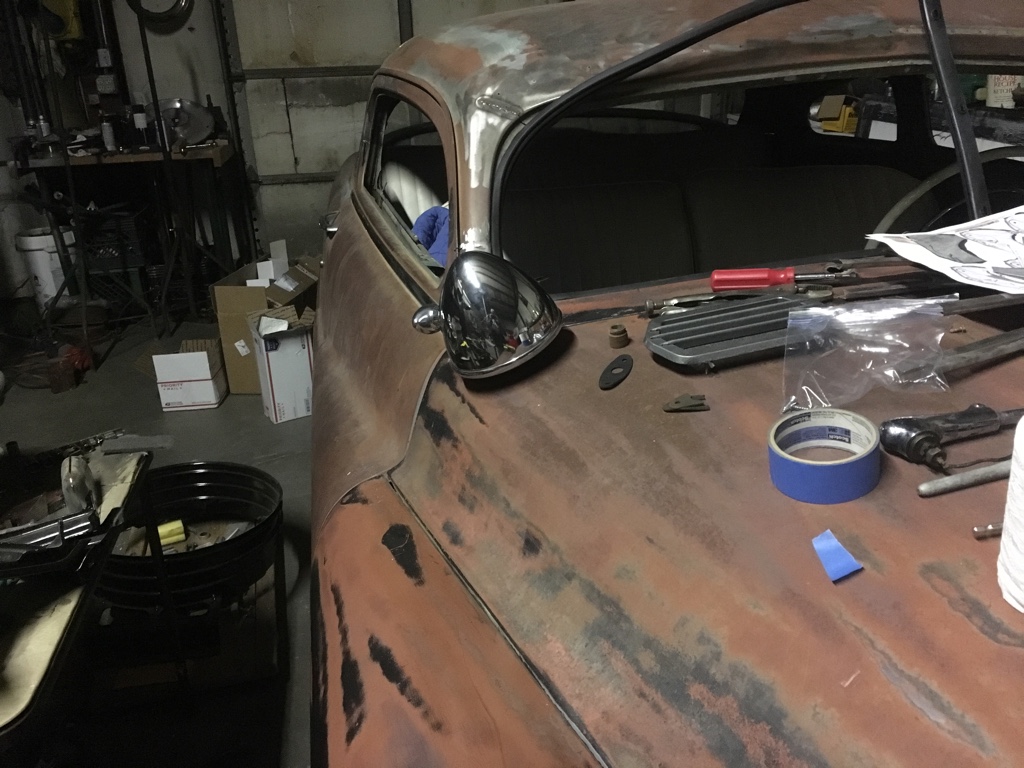

    P***enger side Appleton is mounted![​IMG][​IMG][​IMG][​IMG][​IMG]

    Excellent!
    I love that little pickup in the background. :)
    DougO68 and Kustomkid like this.
  17. Hot Rods Ta Hell
    Joined: Apr 20, 2008
    Posts: 4,839
    Hot Rods Ta Hell
    Appleton's and rear window look spot on.
    Great job. Keep moving forward!

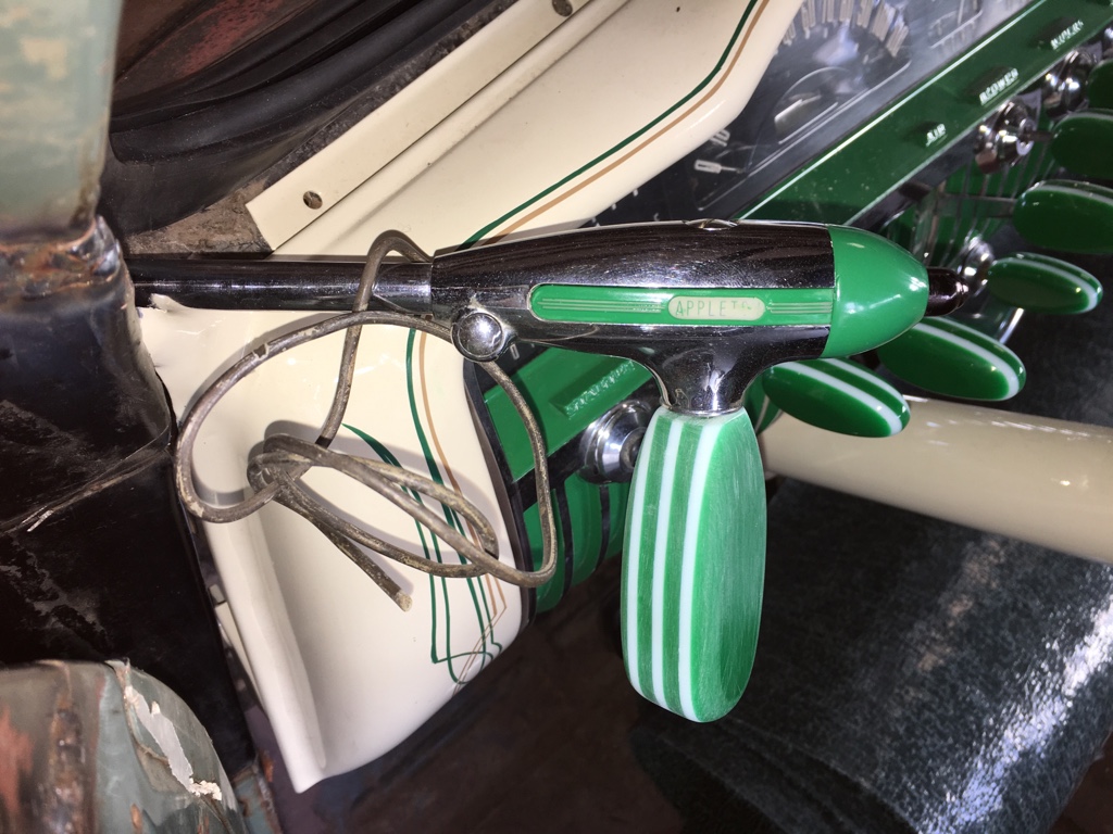

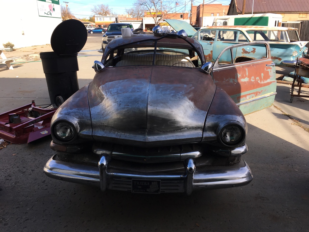

    Driver side is on![​IMG][​IMG][​IMG][​IMG][​IMG][​IMG]

    I'm liking how the green plastic pieces are looking. [emoji106]

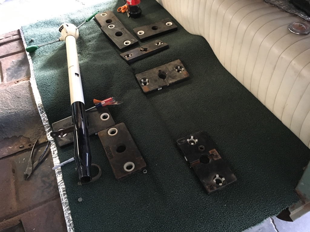

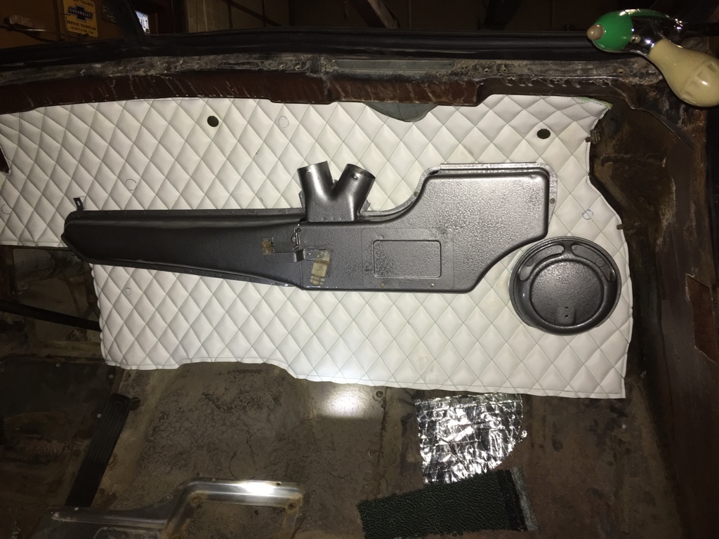

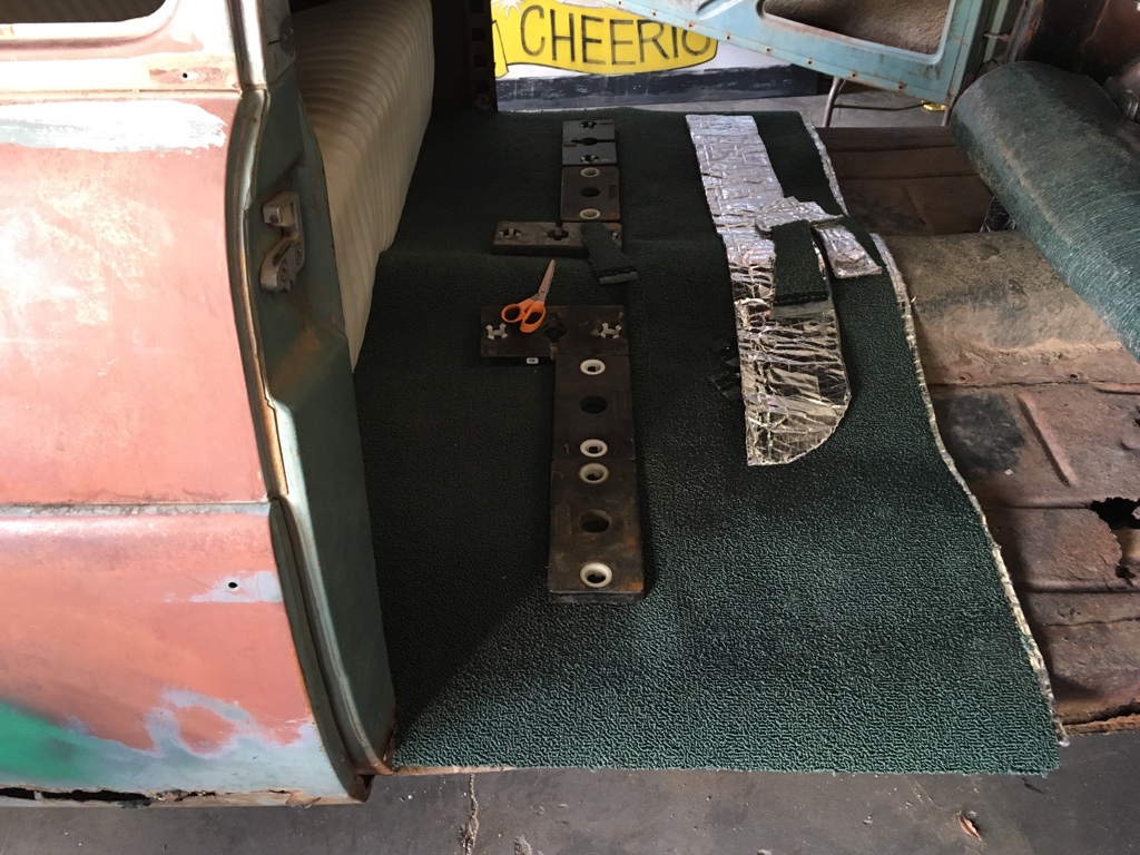

    I'm doing some test fitting some of the upholstery while dis***embling the car. The rear carpet is forming well with the help of some steam and some weights. [​IMG][​IMG]
    And the fire wall pad seems to fit![​IMG][​IMG][​IMG]
    I got the heater box and vents all repainted hammer tone pewter. Looks fairly original.
    To chop,or not to chop. That is the question.

    Best use of a work out machine I've ever seen holding down that carpet. [emoji1][emoji106]

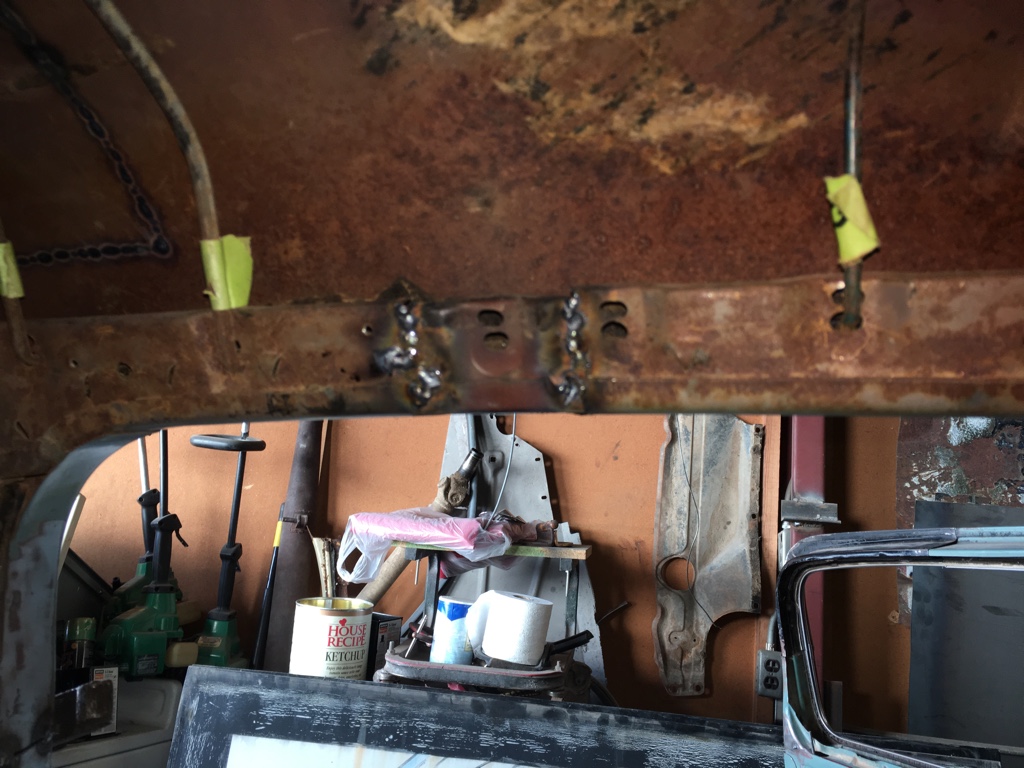

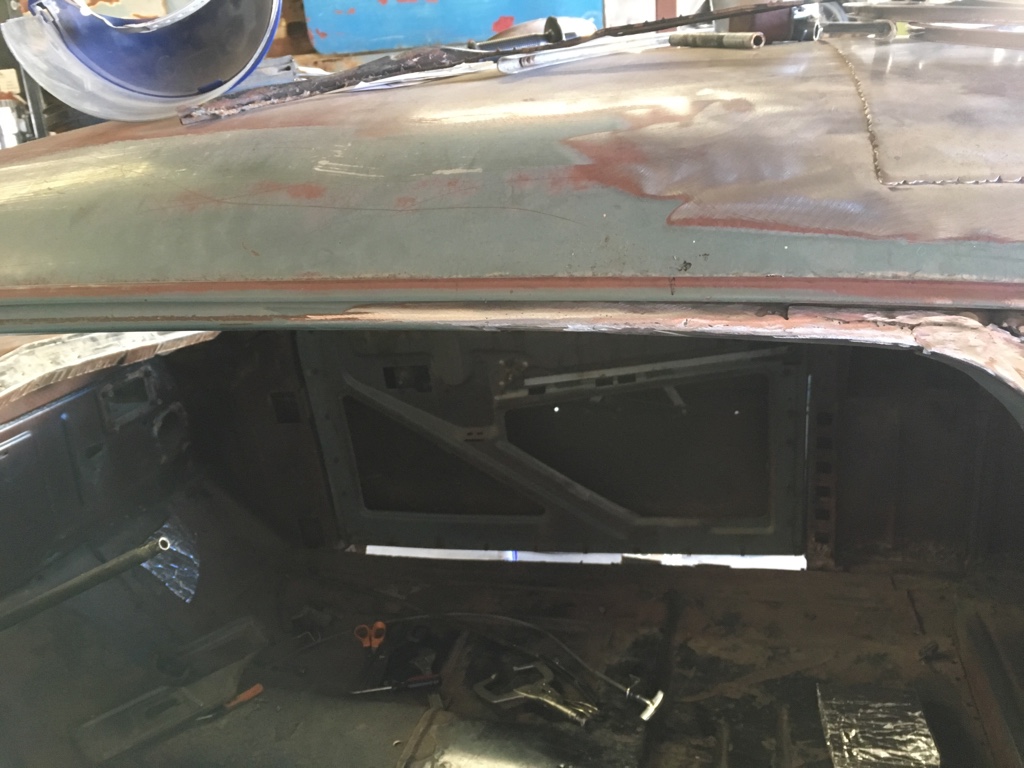

    I was able to get some welding done today around the windshield post and the gap in the door jam. [​IMG][​IMG][​IMG][​IMG][​IMG][​IMG]
    Hopefully I can get everything ground down this week and everything cut to weld up the p***enger side next weekend.

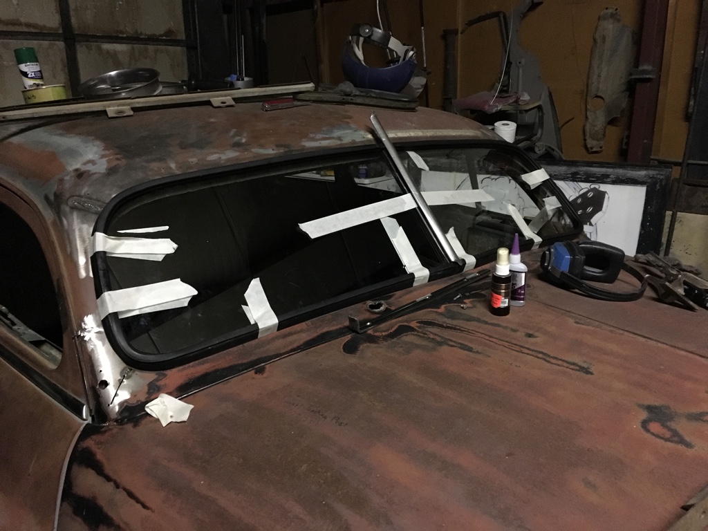

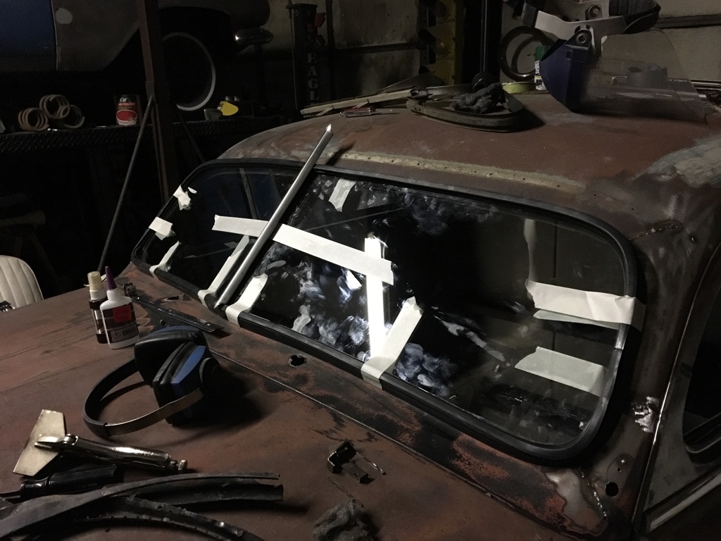

    Got the windshield cut today and got the gasket cut down to fit. [​IMG][​IMG]
    I think I might cut down the center bar trim tomorrow night and see how that fits.
