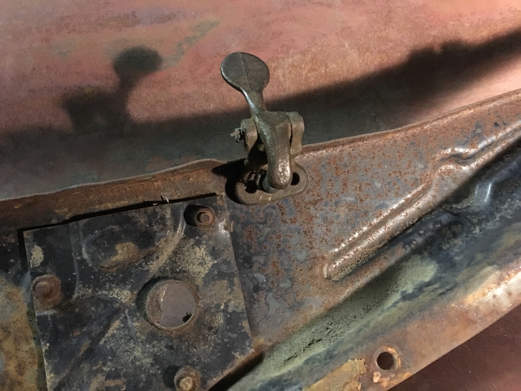

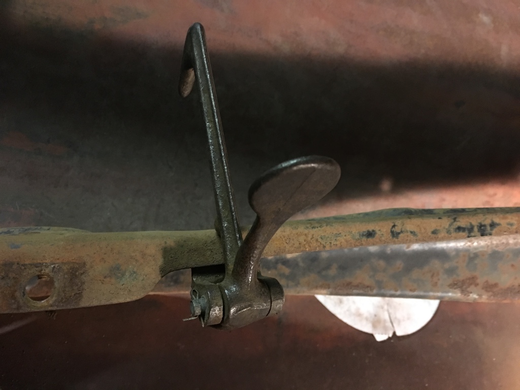

    Kustomkid

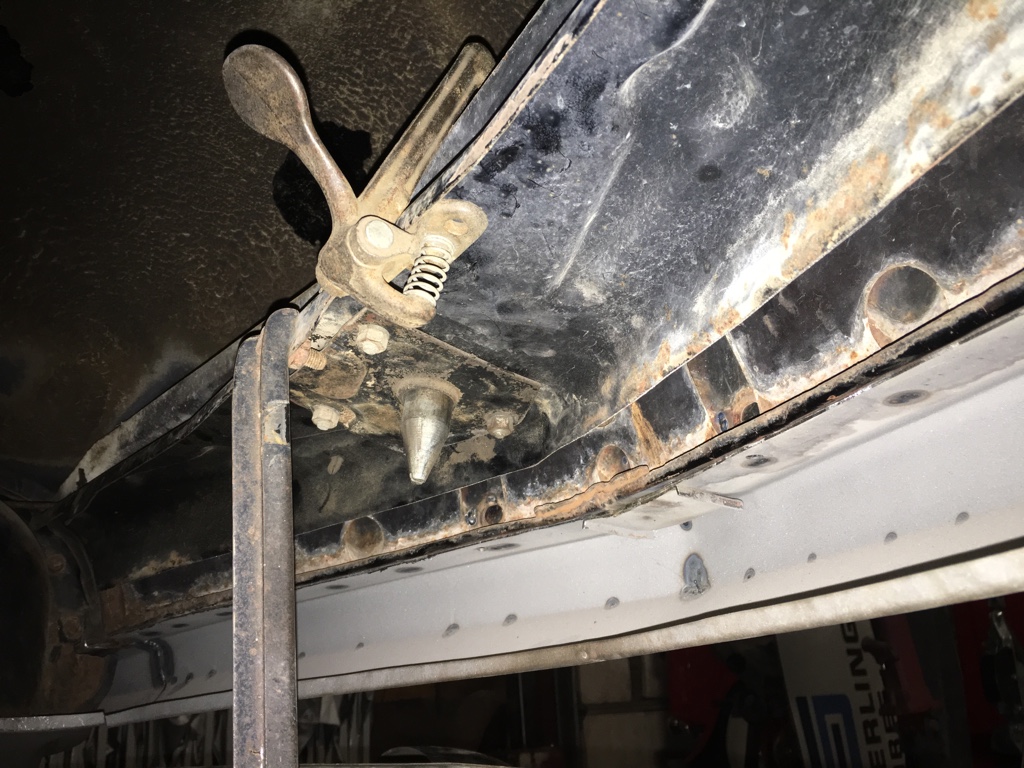

    from Montana

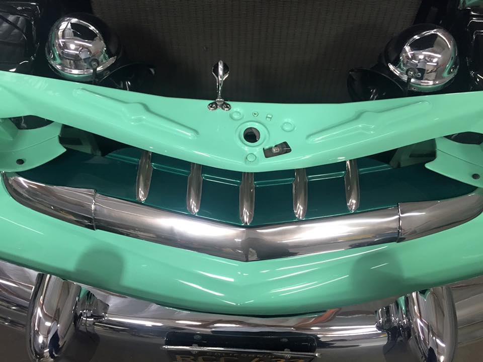

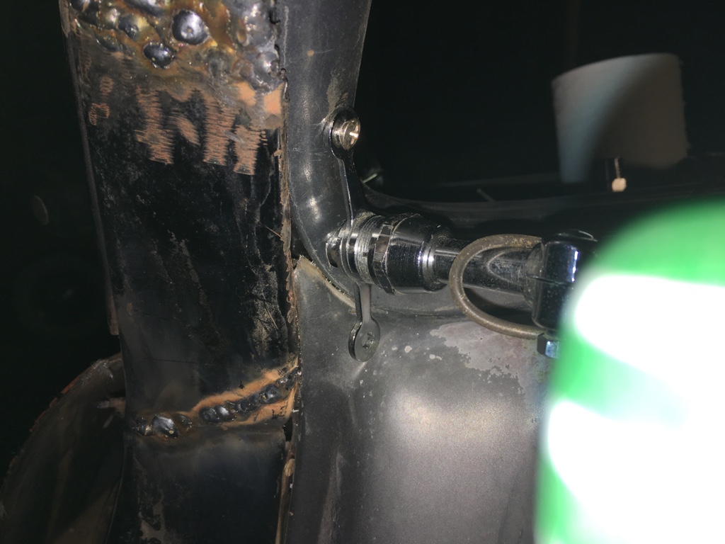

    Here is the safety latch slipped in from behind. It looks correct beside 2 holes and washers. [​IMG][​IMG][​IMG][​IMG]
    And set in with the hood closed. [​IMG][​IMG]
    To chop,or not to chop. That is the question.
    drdave likes this.
  3. Kustomkid
    Joined: Nov 21, 2010
    Posts: 531
    Kustomkid
    from Montana

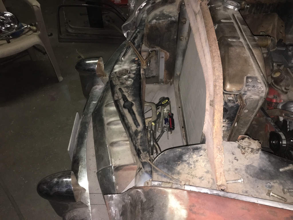

    One safety latch installed. [​IMG]
    Squablow and drdave like this.
  4. drdave
    Joined: Jan 3, 2006
    Posts: 5,366
    drdave
    Excellent!! I'll be stealing that idear since I'm essentially building the same front end. [emoji6]

  5. Kustomkid
    Posts: 531
    Kustomkid
    from Montana

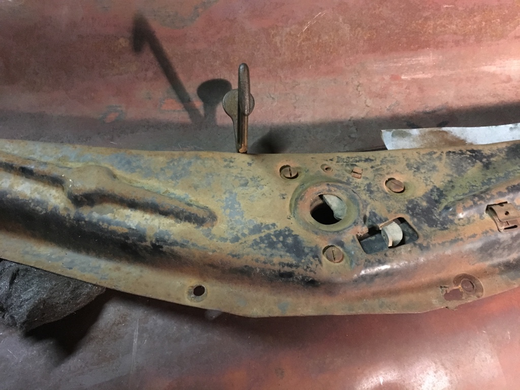

    Steal away[emoji106]! I'm thinking that the mount you see on top of the hood latch on the hirohata is a spacer that is pushing the latch back alittle so you can close the hood without touching the safety latch. Right now as mounted, it sits under the hood and won't allow it to close. [​IMG]
    drdave likes this.

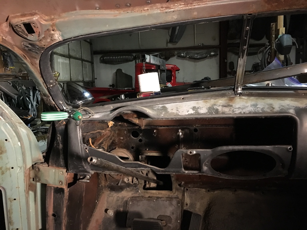

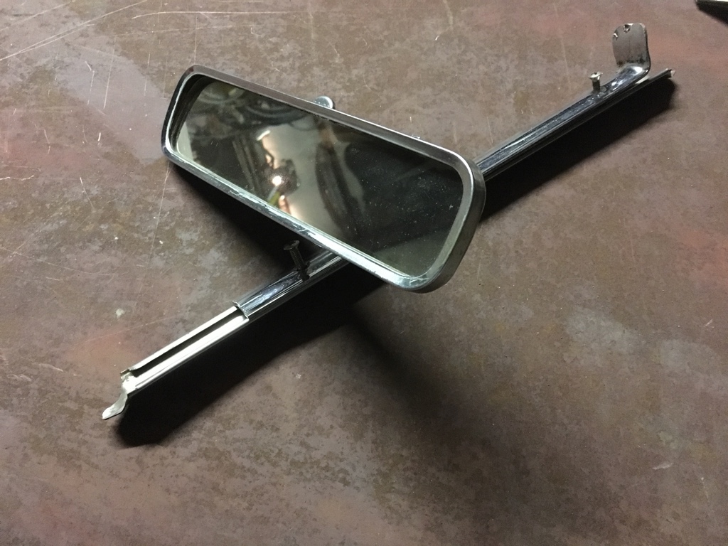

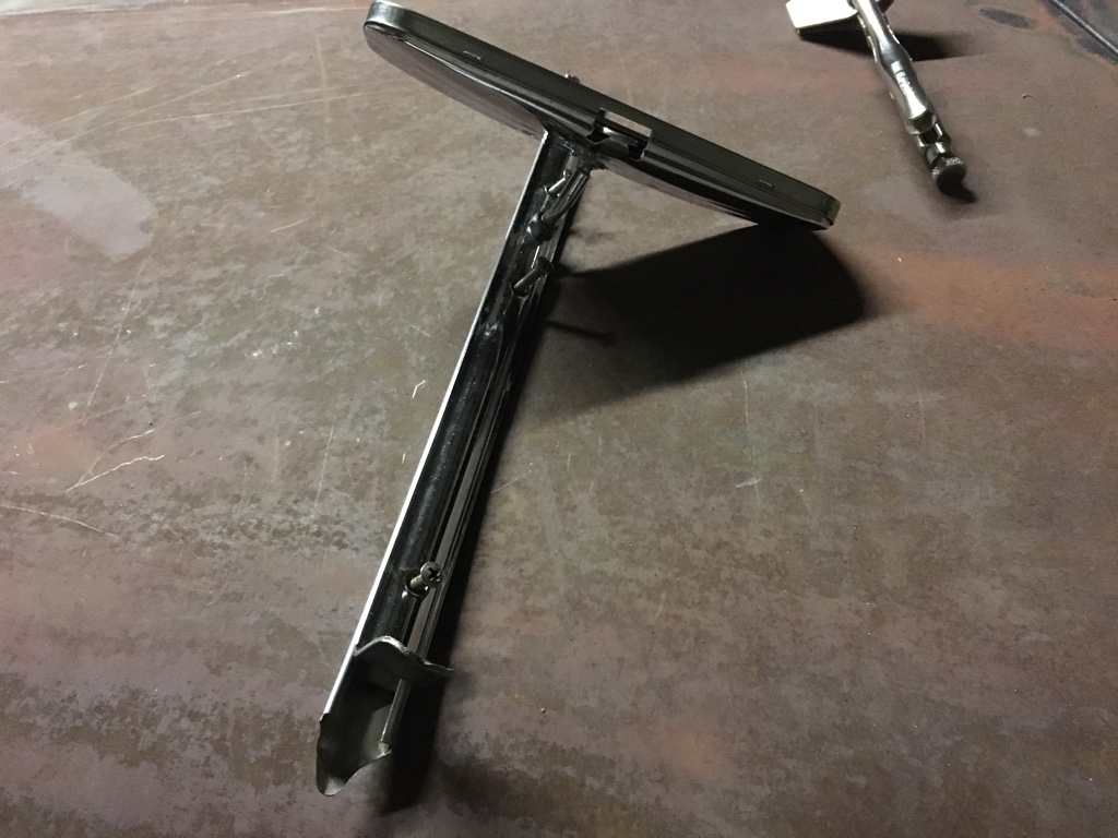

  6. Kustomkid
    Posts: 531
    Kustomkid
    from Montana

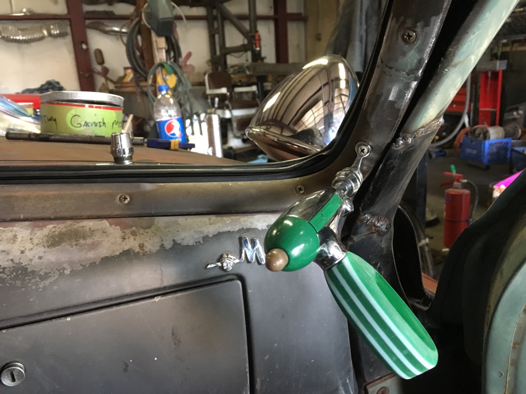

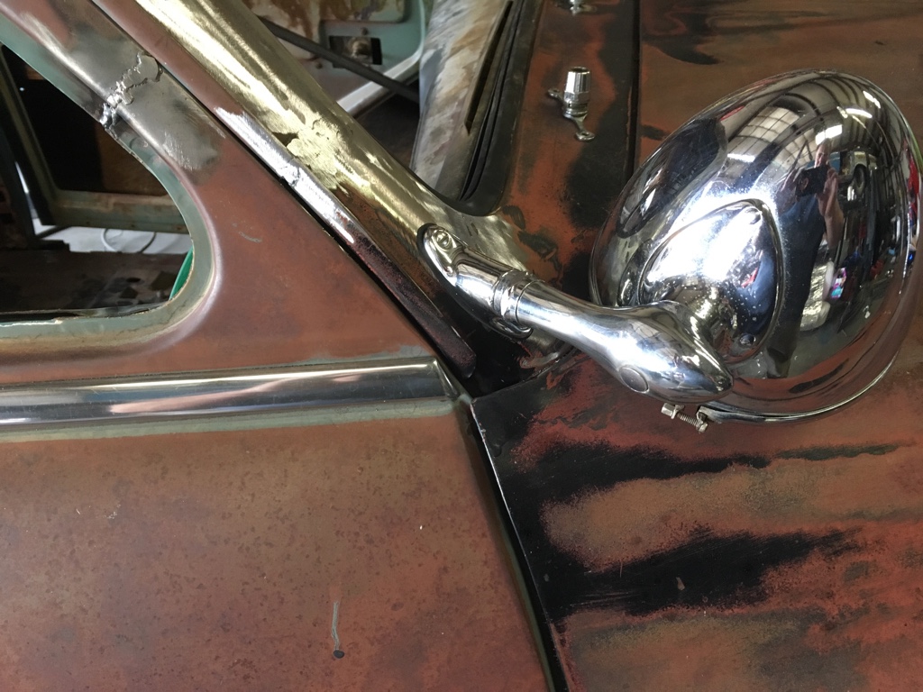

    Got alittle more done for the windshield. The center divider is chopped and a new hole drilled for the mirror. End up going with a 53 Pontiac mirror since it had a longer threaded arm that was angled. May be able to test fit the windshield this weekend. [​IMG][​IMG][​IMG][​IMG]
    drdave and Squablow like this.

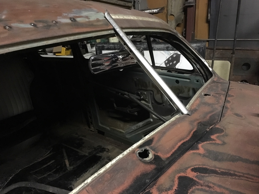

  7. Kustomkid
    Posts: 531
    Kustomkid
    from Montana

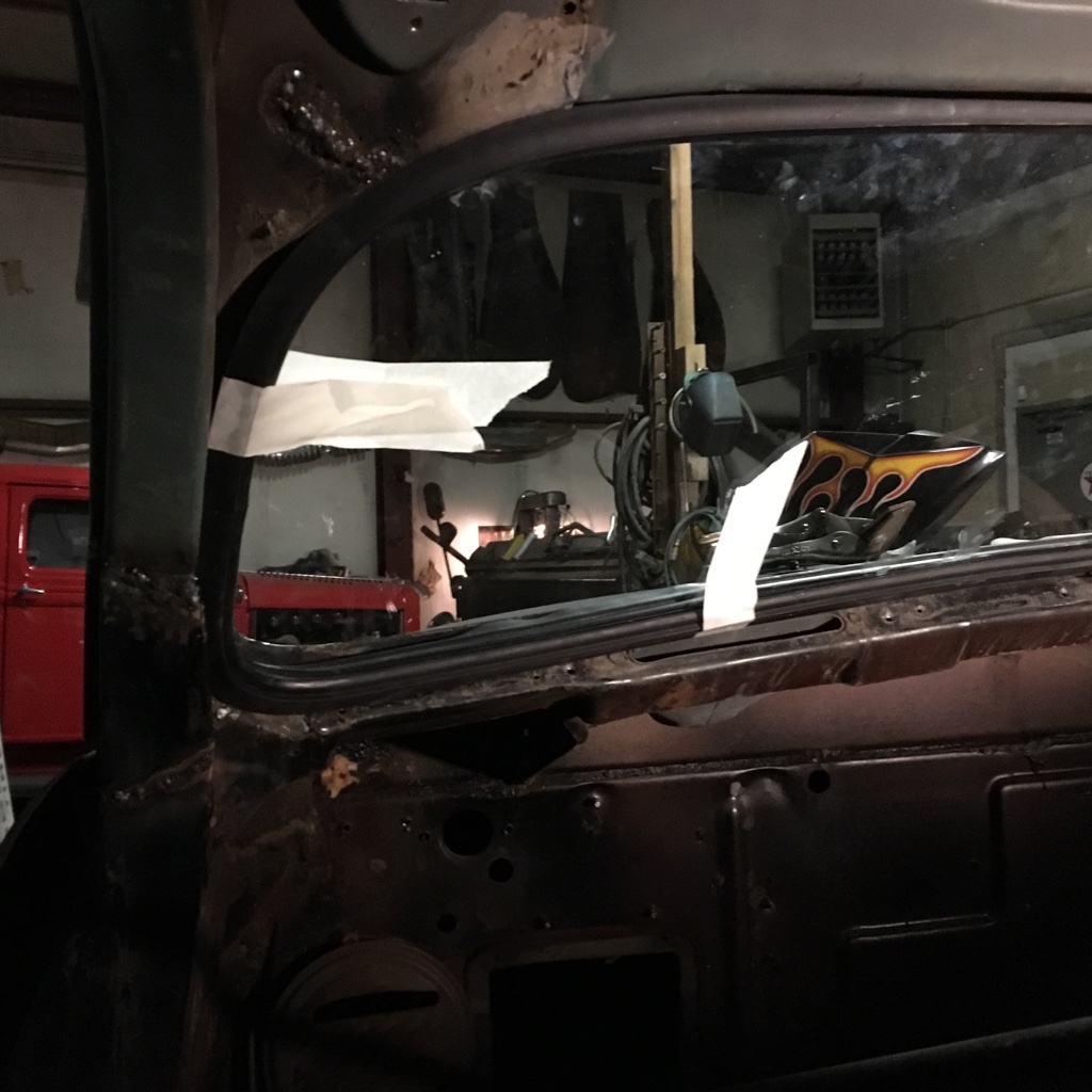

    Got the windshield half installed. I used an original piece of gl*** to make the pattern. It seems that I'm about 1/4 off on the width to get the sides of the seal in. But I'm on the right track![​IMG][​IMG][​IMG]

    The windshield was so tight that I ended up breaking one side trying to get it out. Oops

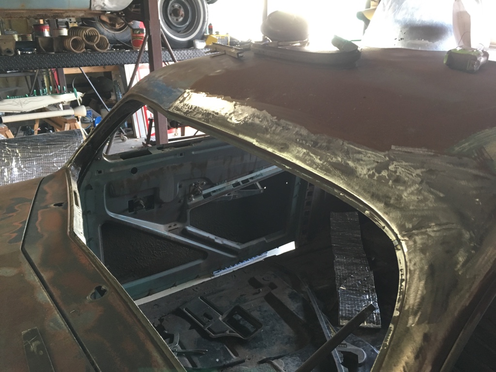

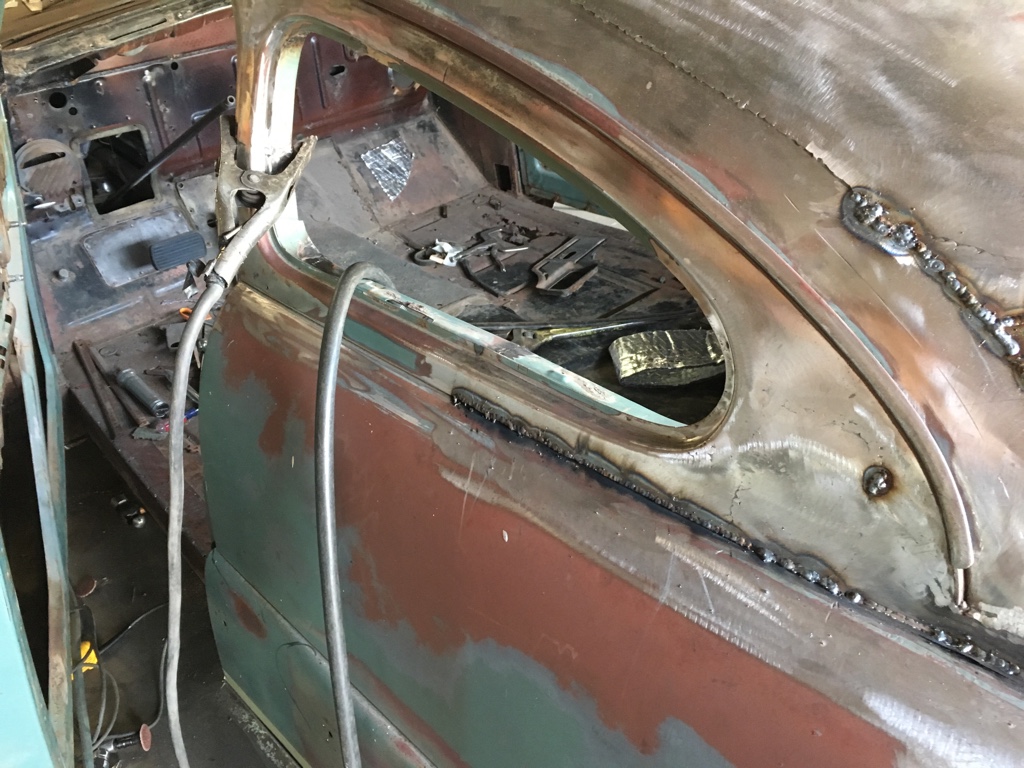

    I got to spend the afternoon welding and got most of the driver side welded up along with the holes for the tack strip along the windshield. [​IMG][​IMG][​IMG][​IMG][​IMG][​IMG][​IMG]

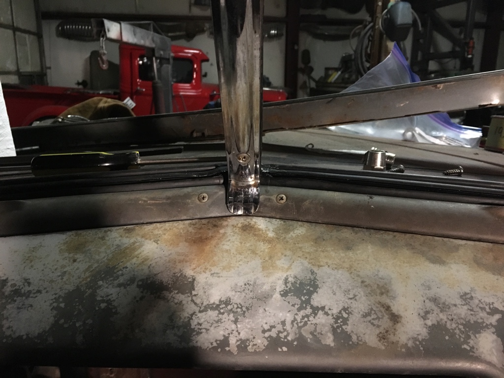

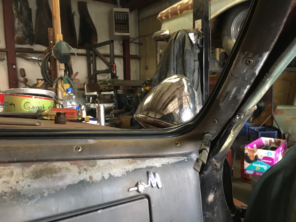

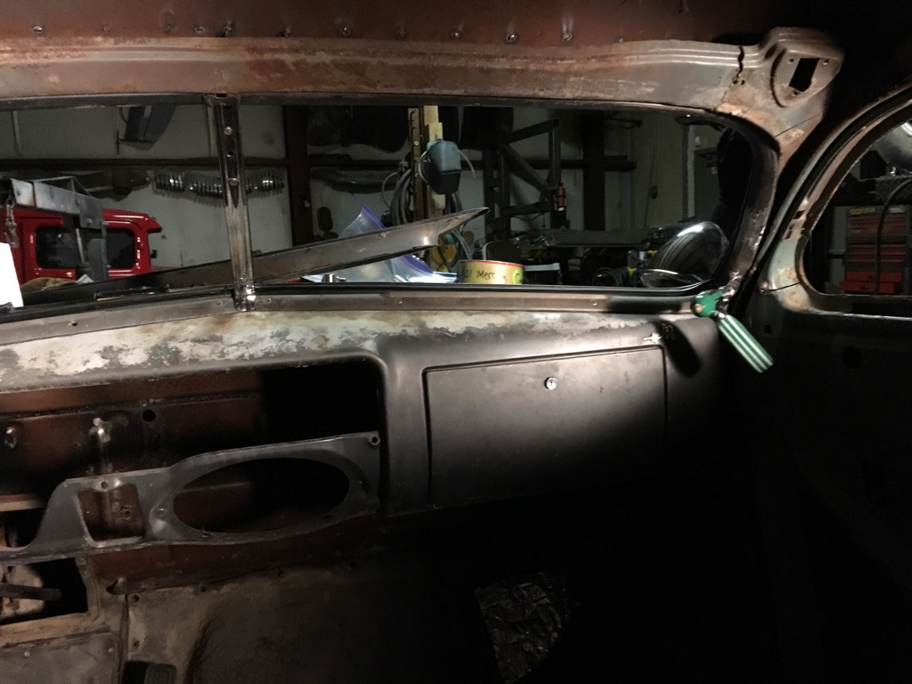

    I got the old dashboard in and the windshield gasket and got the p***enger side Garnish molding installed. The spotlight seems to be coming out in the correct spot. Now the driver side....[​IMG][​IMG][​IMG]
    I'm really happy that the L995 and L994 worked out since they are a door mount for a 49-52 Pontiac, Cadillac, Oldsmobile. [​IMG][​IMG]

    Man, did you hit that right on the money so the clamping bracket hits right on the garnish screw?! Wish you would have drilled mine! [emoji6] That's right about where mine come through though, so I might be close, too, I just haven't tried the clamps yet. The arms on all mine are 180 degrees apart and it looks like they could twist closer or further apart to line up better with the dash and the garnish before the final bending. I don't really know anything about them so don't know if they are really supposed to twist like that or not, but none of mine do. Do yours?

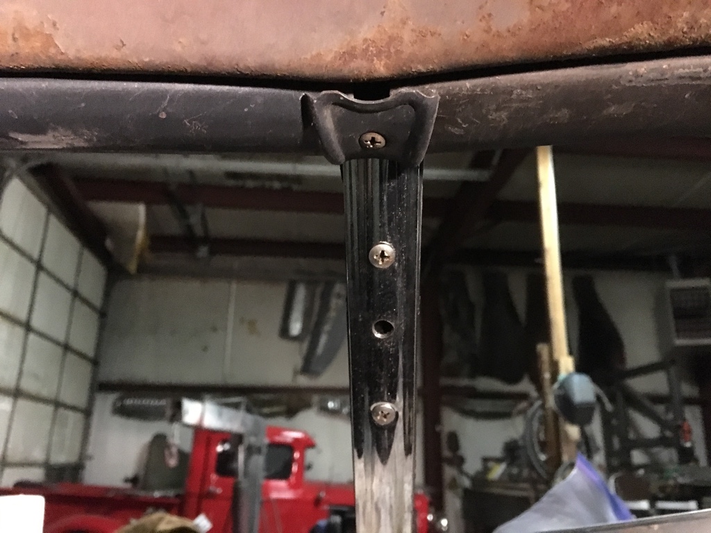

    I'm pretty sure the clamps are supposed to be twisted and bent to fit the garnish molding. I've got to sets of the clamps. One pair is longer and the other is shorter.[​IMG][​IMG][​IMG]
    The short one is lining up with the Garnish molding screw and the longer one is over it. Got to try and spin them cause the bottom mount hit the top of the dash.

    Yup[​IMG]

    And the driver side Garnish molding is fit, got the hole drilled for the spotlight [​IMG][​IMG][​IMG]
    Finish up some welding and grinding and the windshield is done![​IMG][​IMG][​IMG][​IMG]

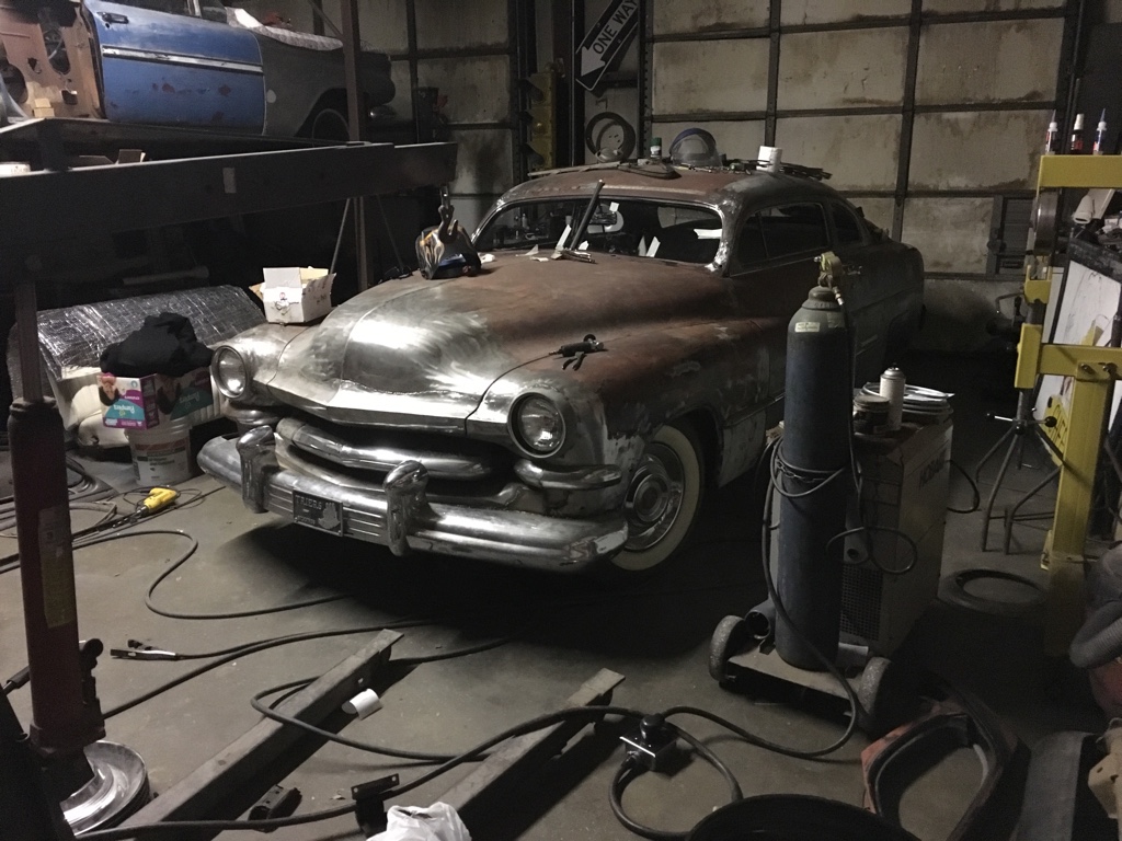

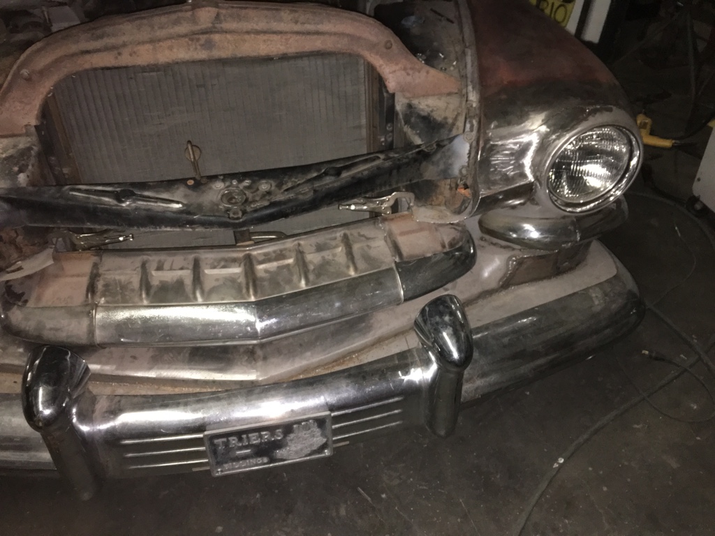

  19. Kustomkid
    Posts: 531
    Kustomkid
    from Montana

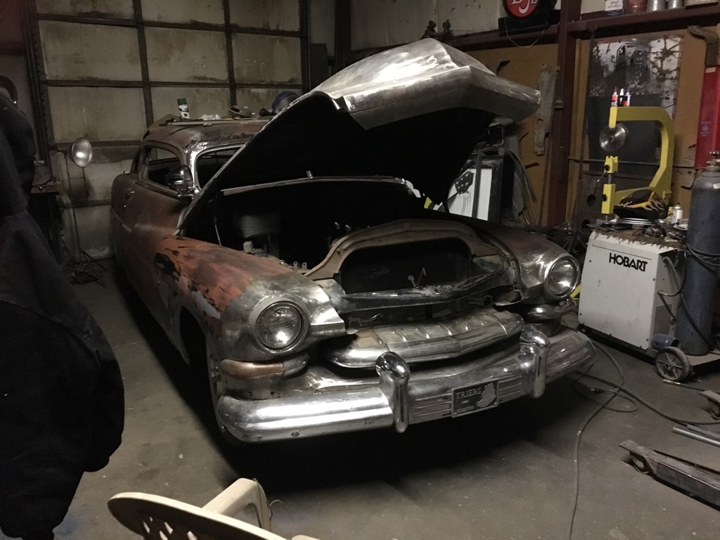

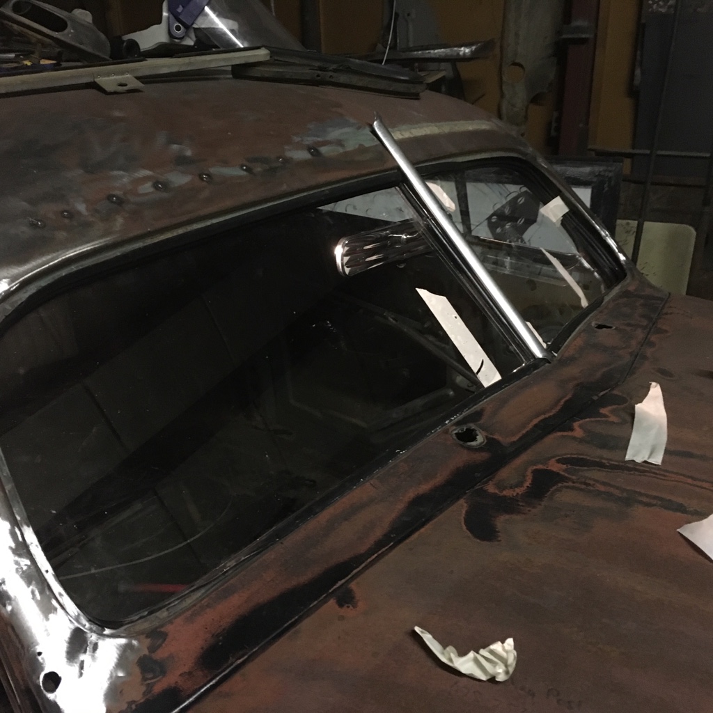

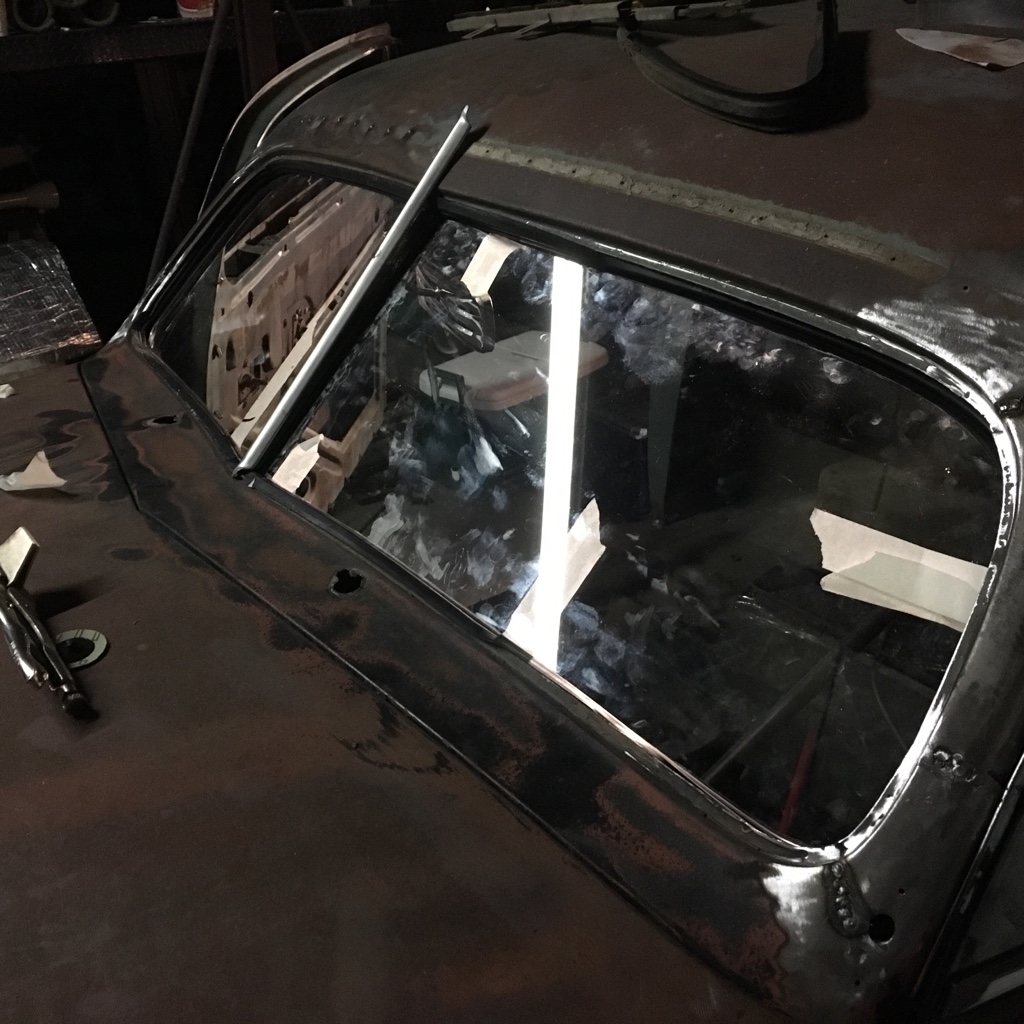

    Started fitting the windshield stainless [​IMG]
    And took some pics of the front end with the spot installed. [​IMG][​IMG][​IMG][​IMG][​IMG]
    To chop, or not to chop. That is the question.

    Got alittle more welding done and started thinking about Rear belting trim. Thinking of shorting the Rear trim since the back window is low and the stainless low. I think it will look alright with the short side trim. [​IMG][​IMG]

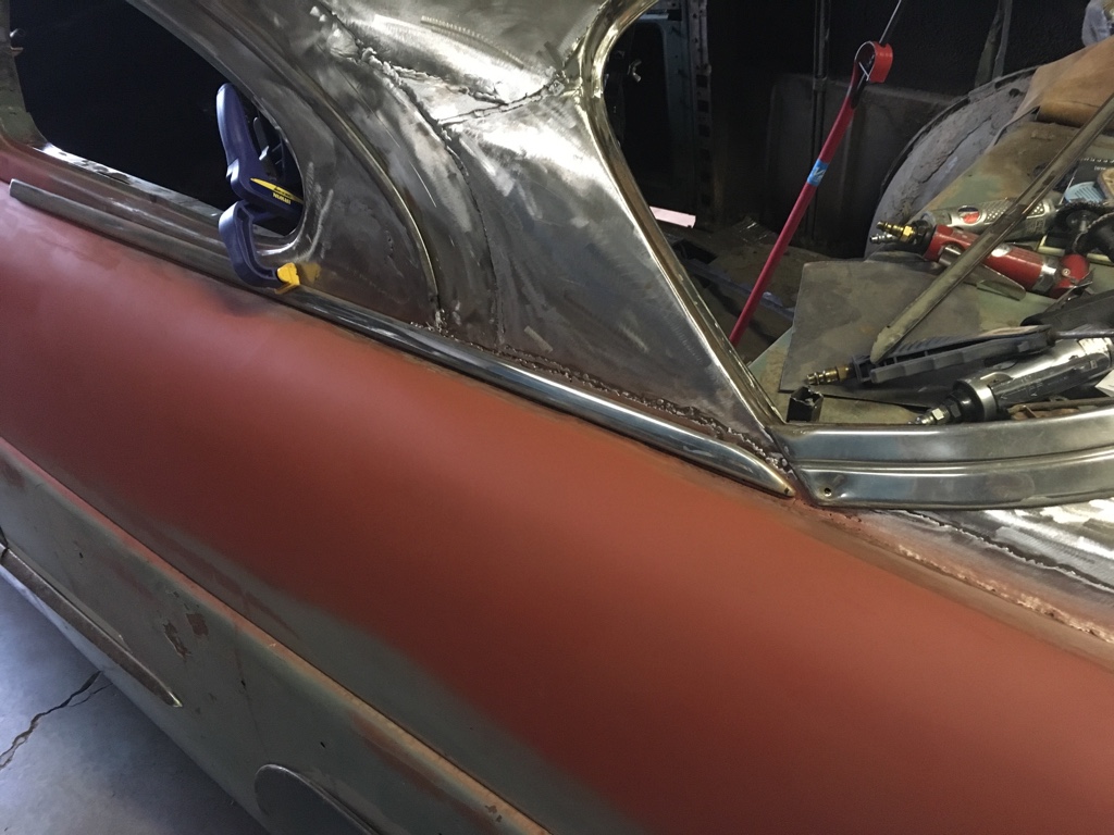

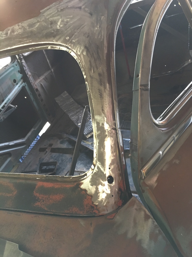

  24. Kustomkid
    Posts: 531
    Kustomkid
    from Montana

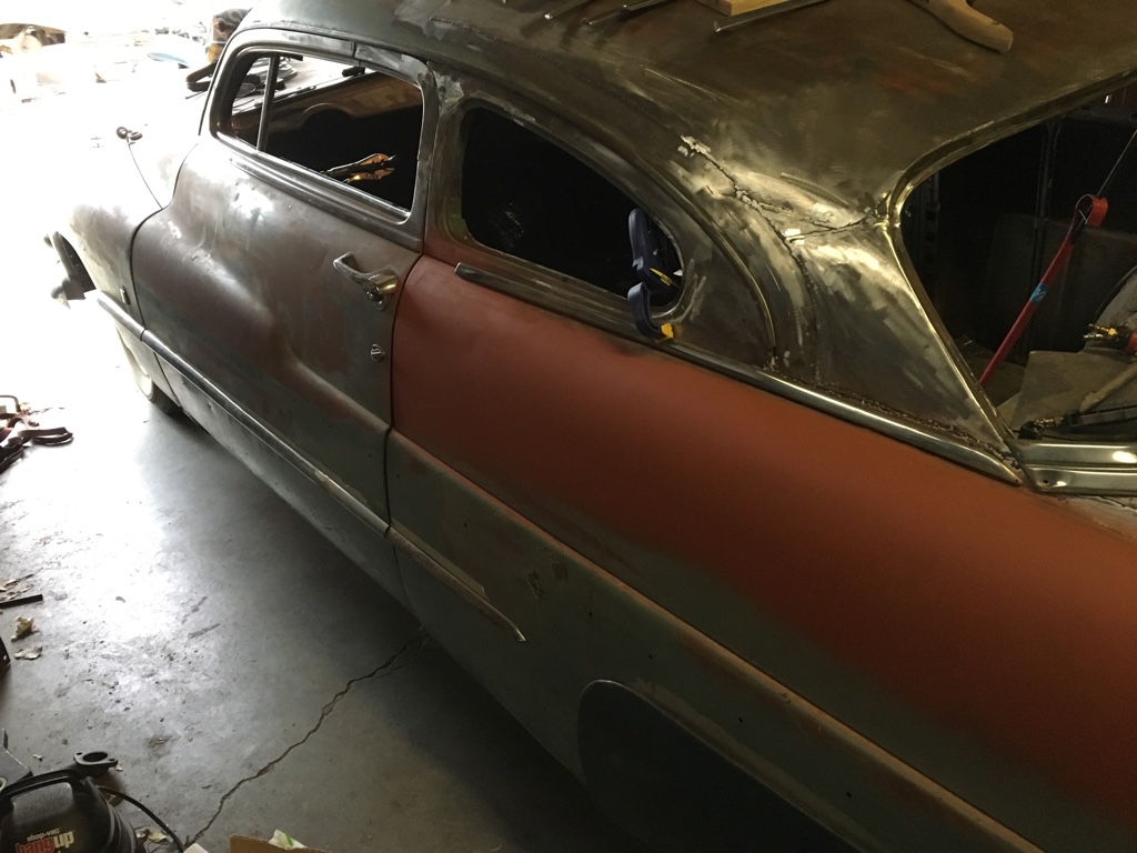

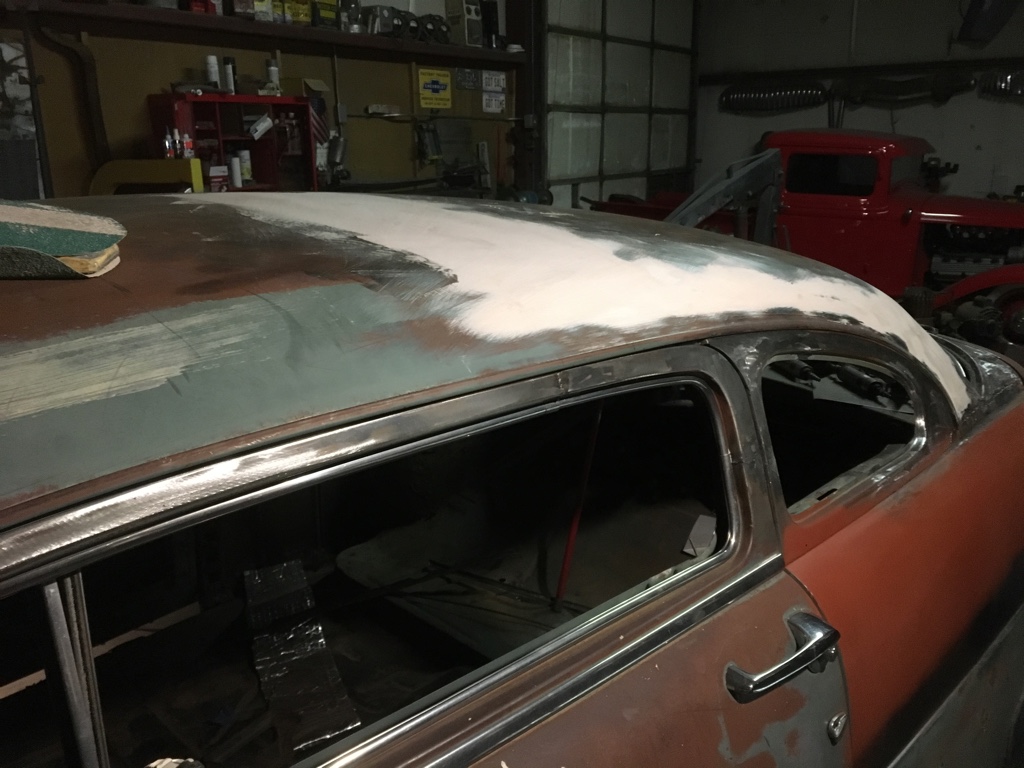

    Drivers side of the chop is done! Now p***enger side. [​IMG][​IMG][​IMG]
    And alittle plastic filler. Would like to have done some lead work, but that's a lot of heat with never doing it before. [​IMG][​IMG]

    I'm using my 4 foot trim to make the belt line trim, had the driver side welded up. Feeling really good about it and noticed I welded the same piece I cut back together and cut a filler piece out of the piece I was trying to use. Big dumb*** moment. [emoji849]

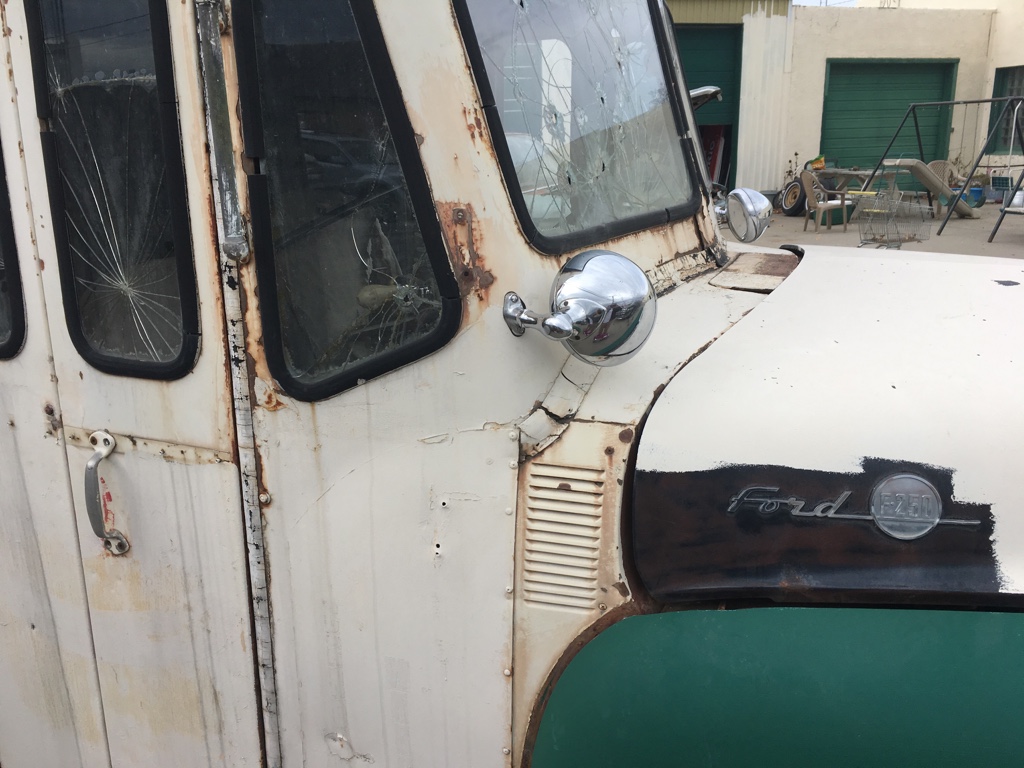

    Yeah trying to get rid of the excess Appleton parts I ended up with getting the 112s. End up with 3 112s and a pair of 551s. So my milk truck project got dual spots![​IMG][​IMG][​IMG]
