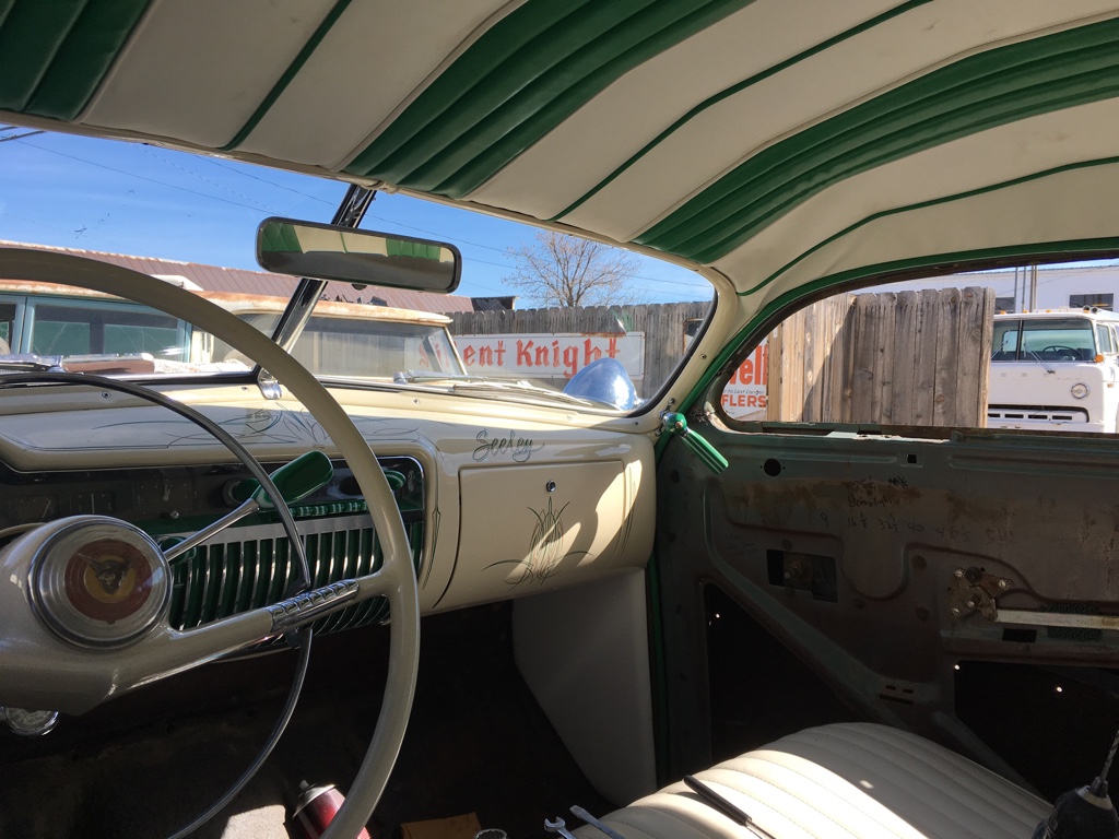

    It would be interesting to see what the Carson top shop did to install the headliners. The Hirohata's headliner is perfectly installed and there has to be something else in there besides the headliner bows. [​IMG][​IMG][​IMG]

    Yes, they do, but they don't have as much of an angle to them as the old ones Appleton had on their spec list to fit the Merc specifically. So, while the new ones can be trimmed to fit, there is sometimes not enough meat on them to get the shafts closer to parallel with the ground.
    No worries on the gaskets. I actually already have a set of those brackets with new gaskets mounted on the car, so I can use those gaskets for patterns.
    I have often thought the same thing about the Hirohata headliner. I would pay at least a dollar to see what's behind it. ;) I have kept my eyes peeled at for pics of old headliners like that and the supporting structure in restoration pics of of older customs. I thought I might get lucky with when Palle took apart the Jack Stewart Ford, but I gleaned precious little from that. Best I've come across yet is the Custom Rodder article from the 90's (?) when the shop did the pleated headliner in the Zaro '40 Merc. They used bent conduits front to back with tack strips on them in line with seams and just stapled the seam allowance right to the tack strips.

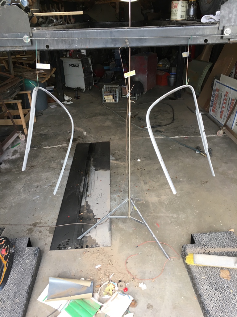

    The windshield garnish moldings are painted. Should be able to install them tomorrow and get the spots ***embled. [​IMG][​IMG][​IMG][​IMG]

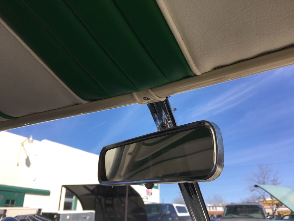

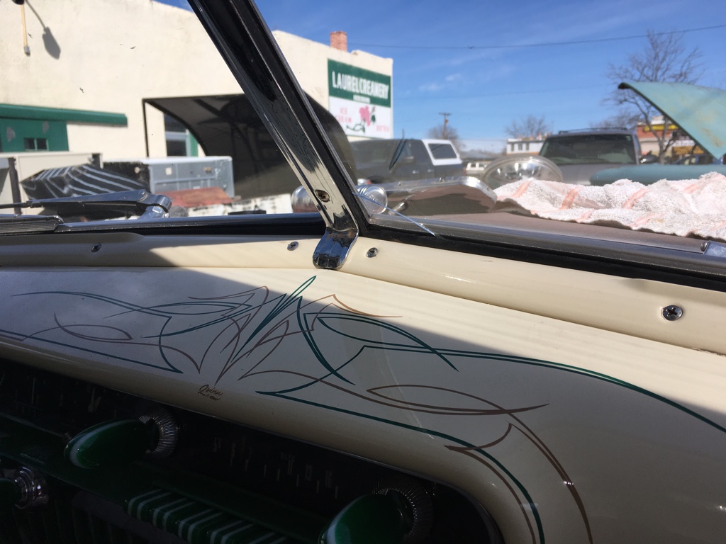

    Garnish molding for the windshield is in. Holes seem to move now that the headliner is in! Spotlights are ***embled, got to see what I need to do on the p***enger side Handle to get it rotated up. [​IMG][​IMG][​IMG][​IMG]

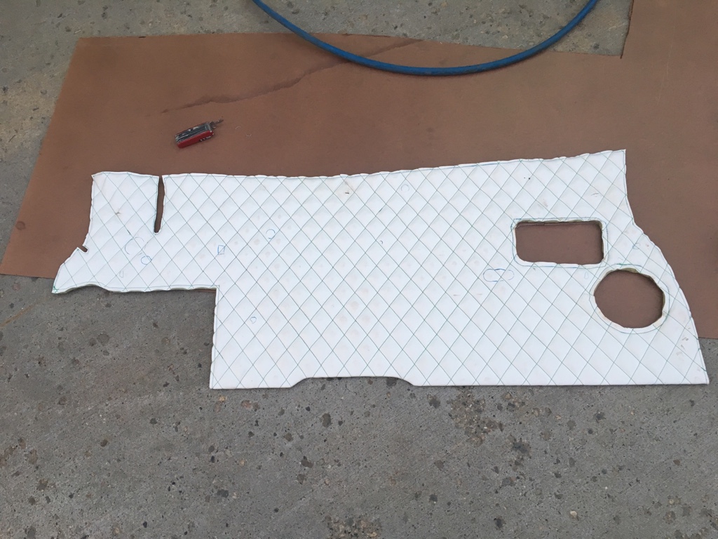

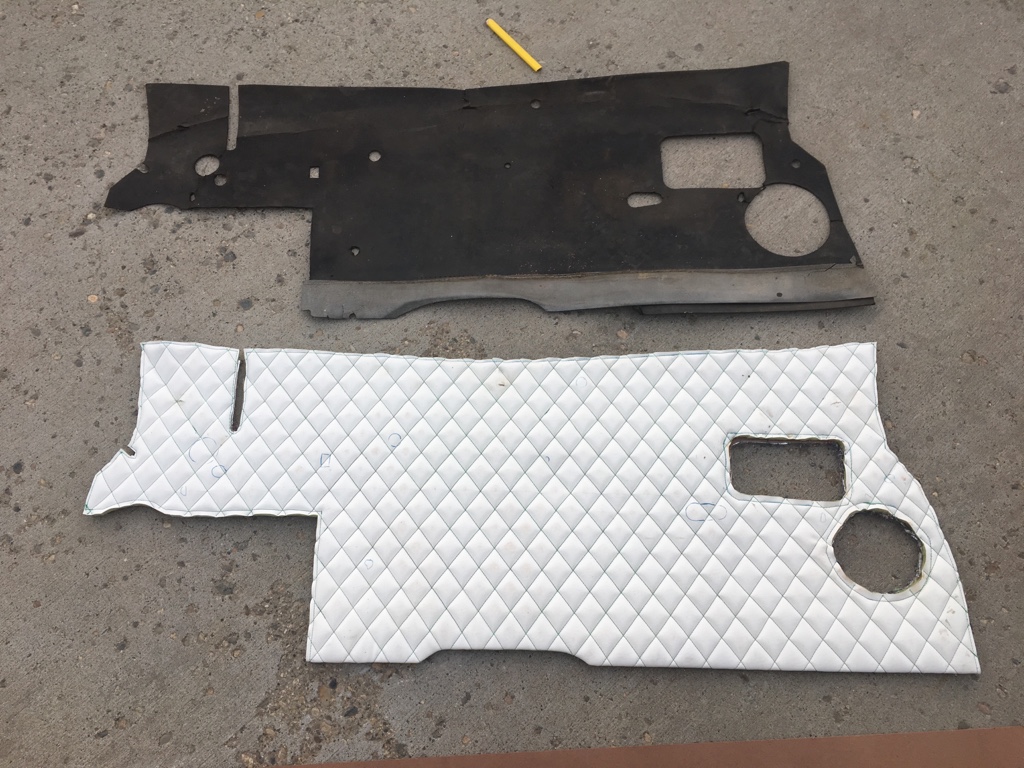

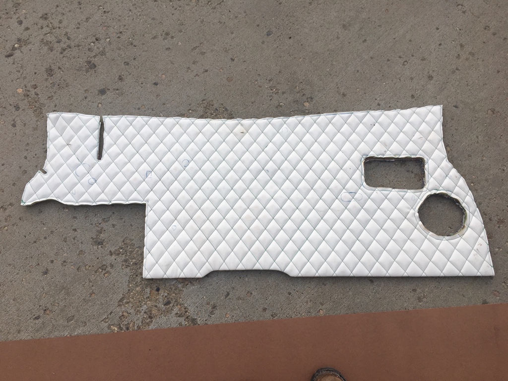

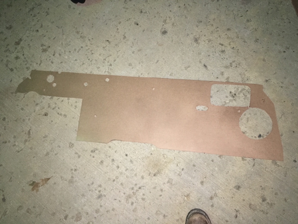

    Done for tonight. I should have the firewall pad sorted out tomorrow. I think I squeaked by on the length and can get it folded, glued and stapled to my board. [​IMG]
    It looks like the rearend won't be set up this week. [emoji17] But s***ching up some more tuck & roll for door panels and firing up the motor. May be a good next weekend.

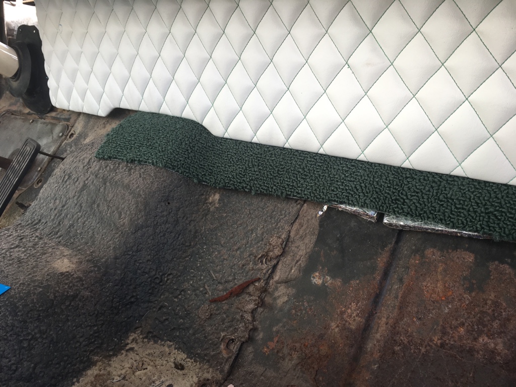

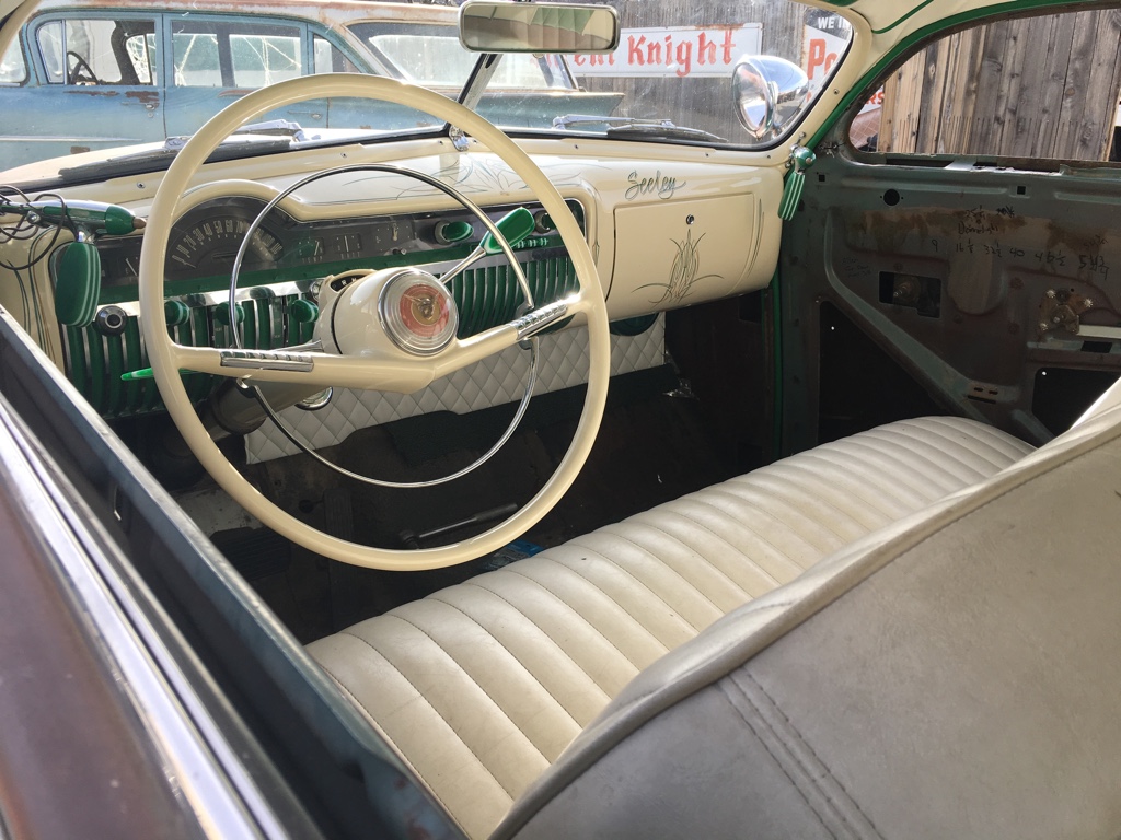

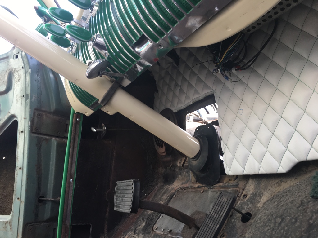

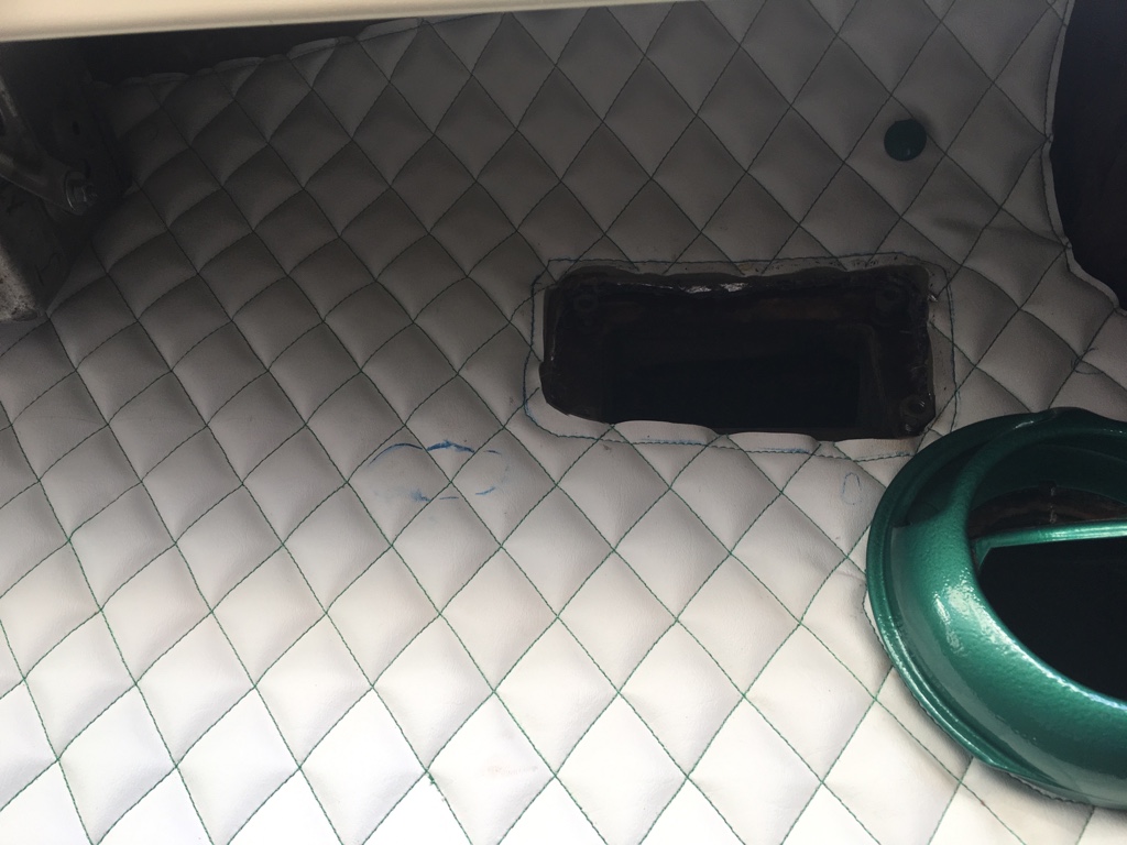

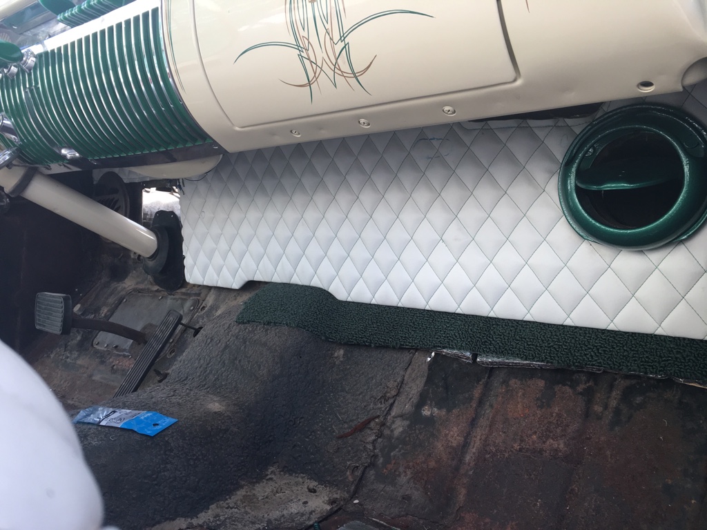

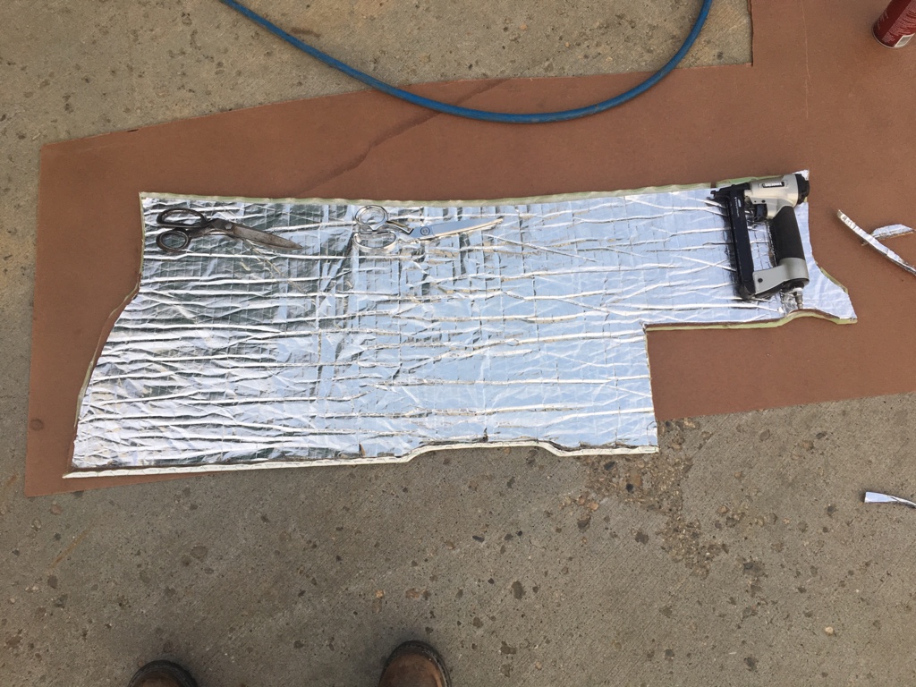

    Got the firewall pad in. Looks like it going to fit. A double layer of insulation on The toe boards should allow the carpet to fit nicely behind the board. [​IMG][​IMG][​IMG][​IMG]
    I put the heater box in. I'm not sure if I like the hammer green on the heater or if it should be hammer grey. [​IMG][​IMG][​IMG]

    I like the green....unless you want to chrome it. [emoji6]

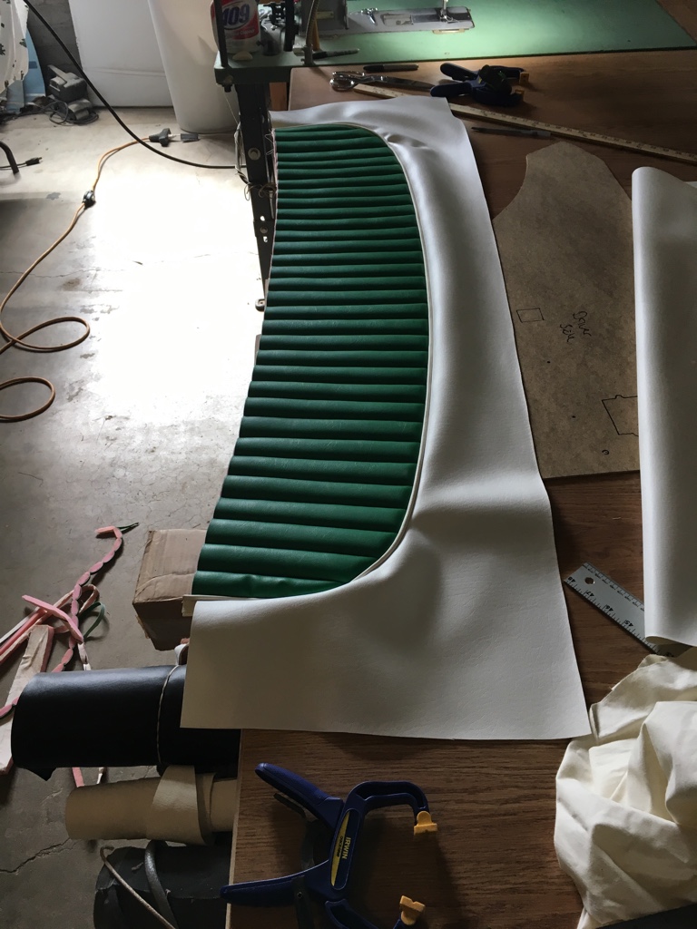

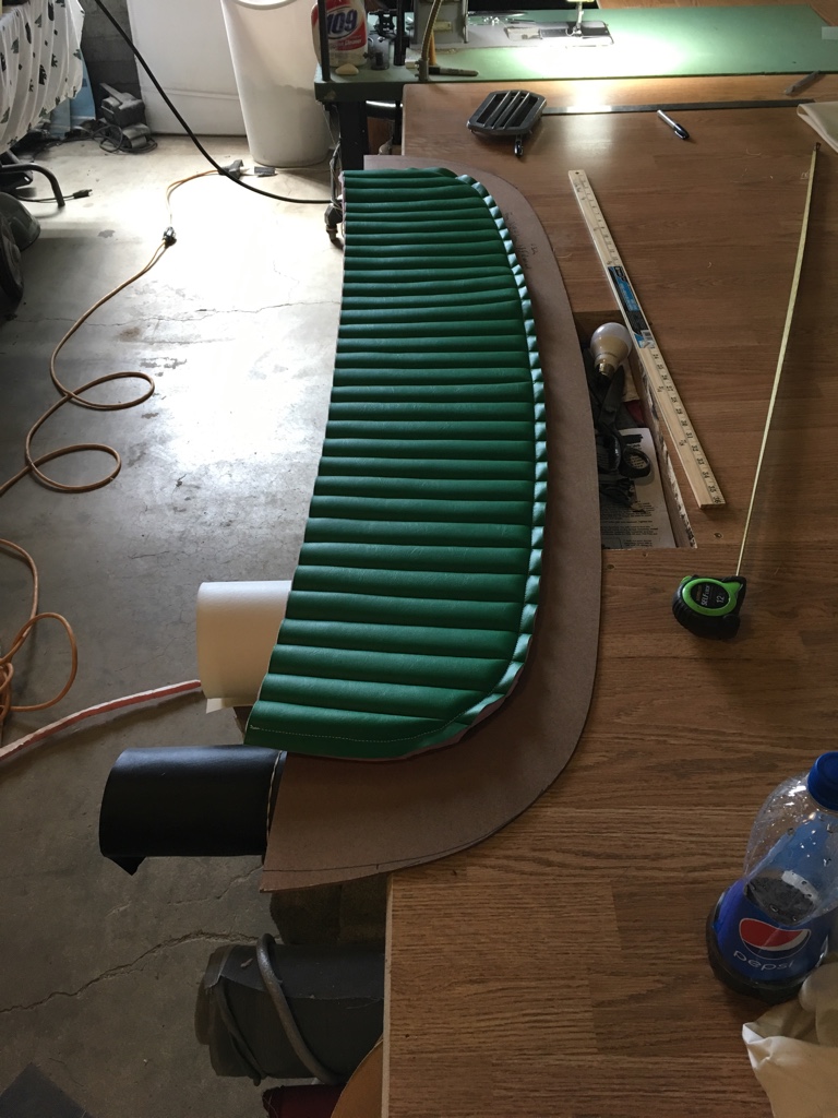

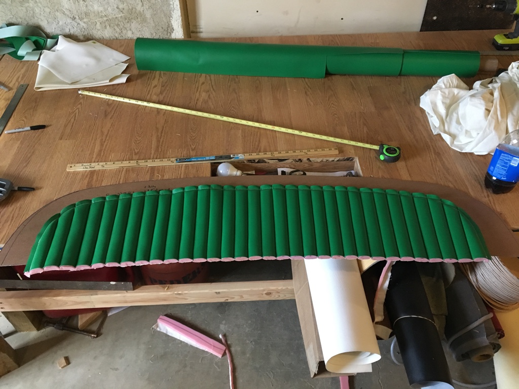

    Got the foam and the green all layed out for the package tray to start sewing tomorrow. Might be able to get all the green done for the door panels this week.
