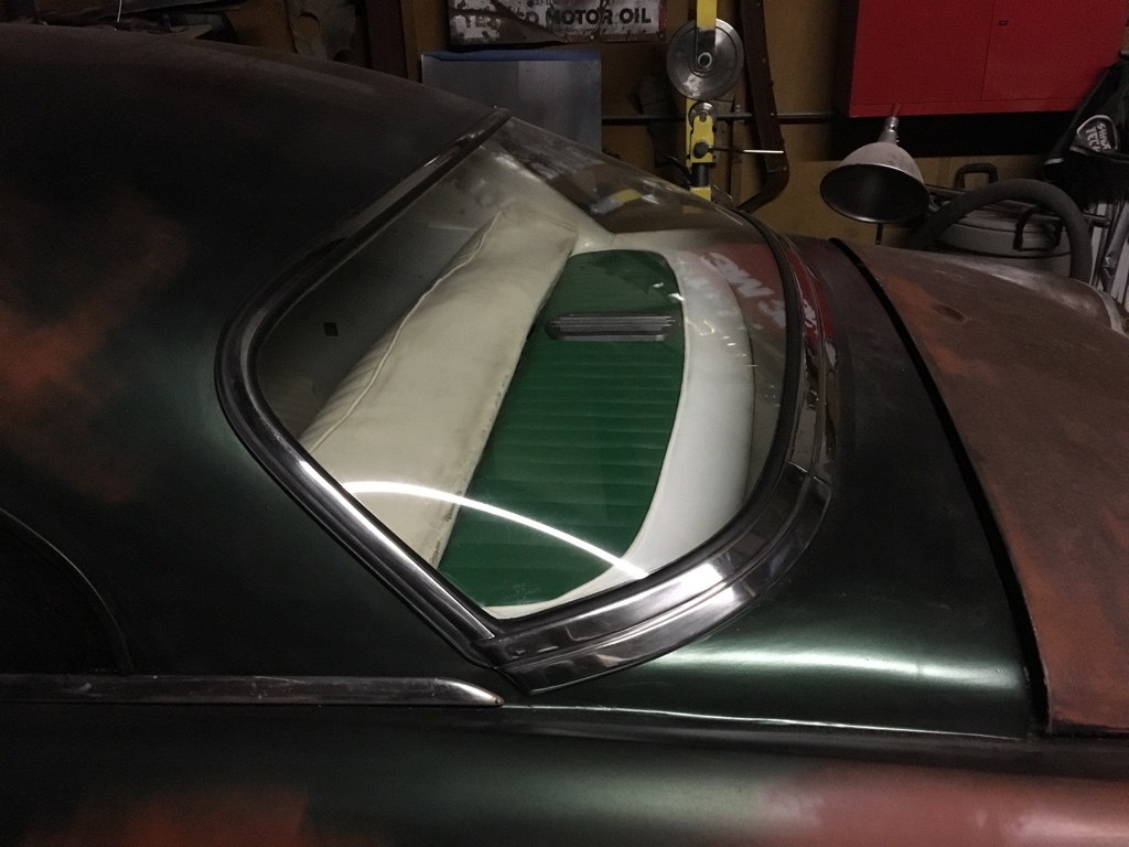

    Package tray is together. [​IMG]
    And in.
    The green should help with the glare on the rear window. The old car had a white package tray and was hard to see out of in the afternoon.

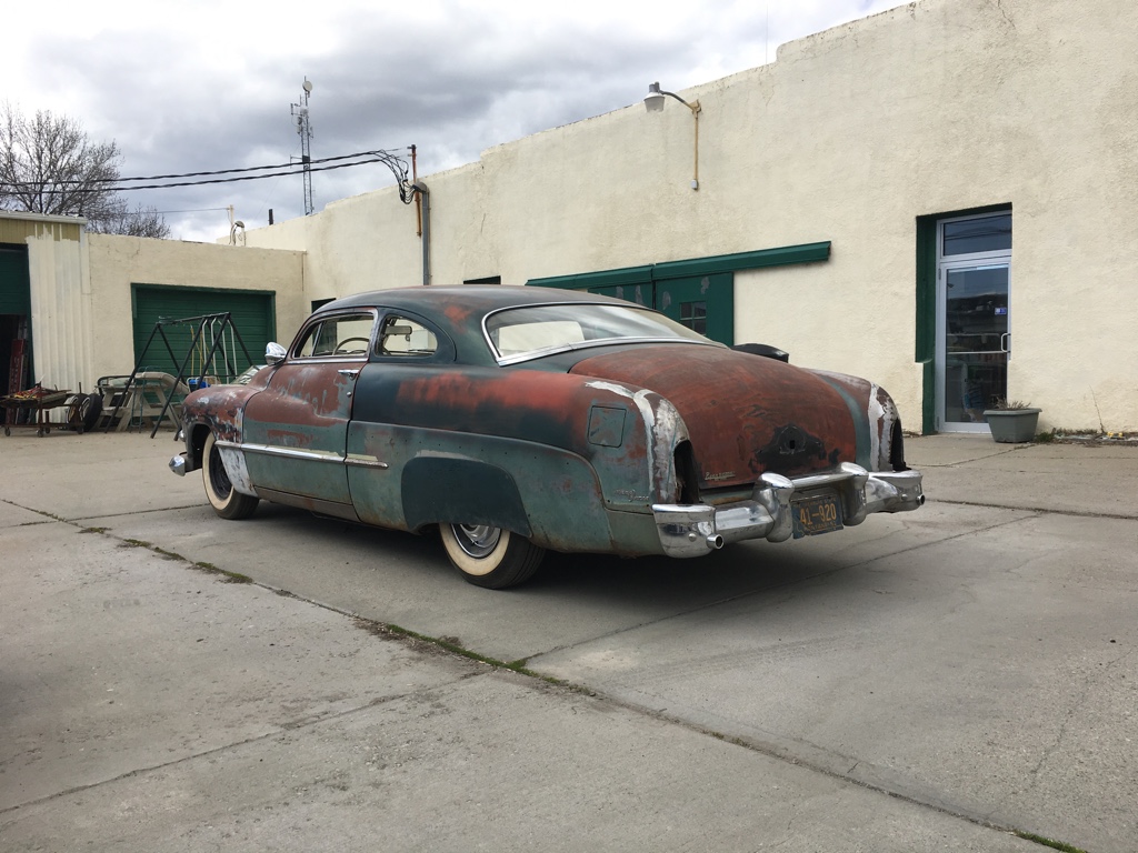

    Put a pic of the complete car as it is now. Haven't seen the out side progress for awhile

  4. Kustomkid

  5. ROBERT JAM
    Joined: Nov 13, 2002
    Posts: 1,286
    ROBERT JAM
    Dang that's looking good! Glad to see it coming along so well

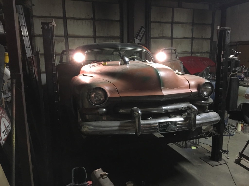

    Got the merc out and up on the lift to ****on up the exhaust and get the gas line and transmission mount finished. May be able to started it soon. [​IMG][​IMG][​IMG][​IMG]

    Got the spotlights working tonight, found some 12 volt light bulbs that work in the 112's reflectors. Spent half the night trying to make them light and finally dawned on me that the bulbs mount is in the wrong place. Blobbed on some solder and presto, light. [​IMG][​IMG][​IMG]

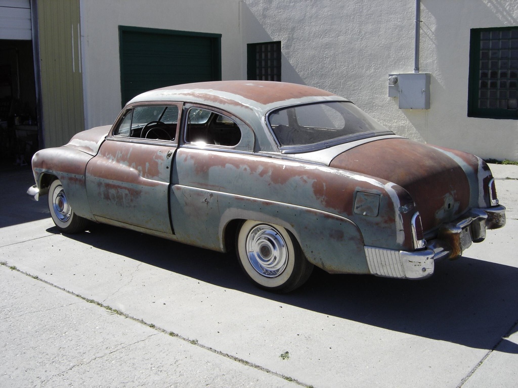

    The engine is timed and tuned. Having problems with the old starter but it's running good. Valves were way off but not bad for a 61 year old engine. Now a drive shaft and a rearend.....[​IMG]
    And here is a before shot. [​IMG]

    Found another pic of my first merc at the 99 Go show. Got best unfinished. [​IMG]

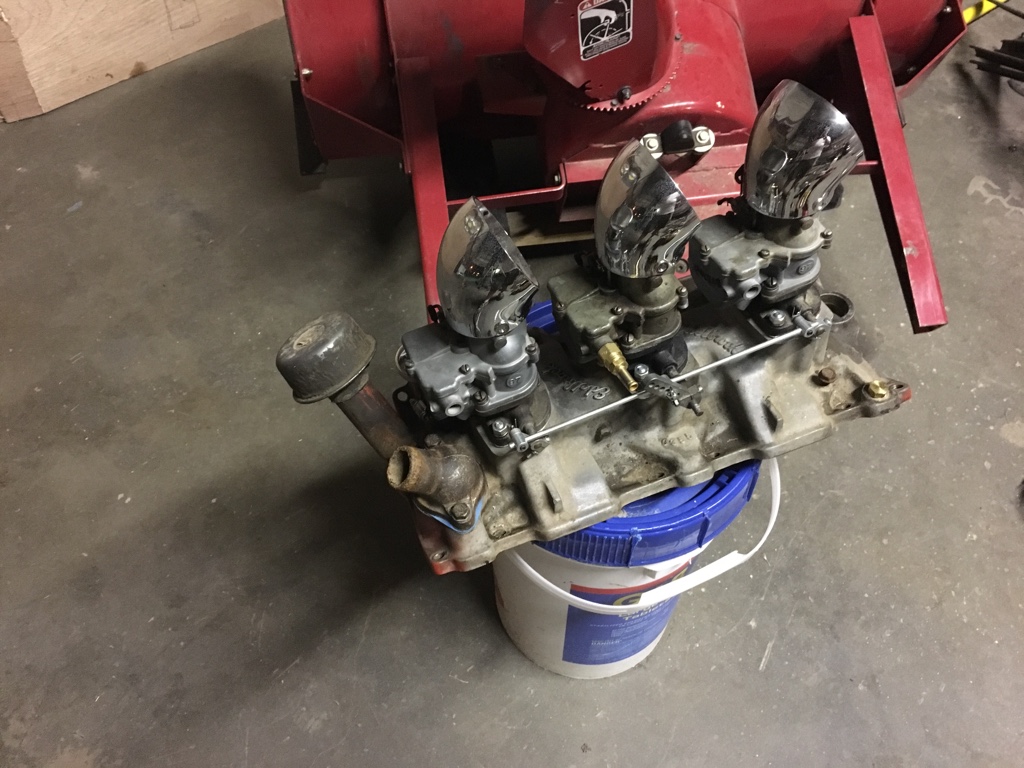

    from Montana
    Burning the midnight oil tonight. Got the intake back off again, having problems getting the intake to seal and not leak water. Drained the oil and had about a gallon of water in it. Am I missing something with the 265's with the C-355 edelbrock intake? Got 265 gaskets but still leaking. [​IMG][​IMG]
