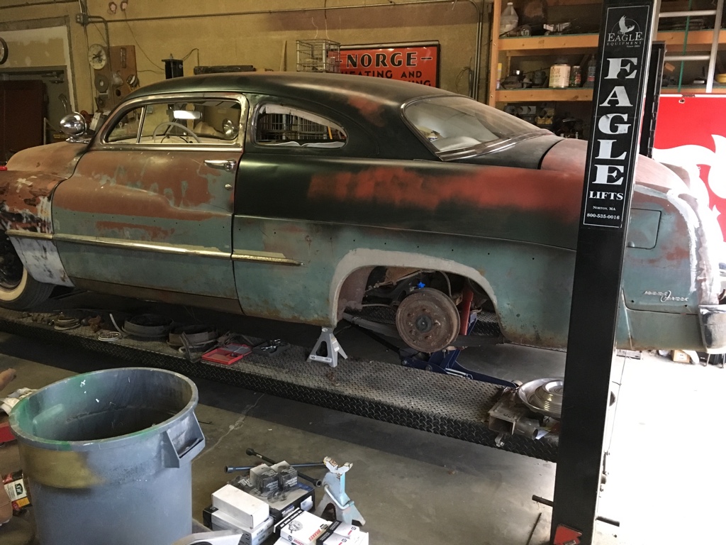

    The new rearend is in! Once the kids go to bed tonight, I'm going to get the rear brakes installed. [​IMG]

    Rear brakes are done, tightened and rolling. Tomorrow will be the front brakes and bleeding. Radiator is still full of water so that's good. Got to tear the back of the transmission apart to see why the yoke won't slide in all the way, but should be able to get a measurement for the drive shaft and get that ordered on Monday. I think I might be able drive the car in a couple of weeks!!!

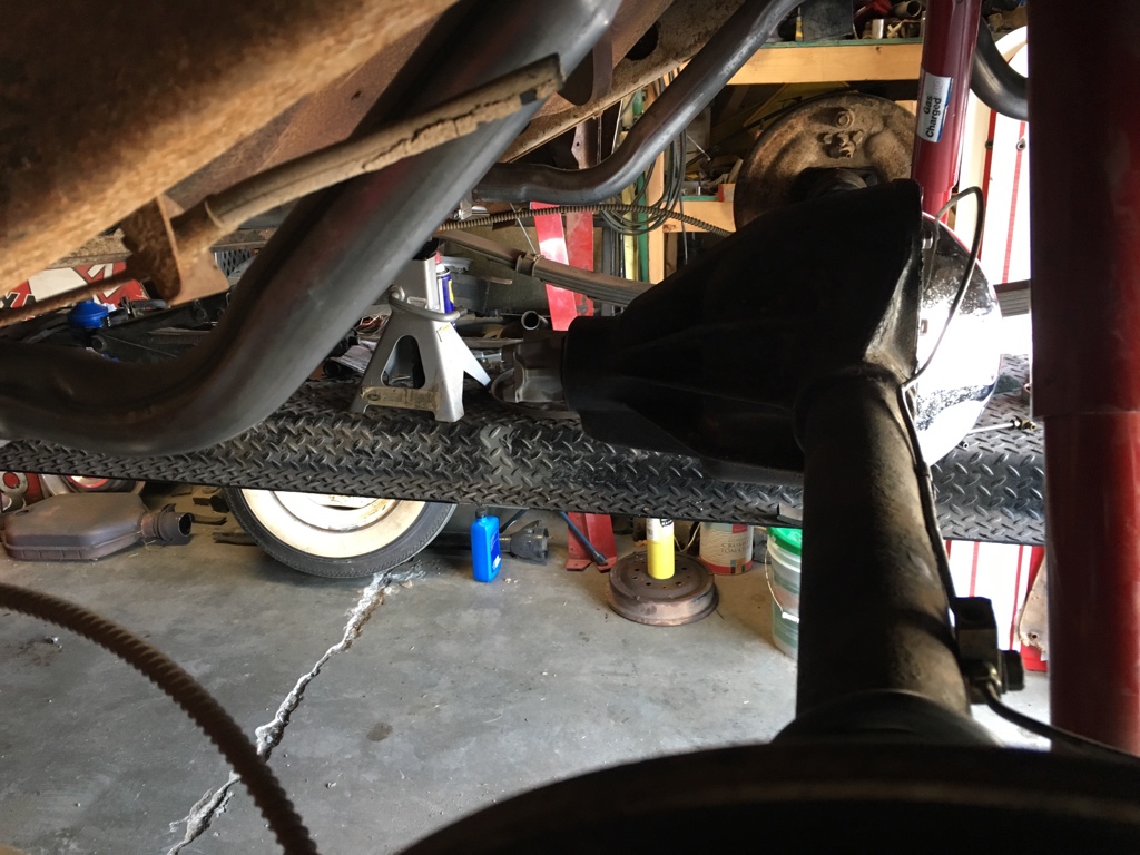

  14. Kustomkid
    Joined: Nov 21, 2010
    Posts: 531
    Kustomkid
    from Montana
    And the drive shaft is in. It's really nice not having to use a Mercury rear u joint. [​IMG][​IMG]

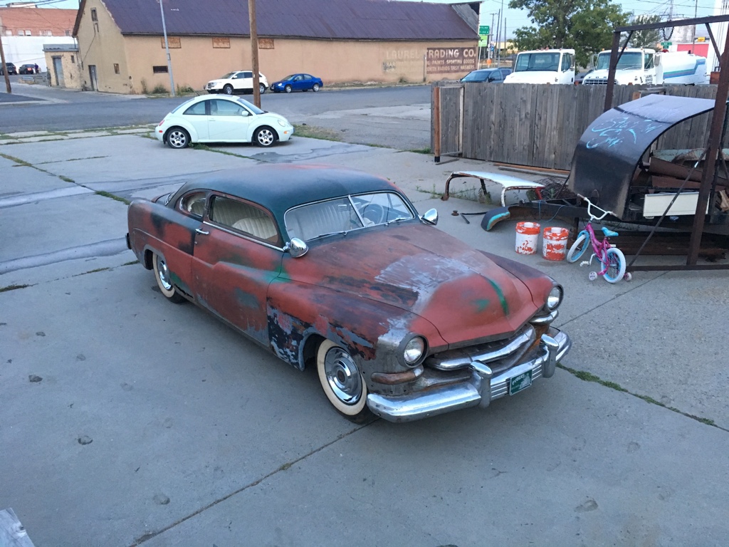

    Got first drive in around the parking lots. The powerglide has problems, I think it's the one I rebuilt in high school and it doesn't have reverse. But was nice to drive it. [​IMG][​IMG][​IMG]

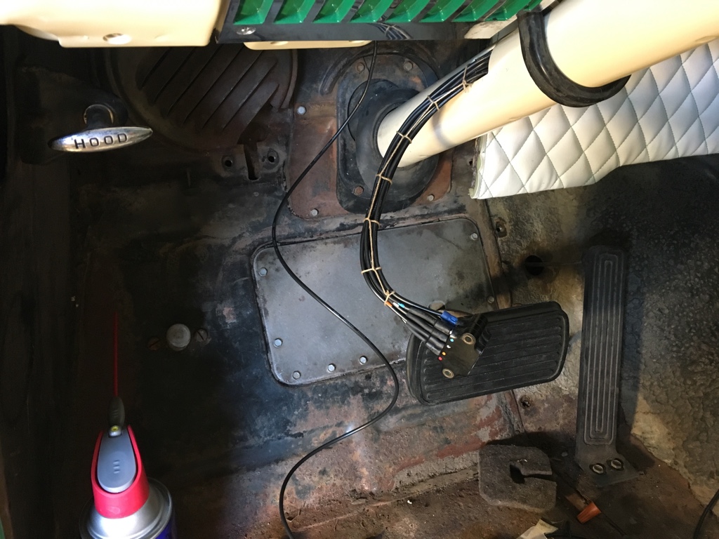

    Posts: 531
    Kustomkid
    from Montana

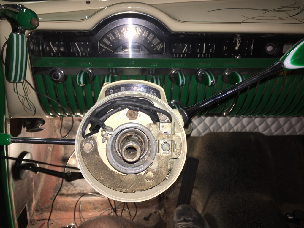

    Going to try and get the steering column all put together tonight. Got the turn signal switch rewired and ready to install. [​IMG][​IMG][​IMG]
    drdave and OG lil E like this.
  20. Kustomkid
    Posts: 531
    Kustomkid
    from Montana

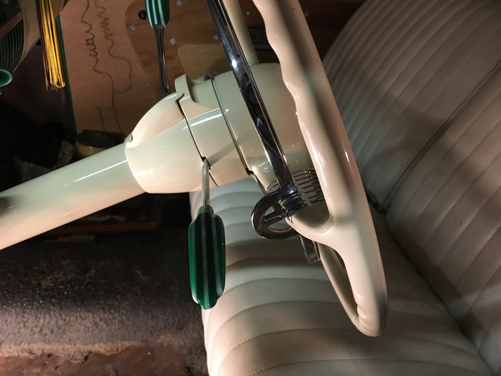

    Got the wiring through the steering column, went easier than Ithe last one I did.[​IMG]
    The column is tight and the wheel is tight! I think it's going to be nice having the automatic column in the car. [​IMG][​IMG]
    Column wiring almost finish and in the junction box. [​IMG]
    And the horn circuit works. Got to go get some 10 gauge wire and get the main power and alternator wired up.

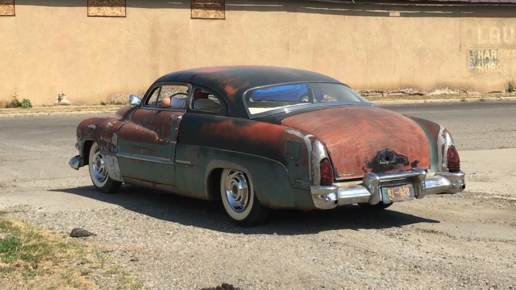

  27. Kustomkid
    Posts: 531
    Kustomkid
    from Montana
  28. drdave
    Joined: Jan 3, 2006
    Posts: 5,366
    drdave
    That doesn't look like home, so I'm going to have t ***ume it's driving. [emoji16][emoji106]
    chryslerfan55 and OG lil E like this.

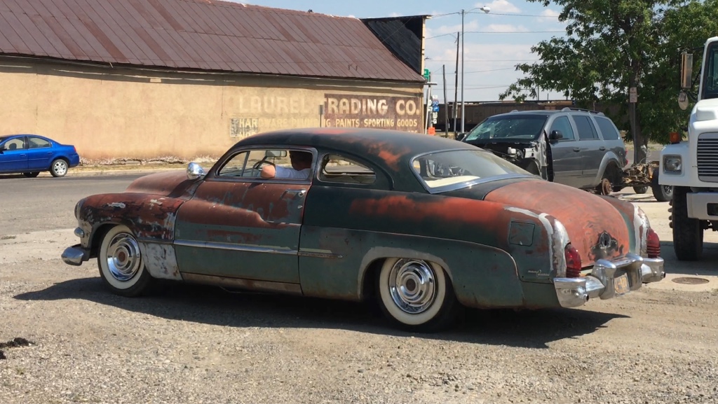

  29. Kustomkid
    Posts: 531
    Kustomkid
    from Montana
    It is home and it's driving! Hopefully it will be licensed next week.
