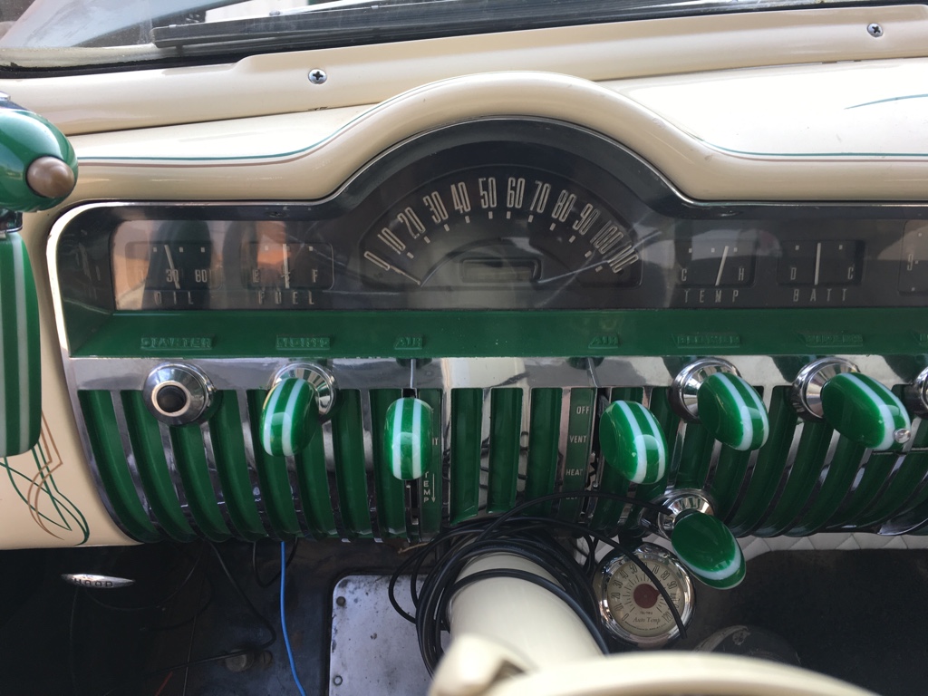

    And the gauges are working!!! Oil pressure is running on the low side, but fuel and temp are working fine. Next are tail lights. [​IMG]

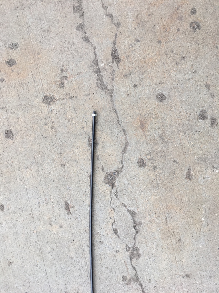

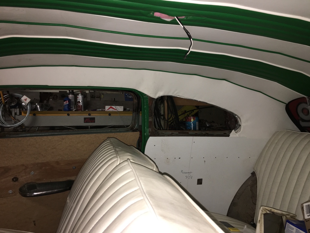

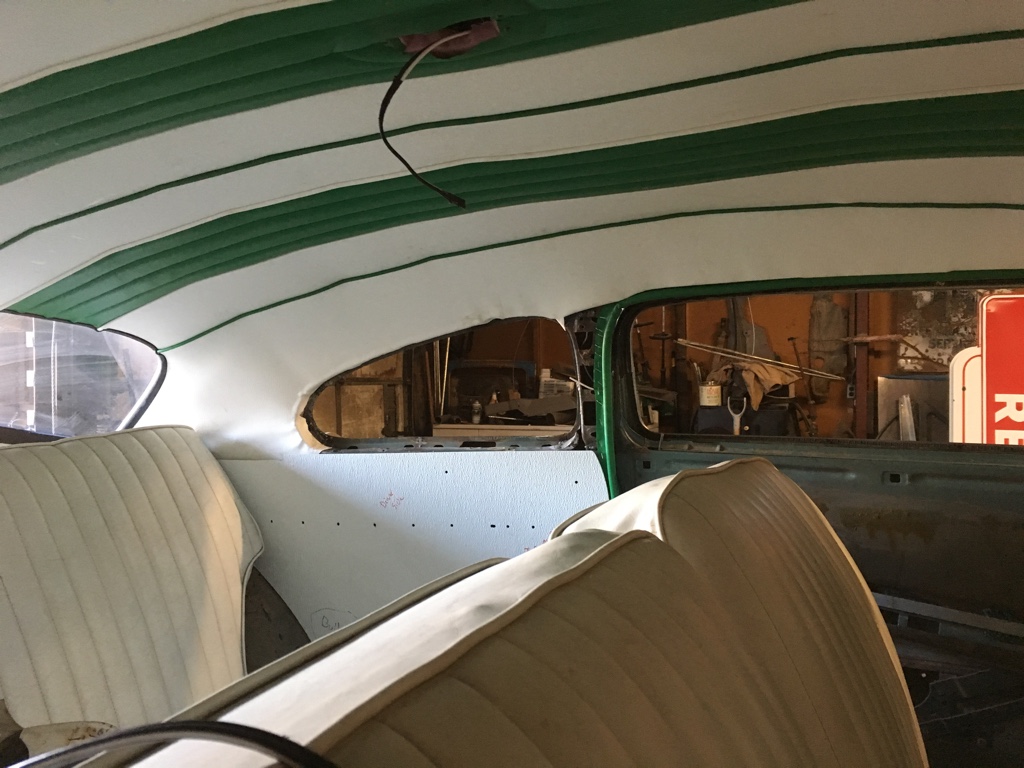

    I think I got the sides of the headliner figured out. I end up cutting a 1/4 inch rod to run from the header to the rear headliner bow. Wired it to all of the headliner bows and wire tied the last panel to it to pull in between bows to have a smoother look instead of the sags. I think it looks better. [​IMG][​IMG][​IMG][​IMG][​IMG][​IMG]
    I steamed the sides just a little to pull the last of the wrinkles out. I hope the rear garnish moldings will help out also. Now p***enger side.

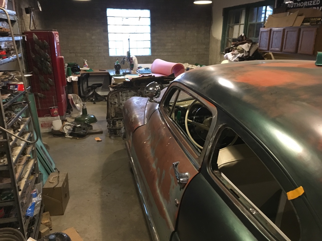

    Well the merc is settled back in the garage for the winter and ready to finish the upholstery. Got to finish arranging the garage but should be able to drive a merc come spring![​IMG][​IMG]

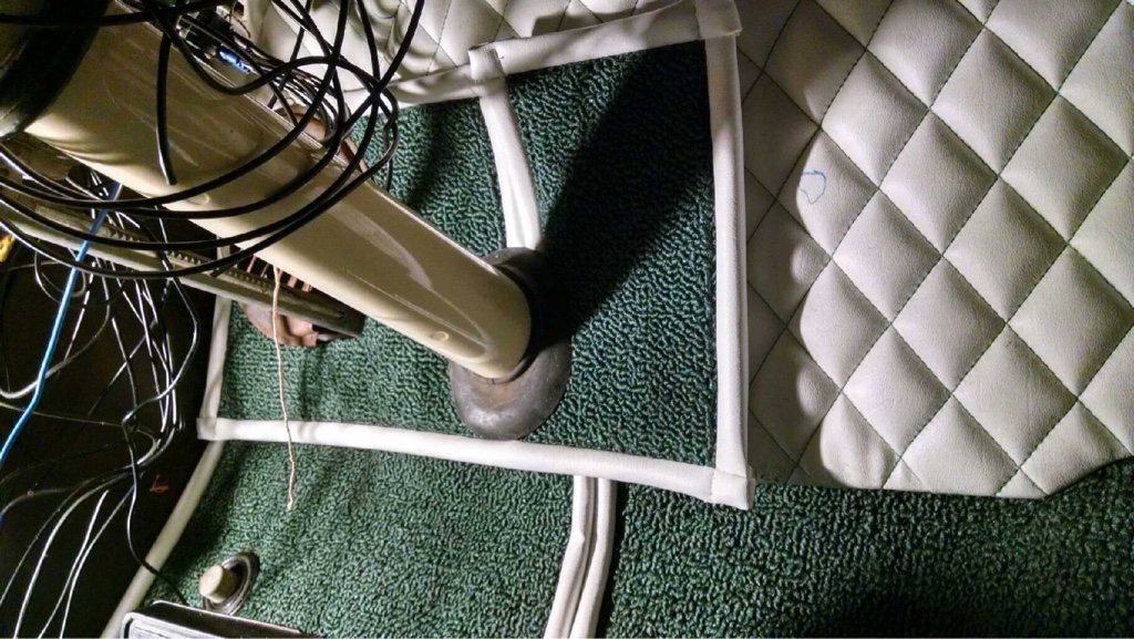

    Got the front insulation down and part of the carpet fit. Still needs to be bound but it fits pretty good. [​IMG][​IMG]
    And the driver side. Hopefully I might be able to bind it this weekend and get the seat back in. [​IMG]

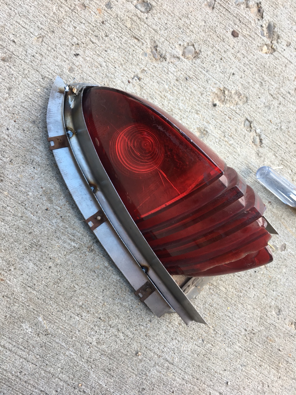

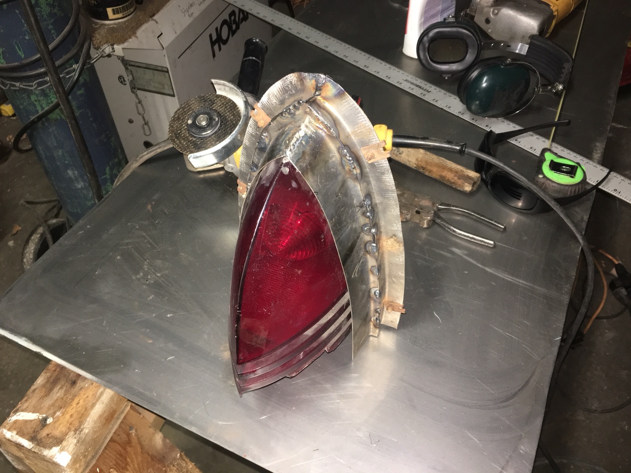

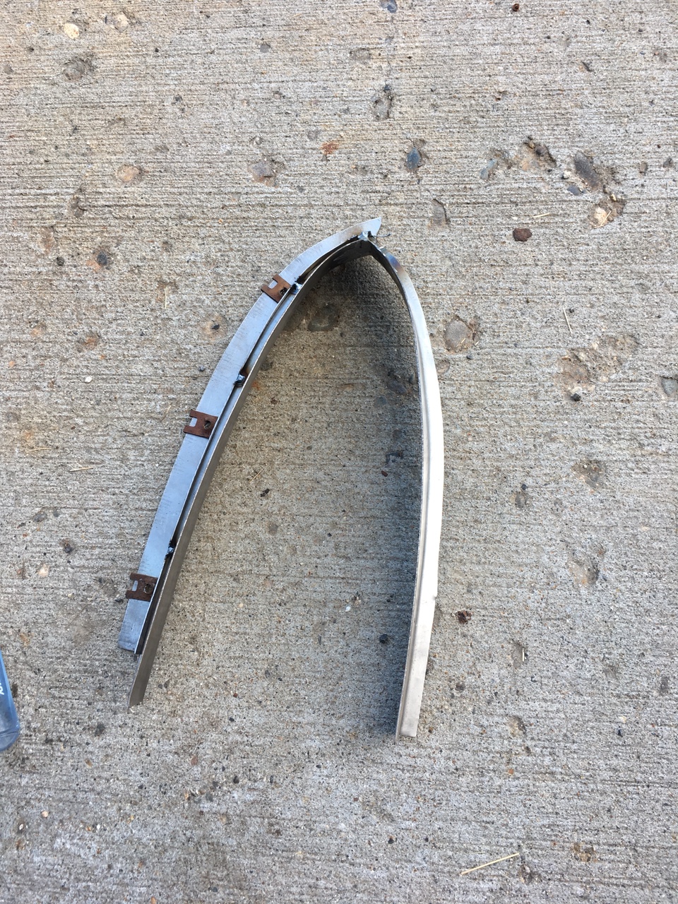

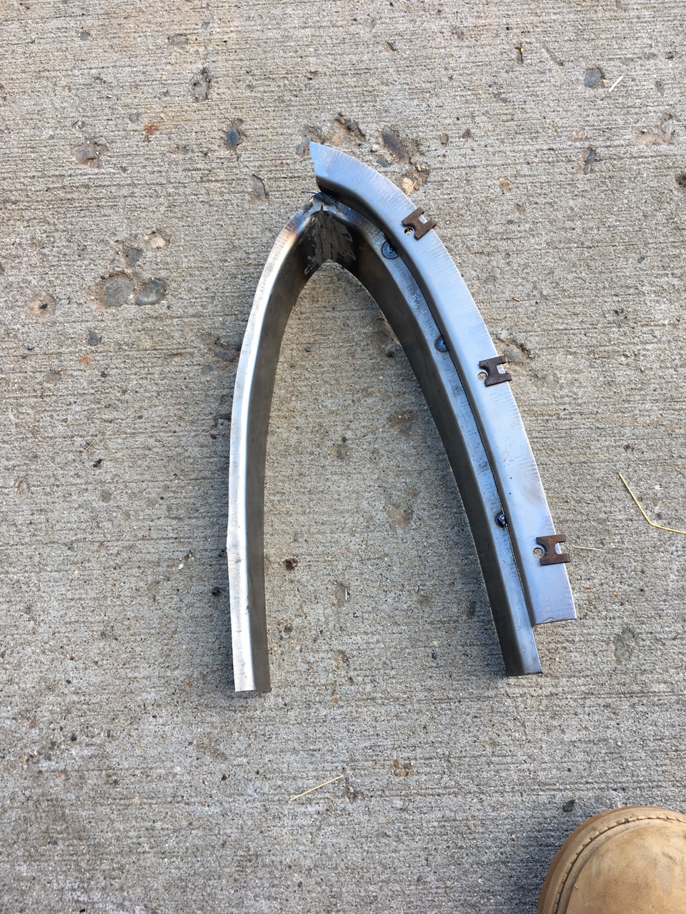

    Got the frame work built for the other taillight. Going to try and install it Tuesday evening and maybe have taillights working for the forth of July [​IMG][​IMG][​IMG][​IMG][​IMG][​IMG][​IMG]

    Taillight is in. Got some adjustments to do but it’s in. Now some wiring.....[​IMG][​IMG]

    That's a nice piece you made to mount the lights. Is that how you did it in your first Merc?
  30. Kustomkid
    Joined: Nov 21, 2010
    Posts: 531
    Kustomkid
    from Montana
    Yeah, pretty much. I didn’t have a shrinker/stretcher when I did the old merc, so it was 4 pieces instead of 2. Held onto my broken lenses for 20 years to do another set of lenses
