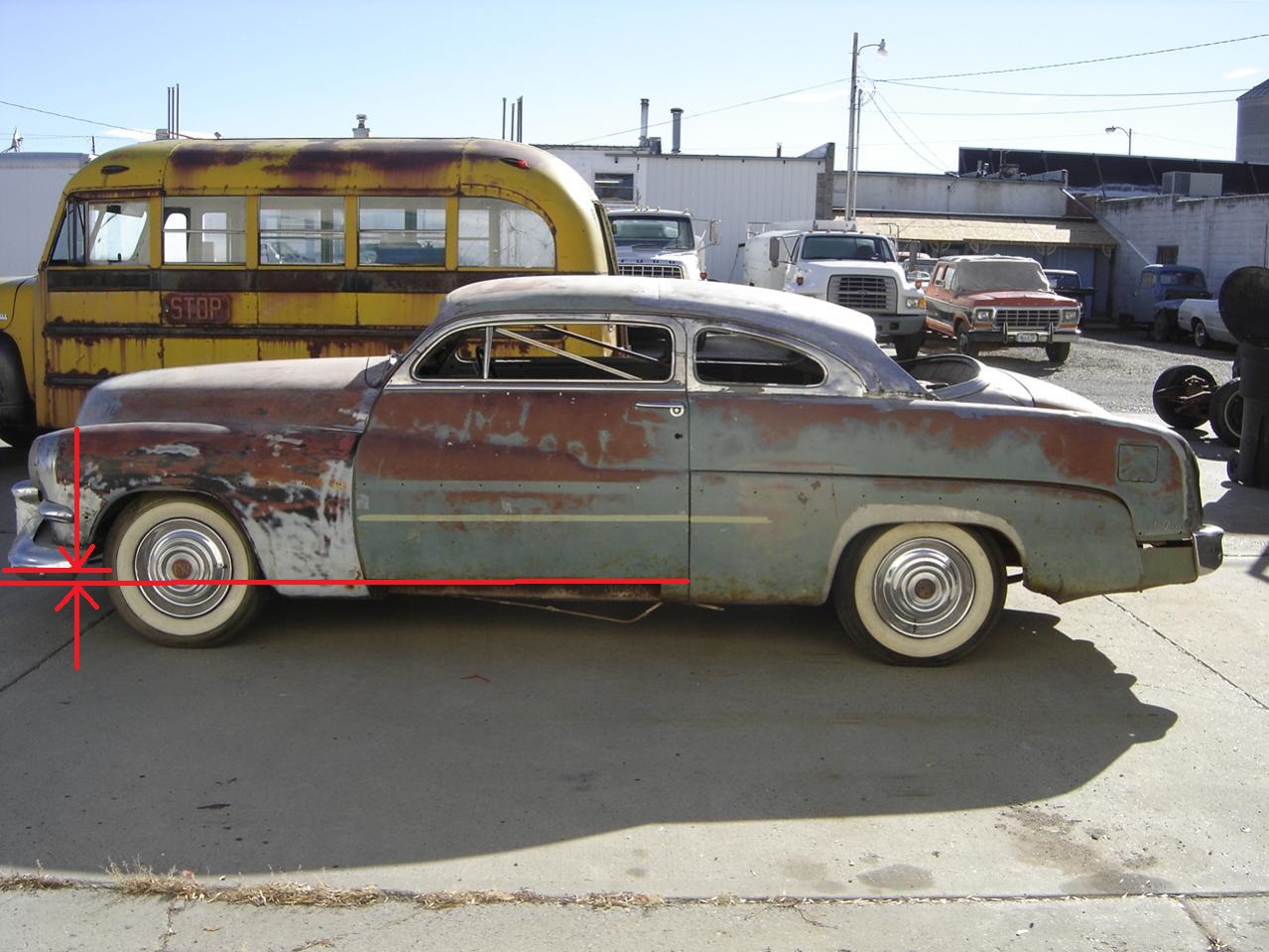

    Sorry to side track the thread but I was wondering if any Merc owners could get a quick measurement for me (Kustomkid had the perfect side shot of his Merc showing what I need). I need a measurement from the bottom of the door edge to the bottom of the front end of the front fender as shown in the attached picture. Thanks, Rhys.
  4. Kustomkid
    Joined: Nov 21, 2010
    Posts: 531
    Kustomkid
    from Montana
    95 1/4 to the edge of fender where gravel pan is mounted. 96 1/4 to edge of bumper. But my bumper is slightly crooked right now. Hope that helps

    Hello Kustomkid,
    Thanks for the quick reply, the measurement I am looking for is pictured below. It's hard to explain but if you shoot a line from the bottom of the door edge out to the front of the fender, I need the measurement down from the flat edge to this projected bottom door edge line. I am measuring 3" to 3-3/4" depending on how I set my front sheet metal up (I am attaching to a non traditional frame and need the reference measurement). By the way, you do some awesome work. I have been following your thread for some time and I am enjoying the updates. Much appreciated, Rhys.
  7. Kustomkid
    Posts: 531
    Kustomkid
    from Montana
    I measured the merc and got 3 inches for what you needed. Ryan

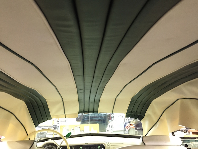

  23. drdave
    Joined: Jan 3, 2006
    Posts: 5,366
    drdave
    I used bows, but am debating using a structure to staple it up when I redo it. I didn't have a full set of bows when I did it, so I'm certain that was part of my problem....that and I let my pleats get to wide, so I missed my marks where the curve of the headliner should be. :( Have you ever seen the article in Custom Rodder about how they made the structure to staple up the one in the Zaro Merc when Kurt McKormick restored it? I may do something like that next time.
    Here's a link to the page in my thread how I did mine....failures noted. LOL
    http://www.jalopyjournal.com/forum/threads/the-un-****-ifying-of-a-merc.678319/page-14
  24. Kustomkid
    Posts: 531
    Kustomkid
    from Montana
    I have that issue. Was think going that route. It's a cool headliner.
