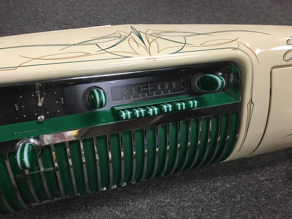

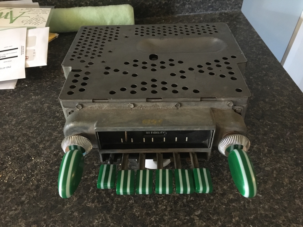

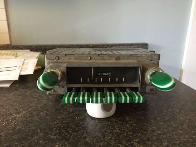

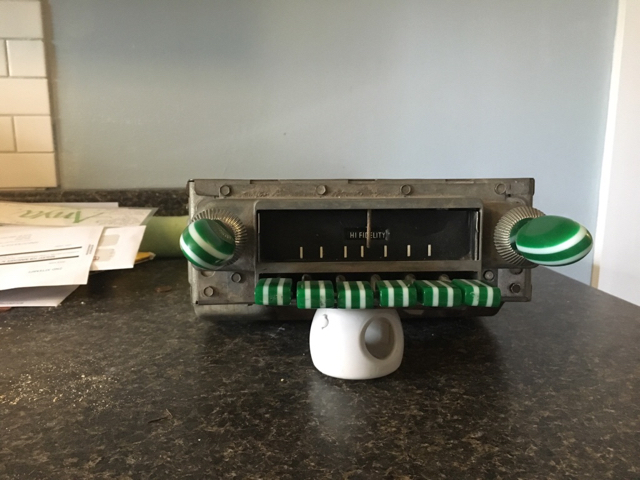

    I got the last little bit done on the radio. Electronics are in and the knobs are polished and installed. From first glance, nobody will never know..... ImageUploadedByH.A.M.B.1458012070.229724.jpg ImageUploadedByH.A.M.B.1458012090.182275.jpg ImageUploadedByH.A.M.B.1458012101.815043.jpg ImageUploadedByH.A.M.B.1458012117.799336.jpg

  9. Verbal Kint
    Joined: Aug 4, 2004
    Posts: 3,221
    Verbal Kint
    from Washington
    Looks great, good to see it coming together
  10. drdave
    Joined: Jan 3, 2006
    Posts: 5,366
    drdave
    Looks awesome!!
