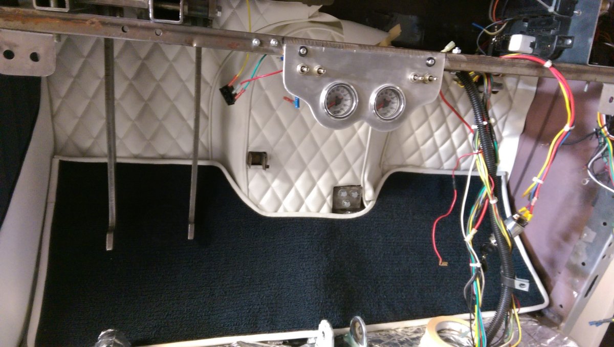

    I'm going to try and tackle the firewall pad. Found the foam at Walmart, a 1/2 inch mattress pad. The dimples may help with the vinyl laying flat and not puckering in the corners like full on 1/2 foam. We shall see.... ImageUploadedByH.A.M.B.1461437627.385056.jpg

    This is how the full 1/2 foam went. ImageUploadedByH.A.M.B.1461462418.644488.jpg
    I think 1/4 foam may work better. Looking at some of the original hirohata photos, the firewall pad wasn't padded much.

  18. drdave
    Joined: Jan 3, 2006
    Posts: 5,366
    drdave
    You have probably seen some of these, but here are a few from my reference file. The first one is when it was "new" the second before it was restored and the last after it was restored when I saw it at the GNRS Customs Then and Now display. The first two almost look like there is no padding at all on the firewall cover and the kick panels, while the restored version looks like you say...maybe a 1/4 inch? I also notice the original panels had the white with green s***ching like your test panel and the new upholstery has white s***ching.

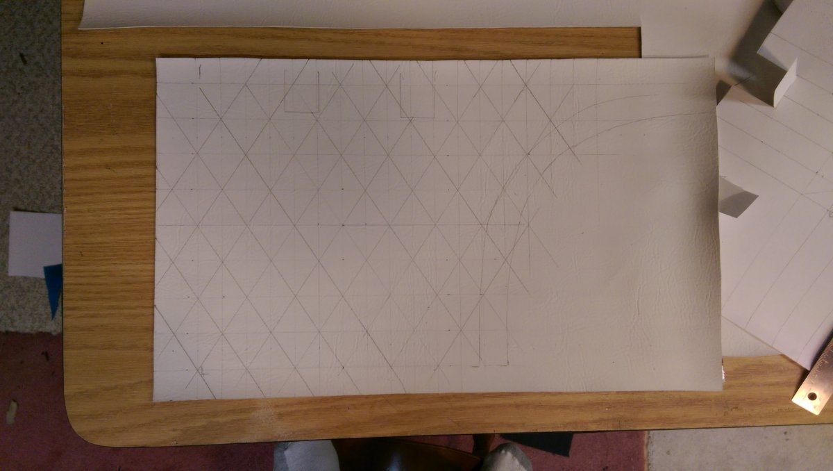

    I just did my firewall with 1/2" scrim back foam and it looks like this:
    And a bit closer look.
    drdave and Kustomkid like this.

  21. K13
    Joined: May 29, 2006
    Posts: 10,015
    K13
    Thanks. Basically I just laid out a grid of rectangles starting in the middle of the piece the size of the diamonds I wanted and drew in the lines. Here is a picture of one of the sides.
    I started by putting a vertical and horizontal line centred in the piece and worked out from there. I think I did 1" out and 1 1/2" up from the middle of the piece which gave me a 3"x 2" diamond. You can see the dots in the middle of the piece that was where I marked how far up and out I went from center. Then I just did consecutive vertical and horizontal lines out from there and then just ran the diagonal lines through the corners of the rectangles. Are you putting a cloth backing on the foam or using a scrim backed foam? That really helps the s***ches hold and gives the nice full look.

    I'm backing my foam with cloth. I wasn't able to find scrim backed foam locally.

    from Montana
    Thanks to K13, I got the diamonds finally layed out and ready to s***ch. ImageUploadedByH.A.M.B.1462143488.407307.jpg ImageUploadedByH.A.M.B.1462143503.073500.jpg

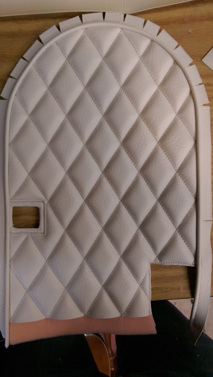

    Finally got the rest of the s***ching done on the firewall pad. ImageUploadedByH.A.M.B.1462576830.226750.jpg
    And the pattern traced out on the pad now. ImageUploadedByH.A.M.B.1462576886.039142.jpg ImageUploadedByH.A.M.B.1462577461.183074.jpg

    I got the perimeter s***ched and trimmed. Should work. ImageUploadedByH.A.M.B.1462598221.972239.jpg
