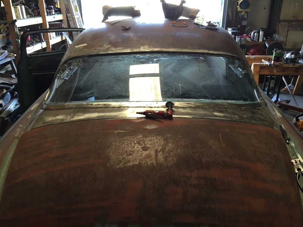

    So I ended up relieving the corners of the rear window and pushed up the center about 3/4 of an inch. ImageUploadedByH.A.M.B.1464487070.970071.jpg ImageUploadedByH.A.M.B.1464487119.690400.jpg ImageUploadedByH.A.M.B.1464487159.951790.jpg
    So I may luck out and not have to cut out the opening if I can make it stay up. ImageUploadedByH.A.M.B.1464487550.373007.jpg

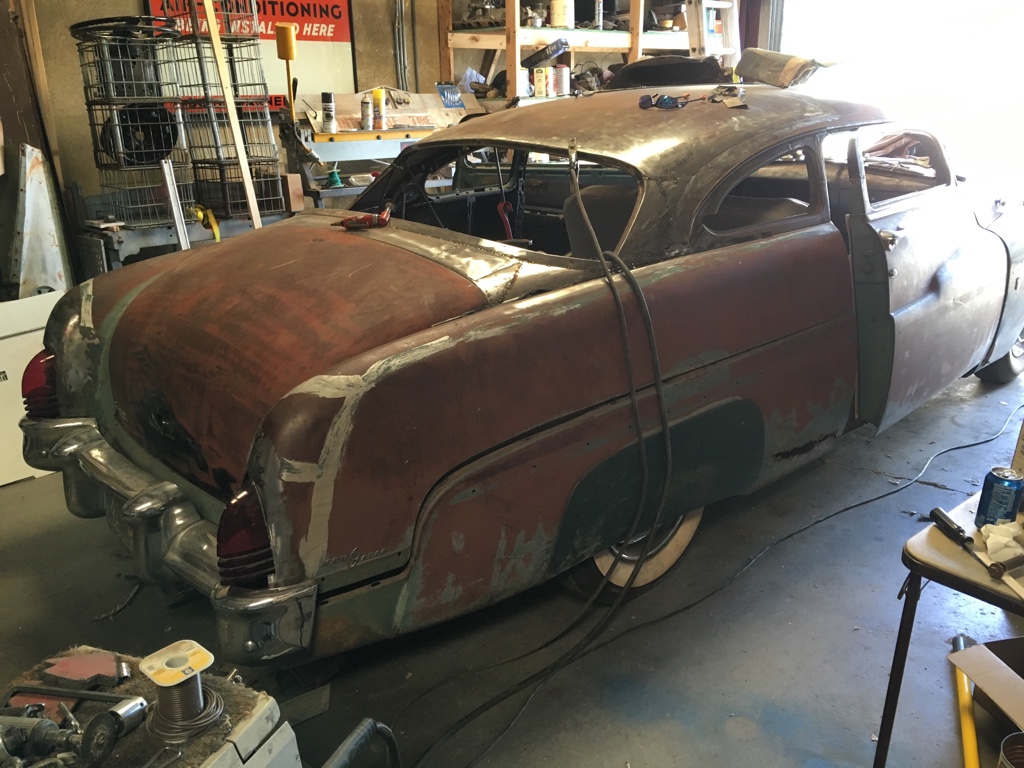

    Got the corners welded and got the inner braces reinstalled. ImageUploadedByH.A.M.B.1464562602.513150.jpg ImageUploadedByH.A.M.B.1464562622.698270.jpg ImageUploadedByH.A.M.B.1464562640.266265.jpg ImageUploadedByH.A.M.B.1464562687.983329.jpg
    With the prop rod out, the roof seemed to stay and it looks like the window is going to fit!!!
    ImageUploadedByH.A.M.B.1464562804.423489.jpg ImageUploadedByH.A.M.B.1464562815.741293.jpg
    Then the quarter window.
    ImageUploadedByH.A.M.B.1464562908.062973.jpg ImageUploadedByH.A.M.B.1464562924.297202.jpg ImageUploadedByH.A.M.B.1464562937.657654.jpg ImageUploadedByH.A.M.B.1464562949.033574.jpg ImageUploadedByH.A.M.B.1464562976.484064.jpg ImageUploadedByH.A.M.B.1464562997.352125.jpg ImageUploadedByH.A.M.B.1464574258.610442.jpg ImageUploadedByH.A.M.B.1464649552.675193.jpg ImageUploadedByH.A.M.B.1464649567.749874.jpg ImageUploadedByH.A.M.B.1464649580.583712.jpg
    Just 1 windshield post left.

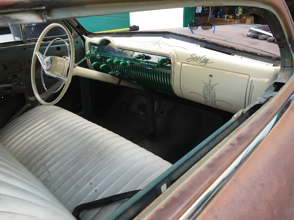

    Got the other windshield post welded and decided to test fit the dash. Hasn't been in the car in over ten years. ImageUploadedByH.A.M.B.1464746272.273370.jpg ImageUploadedByH.A.M.B.1464746282.872480.jpg

    Glad the rear window worked out with just those relief cuts. A lesson for me to remember....try something easy first before panicking and doing something drastic. [emoji6]

    I'm pretty happy that it worked. I was about to cut it out when I thought just try it.

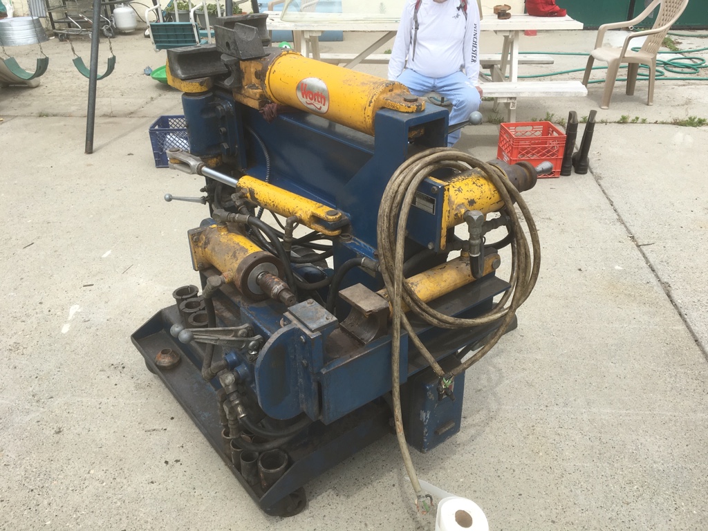

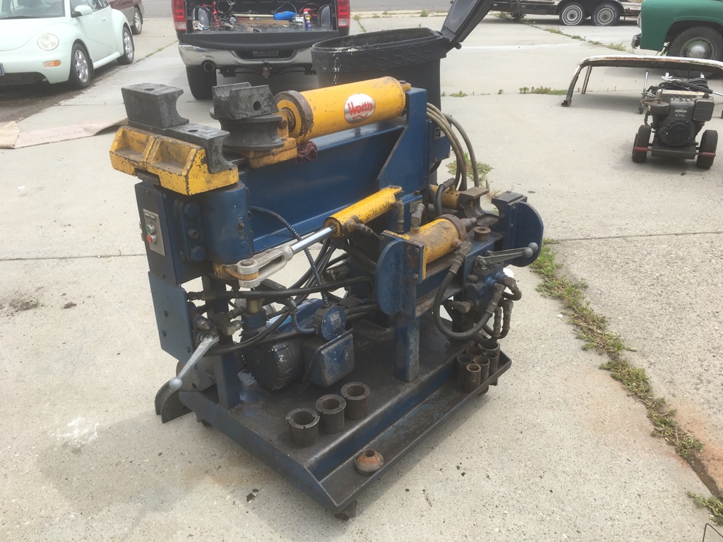

    Just got home with this last night! Long trip but worth it. A 80's Worth 140 bend-o-matic exhaust bender. ImageUploadedByH.A.M.B.1465688952.076049.jpg ImageUploadedByH.A.M.B.1465688972.927725.jpg ImageUploadedByH.A.M.B.1465689009.597557.jpg ImageUploadedByH.A.M.B.1465689023.479127.jpg ImageUploadedByH.A.M.B.1465689042.664026.jpg ImageUploadedByH.A.M.B.1465689066.351005.jpg
    It's going to be fun to do the exhaust in the merc and the 59.

  26. Kustomkid
    Joined: Nov 21, 2010
    Posts: 531
    Kustomkid
    from Montana
    Got to get a seal in the main cylinder to stop the leak and I will be bending. Tried it last night and it works good!

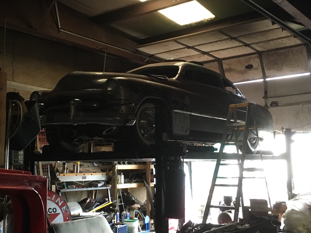

    And the merc is back on the lift for exhaust.
    Anyone out there have some 52-53 Cadillac exhaust tips?

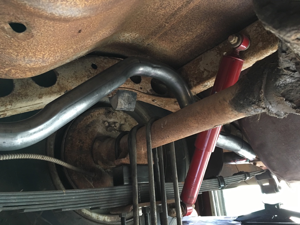

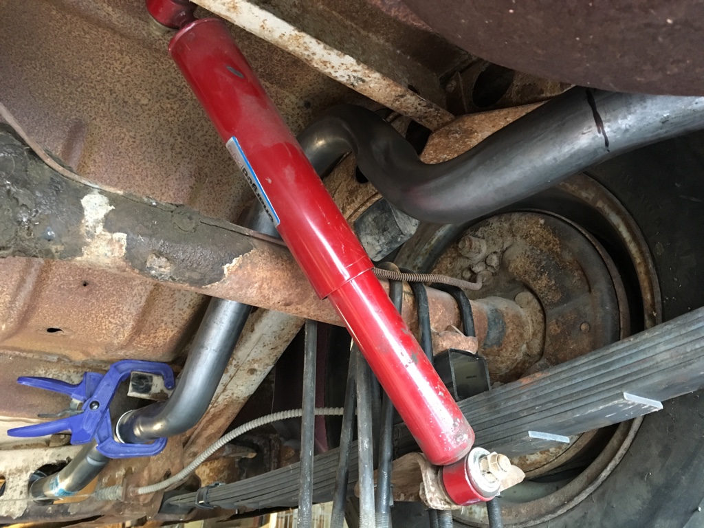

    Got the p***enger side exhaust ran. Rebuilt the hanger and got it ran so it will exit through the bumper. ImageUploadedByH.A.M.B.1468187769.683320.jpg ImageUploadedByH.A.M.B.1468187798.601174.jpg ImageUploadedByH.A.M.B.1468187823.086209.jpg ImageUploadedByH.A.M.B.1468187838.843271.jpg ImageUploadedByH.A.M.B.1468187875.701667.jpg ImageUploadedByH.A.M.B.1468187897.624383.jpg ImageUploadedByH.A.M.B.1468187931.026867.jpg ImageUploadedByH.A.M.B.1468187953.561364.jpg
