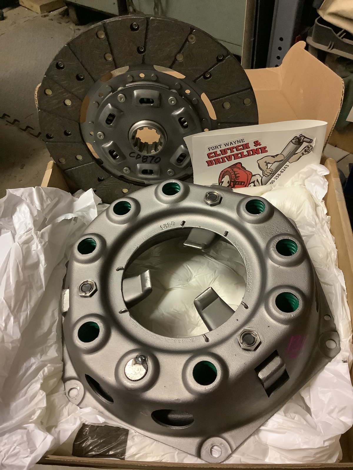

    Ft. Wayne Clutch is where mine came from. Borg and Beck PP #1310 for 49-51 Merc.
    Call and talk to Lou. Core charges are way high. Flywheel is 168 tooth to match your crank bolt pattern.
    Used a Cragar Chevy to early Ford V8 trans.
    another option that was posted on here. Probably cheaper than Ft. Wayne
    https://kyclutch.com/

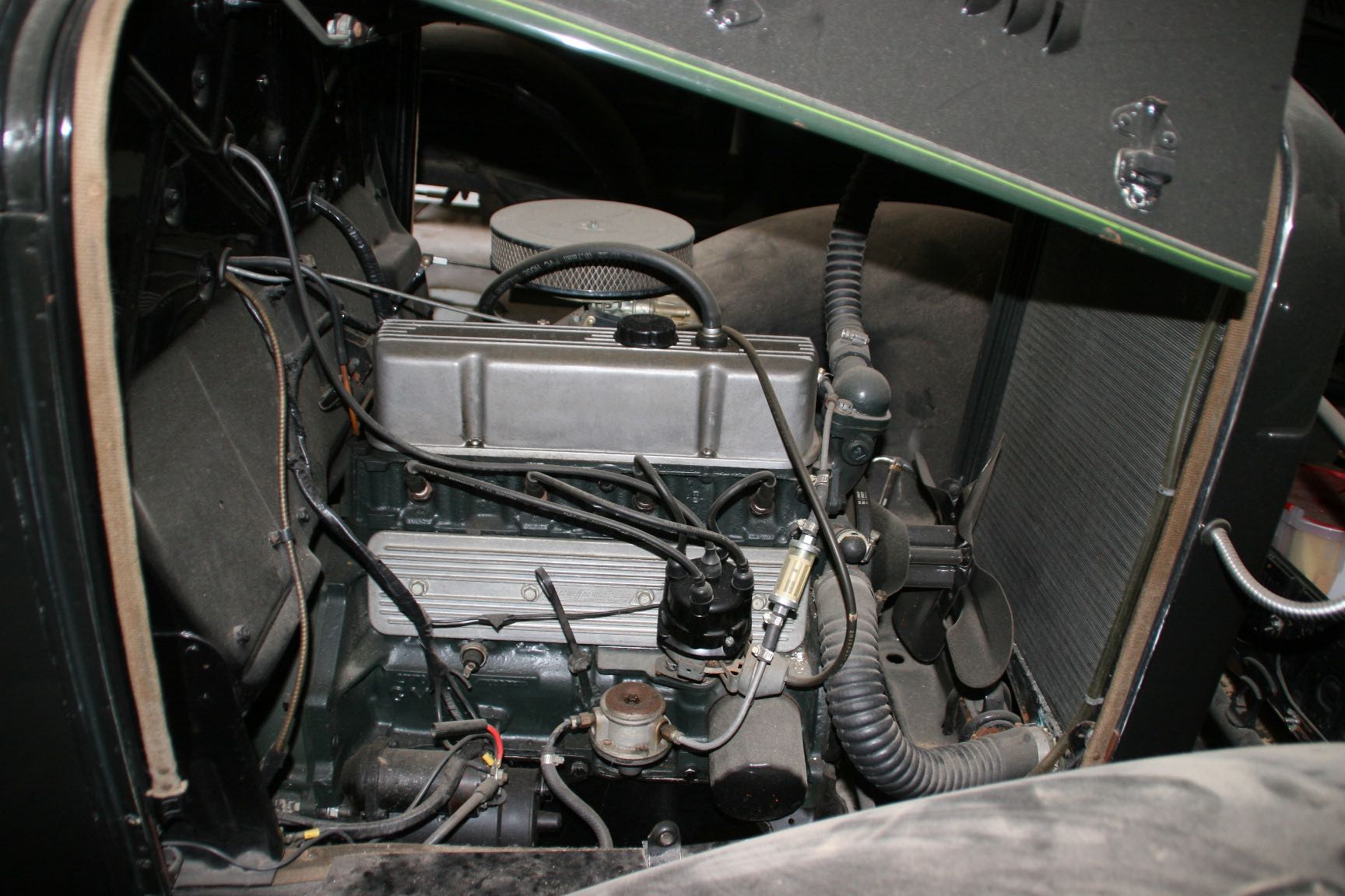

    I put a S10 pickup 2.5 l, 151 cubic inch engine in my Model A coupe. The only reason I didn't use a Chevy II/Mercruiser style engine is that I didn't find one easily when I was doing the build. I bought a complete S10 pickup out of a salvage yard and the engine and transmission went into the model A. By the time I had pirated out and sold some other parts and eventually the carc*** of the S10 pickup I had about $300 in my engine and transmission without any rebuild necessary other than new gaskets in a rattle can rebuild. I put quite a few miles on it, not tens of thousands, but quite a few miles and I'm very happy with the way it drives and handles. Steering is nice and easy too with the little lightweight 4 cylinder instead of the extra weight of a V8.
    The short story is I would do pretty much the exact same thing again but still would lean to the Chevy II/ MerCruiser engine if I found one. Actually I have a freshened up 153 sitting under my workbench right now. Mild Cam and a Rochester 2gc carburetor on the MerCruiser manifold that was cut down to be intake only. I built a tri-Y header for the exhaust.
