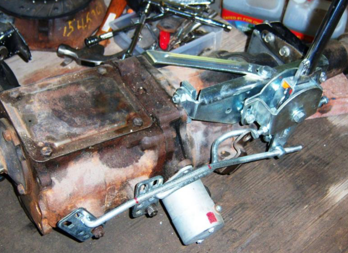

    I have a regular 3speed shifter modified to fit an OD
    I’ll try to find a pic

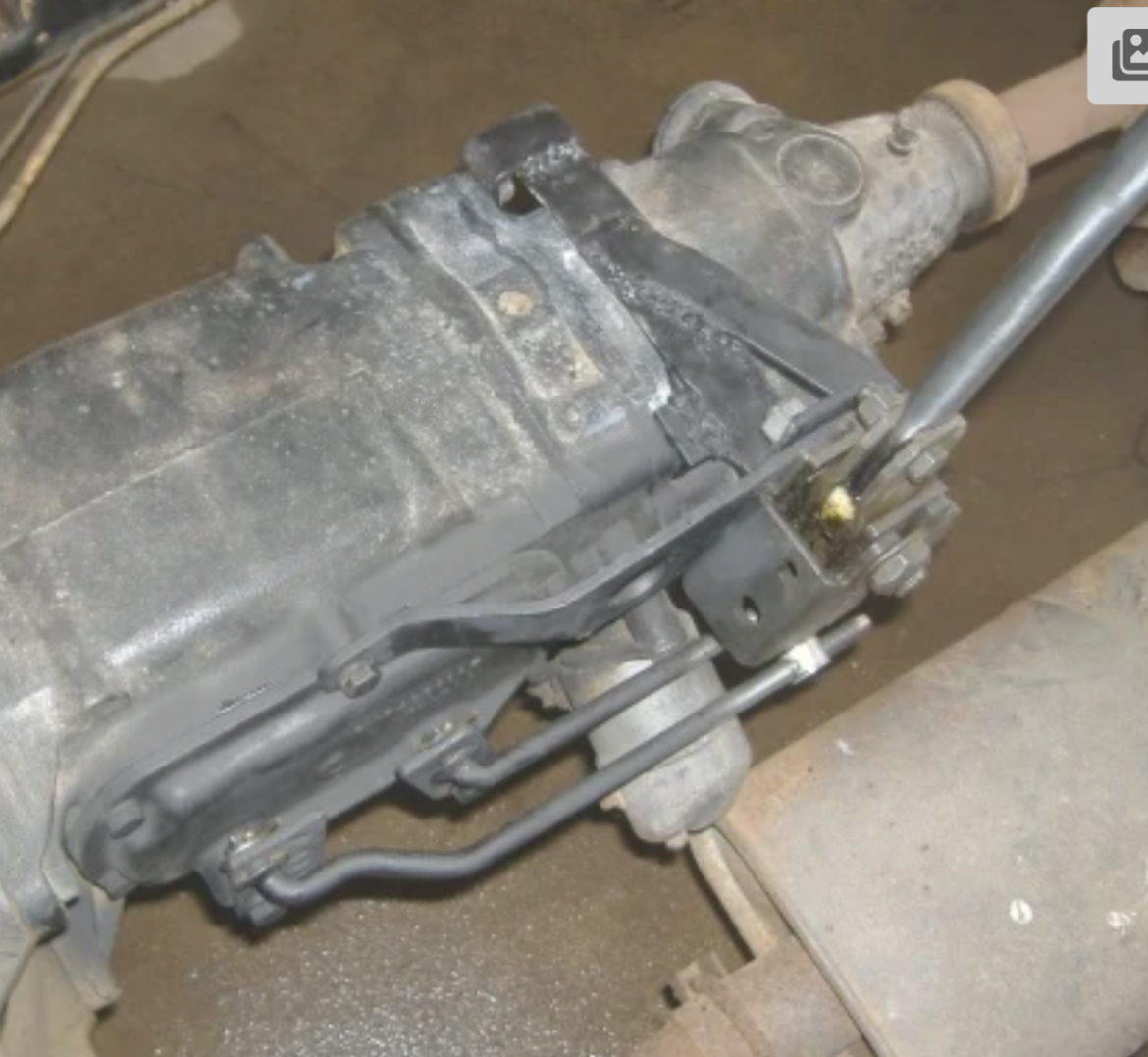

  4. Homemade shifter mount I got when I bought an old OD trans
    raises up the shifter.
    The original owner modified the rods to clear the solenoid
    Needs the original shifter brace cut at the red line
    Shifts great on the floor of the shop

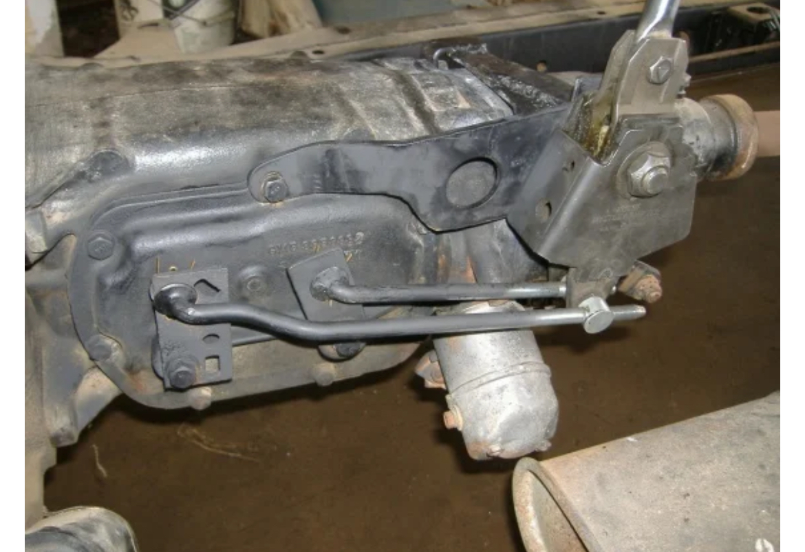

    This link is to the Hot Rod Reverend blog. Not directly applied to you, but it shows the Hurst brackets for the shifter on an overdrive. It’s either got to go back, up, or out to clear the solenoid.
    Anthony’ is back and up. The Hurst bracket does both (best guess looking at it) but also moves out to clear the o/d cable operating lever.

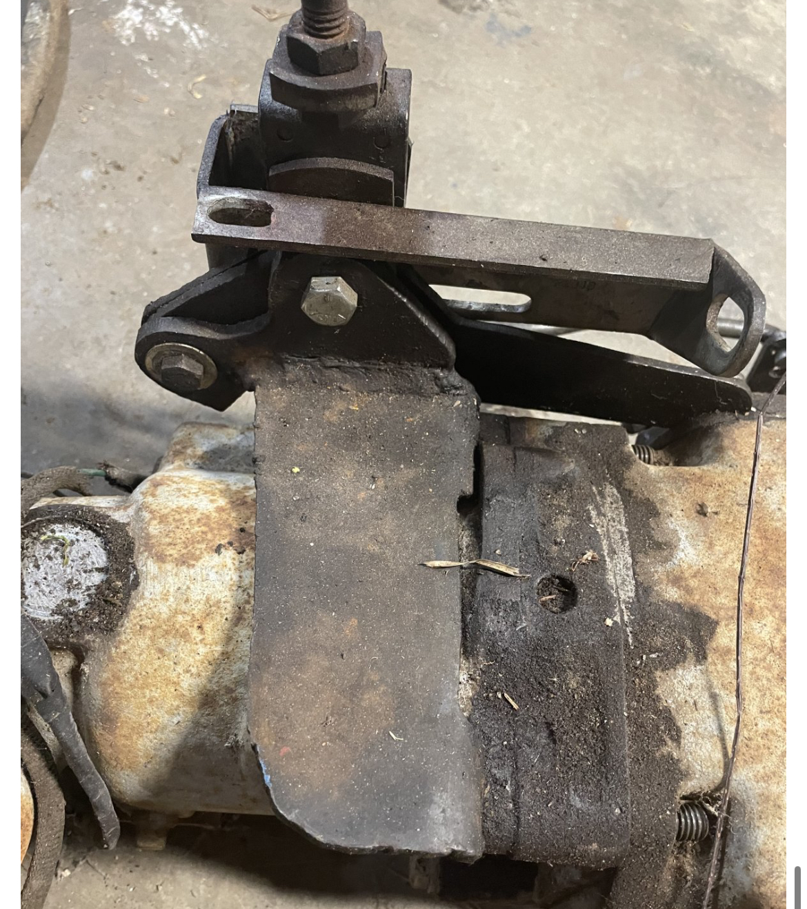

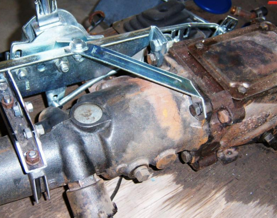

  7. Here’s this example

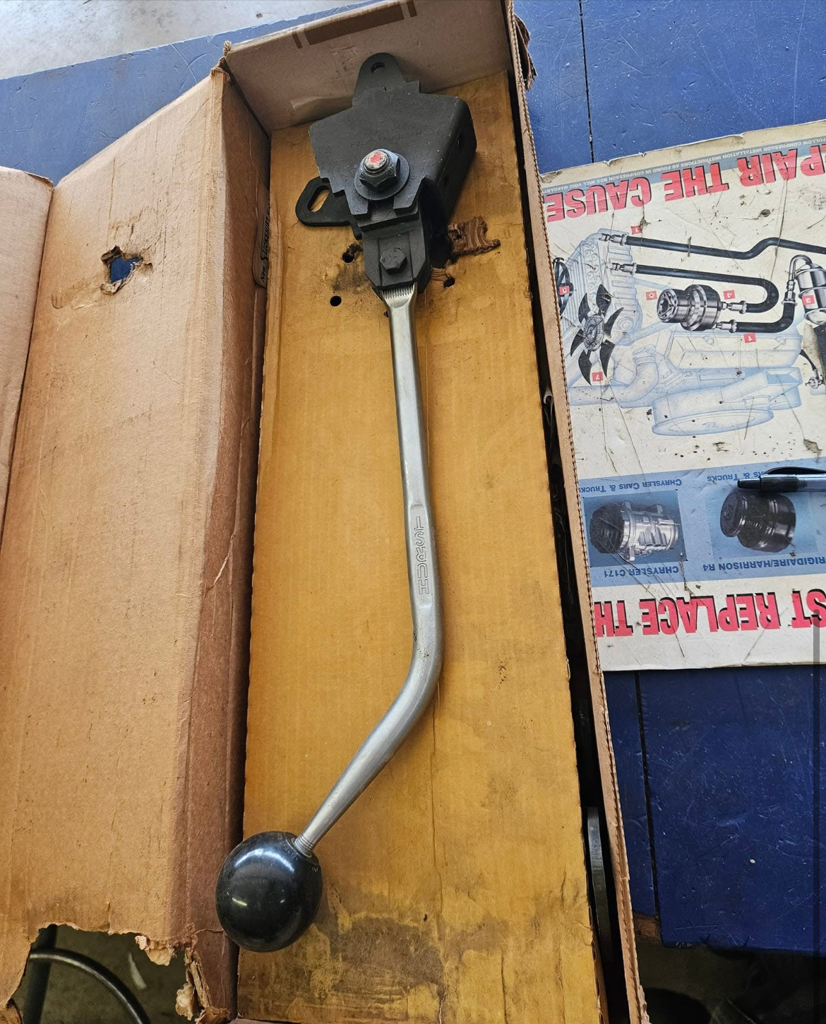

  10. Here’s a NOS mystery shifter for a tri 5 OD
    you can see the bracket.
    Same dude had a couple for old fords last time I was there a month ago

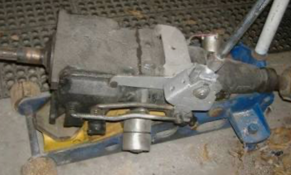

  14. This one has been in the classifieds a while.
    Solinoid is not there but you get an idea. Doesn’t look like it would take much to clear it

    UPDATE Just got a note from Brad (Rocco and Cheaters). After some more digging, he found a Mystery Shifter new in the box for my Merc! Of course I bought it. Better than getting a BB gun for Christmas!
    I'll keep you guys updated on this project and post some pics (when I figure out how to).

    Shifter arrived promptly and wasn't a bad install. Had to tweak the tranny tunnel a bit, but someone years ago had cut a couple holes in it and later brazed patches over the holes in an apparent attempt to revert back to column shift. The column shifter was junk, so finding this NOS Hurst Mystery Shifter (instructions are from 1962) was better than winning the lotto.
    Now to add some pics. Thanks again to all.

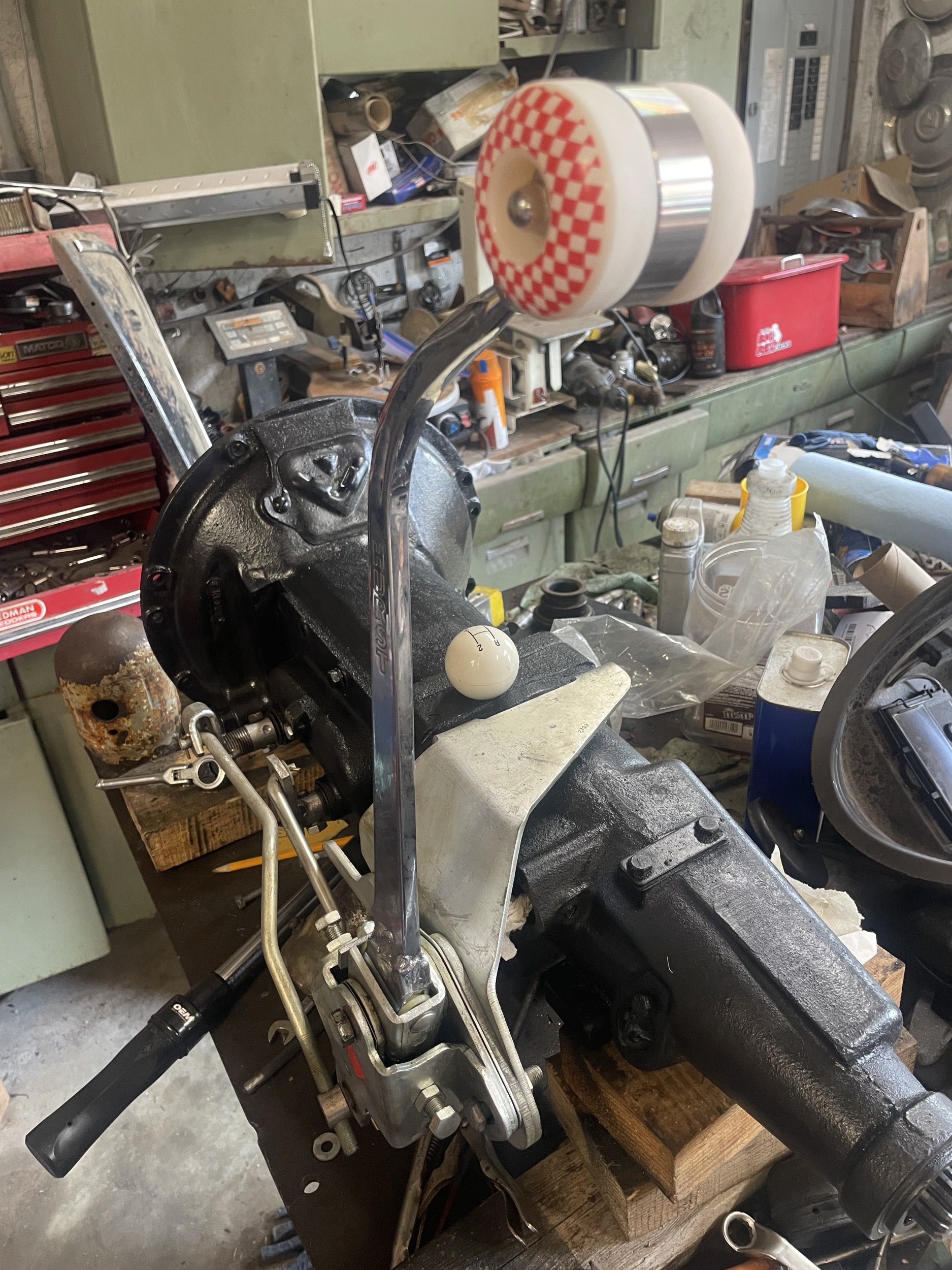

    here’s mine. Also from Rocco
