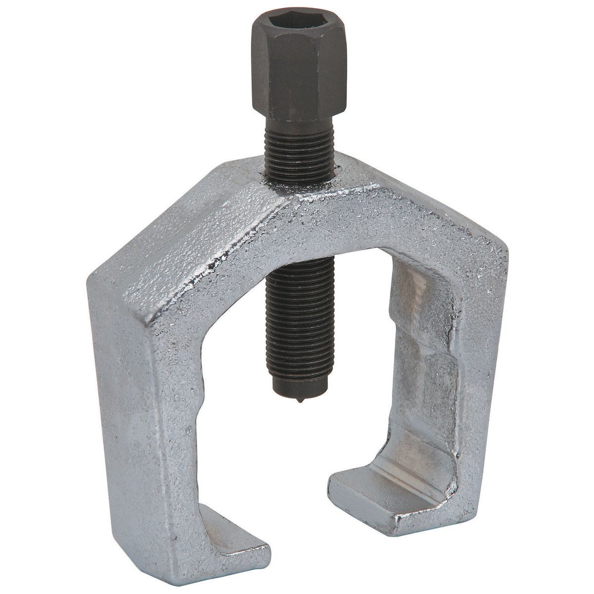

    NOOOO!!! Don't use a fork! Simply go to Harbor Freight, and buy a puller.
    They have 3 different sizes, so measure the knuckle where the tapered bolt goes thru, and buy the 'C' shaped puller that will fit over it.
    Remove cotter keys, and nuts. Apply puller to each station, one at a time.
    No weight is supported with the steering linkage, just point wheels straight ahead, wiggle steering wheel back and forth a couple of times.
    Everything 'at rest', now remove the steering 'rod ends'
    A fork would have stressed the ball sockets, and torn the grease boots.
    Aren't we glad we did it right? The tool costs less than $7. And you get to keep it forever.

    . Mike, is this the one you're referring to?
