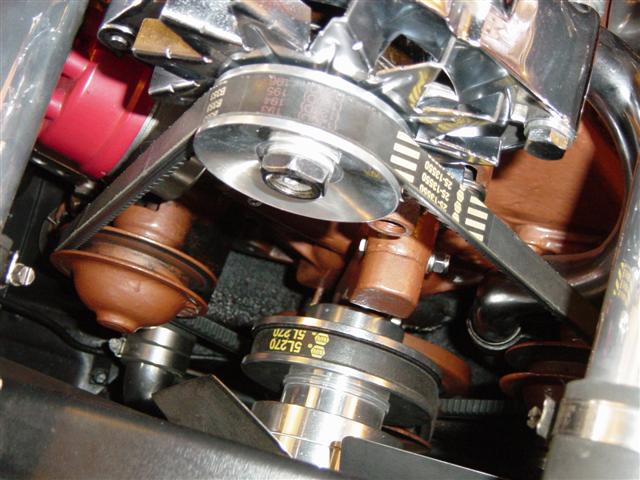

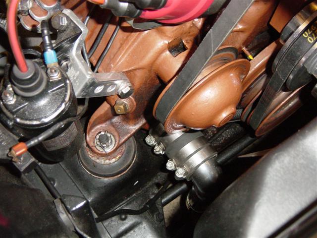

    These are photos of 1953 FORD engine in a 40 Ford using 5/8 wide Ford truck water pumps with no spacers under the biscuits. I do not know if spacers are needed in a 32 Ford. There are two belts. One runs off the crank pulley to the fan pulley. The other operates the alternator, water pumps and runs off the crank pulley. The crank pulley is a wide belt 2 sheave FORD TRUCK pulley . You can also use the wide belt Merc pulley.

    Thanks 19Forty. That looks like the set up that I need to run.
    Where did you get those pulleys?
    The alternator looks straightforward.
    Where do I hunt for the fan and crank pulleys? I dont seem them in catalogs, Speedway etc.
    Maybe someone out there has some laying around that i can buy from them.
    Using the truck pumps would make my life easier. Just gotta figure out the pulleys.

    The fan carrier pulley set up you see in the photos is one I made. But the entire fan pulley set up off an early Ford pick up or 49-50 Merc may also work.
