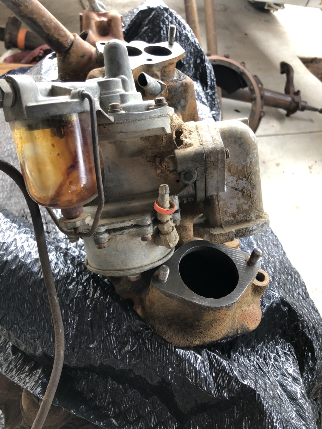

    Pulled my Stromberg 97 apart & I’m cleaning it so that I can re***emble it. Someone painted some of the carb with a blue metallic paint that’s not gonna work for me. Can I soak the carb in paint thinner or acetone to get rid of the paint????? Also what does the aluminum base on the bottom adapt to. It’s definitely not for a flat head from what I can tell. Thanks for all the help with everything. I’m learning as I go.
    [​IMG][​IMG][​IMG]
    Mattsbidnuz and chryslerfan55 like this.
  29. tubman
    Joined: May 16, 2007
    Posts: 8,679
    tubman
    It looks like what was used to put a Ford two-barrel (94 or 97) on a Chevrolet or Plymouth or Dodge six.
    Don't toss it, somebody will want it.
    It looks like the blue paint is only on the cast iron base and steel linkage parts, so you should be able to use just about anything that works good on them. Be careful with the rest of it.

    Acetone or lacquer thinner won't hurt any of the hard parts in that carb. Soak away. And buy genuine Stromberg rebuild kits. Uncle Max is a great source for all parts Stromberg. And rebuild labor too if there is something you can't handle. Nice guy and very helpful.
