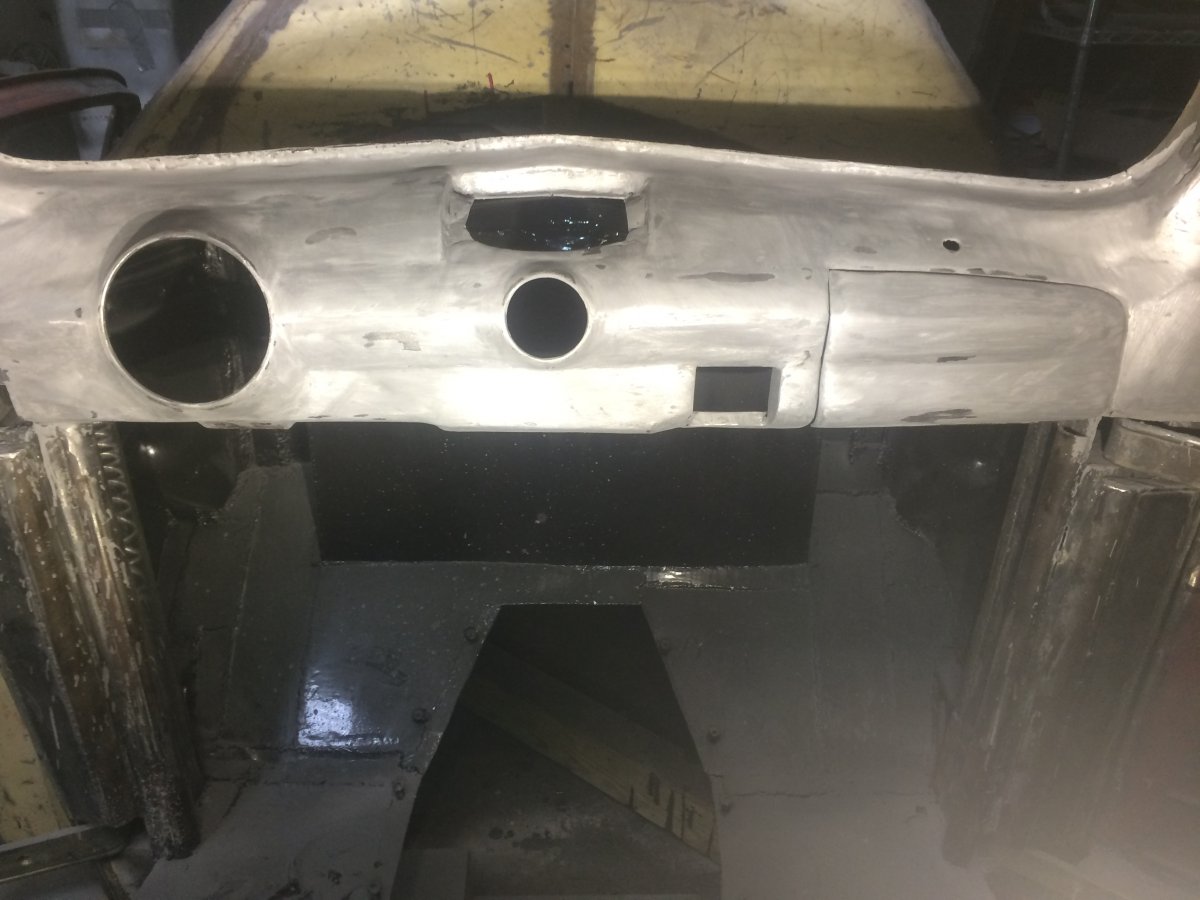

    On my Model A truck the original plan was to paint the cab, and leave the bed bare metal. The bed is handmade from stainless steel sheet. Where we made some welds, ive been back with a grinder and knocked the welds down, but there are some low spots. Is there such a thing as all metal filler that can be dressed to match the bare metal? Also we had a brain fart and welded it with wire for carbon steel, so I had planned on trying the exo armor stuff to keep those areas from corrosion. My last resort would be to bodywork it and paint, but I'd like that to be a last resort. Thanks in advance. ImageUploadedByH.A.M.B.1447774550.259409.jpg ImageUploadedByH.A.M.B.1447774577.507101.jpg

    Now's a good time to learn how to use a hammer and dolly.

    You could put some All Metal on it, BUT I'm not sure how it would match the bare metal and I have seen that stuff crack before from road vibrations before. I personally not a huge fan of the stuff.
  4. Stainless steel bed, that's alot of trouble to ****it up with mild steel wire. The welds are sorta **** and they will rust.
    There's a stainless paint- its an epoxy fortified with stainless steel particles. There's small kits that are used to coat your appliances. Change your olive green fridge into stainless type stuff. There's also different grades all the way up to certified industrial food grade. Its quite convincing.

    I got busy welding on the cab and moved to the bed without giving it a second thought. Sounds like i'll be bodyworking and painting it!

    I'm not a fan of the alma fill or all metal fillers. I used the all metal over some bullet holes that I welded up on my roof and when it's sunny the all metal expands differently and I can see all the spots where I used it.It also seems to crack more than other fillers. Keep up with your metalwork.It looks like you're doing a nice job!

    Well no body fillers nor USC all metal will stick to stainless. 31 Vicky is correct on the use of a epoxy, but there is nothing you can do really that is durable. I think evercoat makes a epoxy filler, but that doesn't help you match the look of stainless. Now I can give you a tip if you want to do a brushed stainless look. Let me know.

    Your best bet will be to body work and finish it to match the cab.

    polish the insets, and paint the rest...........
