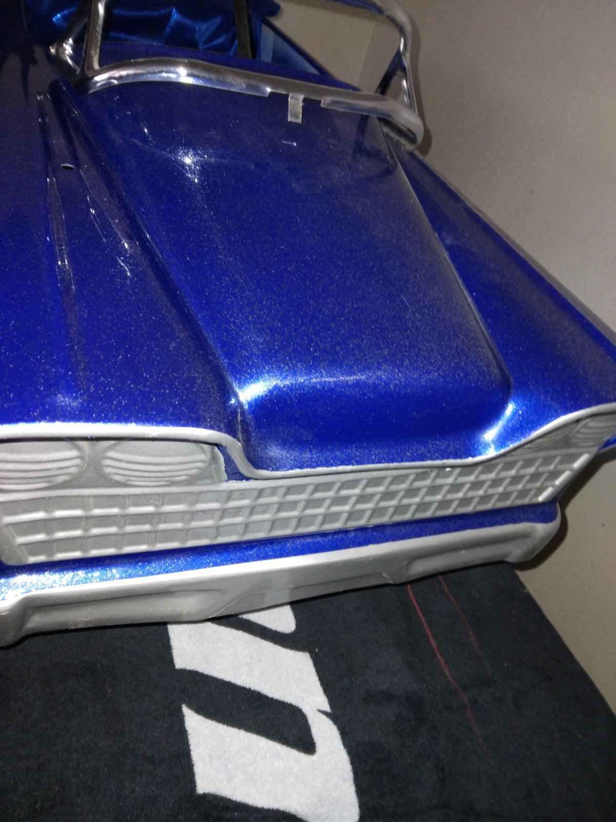

    I shot a pedal car, small project. It taught me that it's messy as heck. I've seen many guys shoot it outside so it doesn't require a level 7 cleanup of the booth.
    Just when you think that's it, another coat makes it even better. I shot medium Blue over Viper Blue. It really needed another coat of 'flake, but it's good. Many will use a Black base and keep shooting until you can't see any black. I'd like to experiment with layers of different sizes, but that's getting into some time and money. Yes, there was a lot of sanding after.
    I will also mention that in the picture, it shows a bit less than it looks like in real life. Indoor lighting, and not moving. Out in the sun, it dances!

    Here it is in the sun, just now.
    For anything out in the elements, you want intercoat clear to hold the flake (quick drying time) but a quality clear on top with UV protection.
    You've probably seen an old 'flake job that has faded.

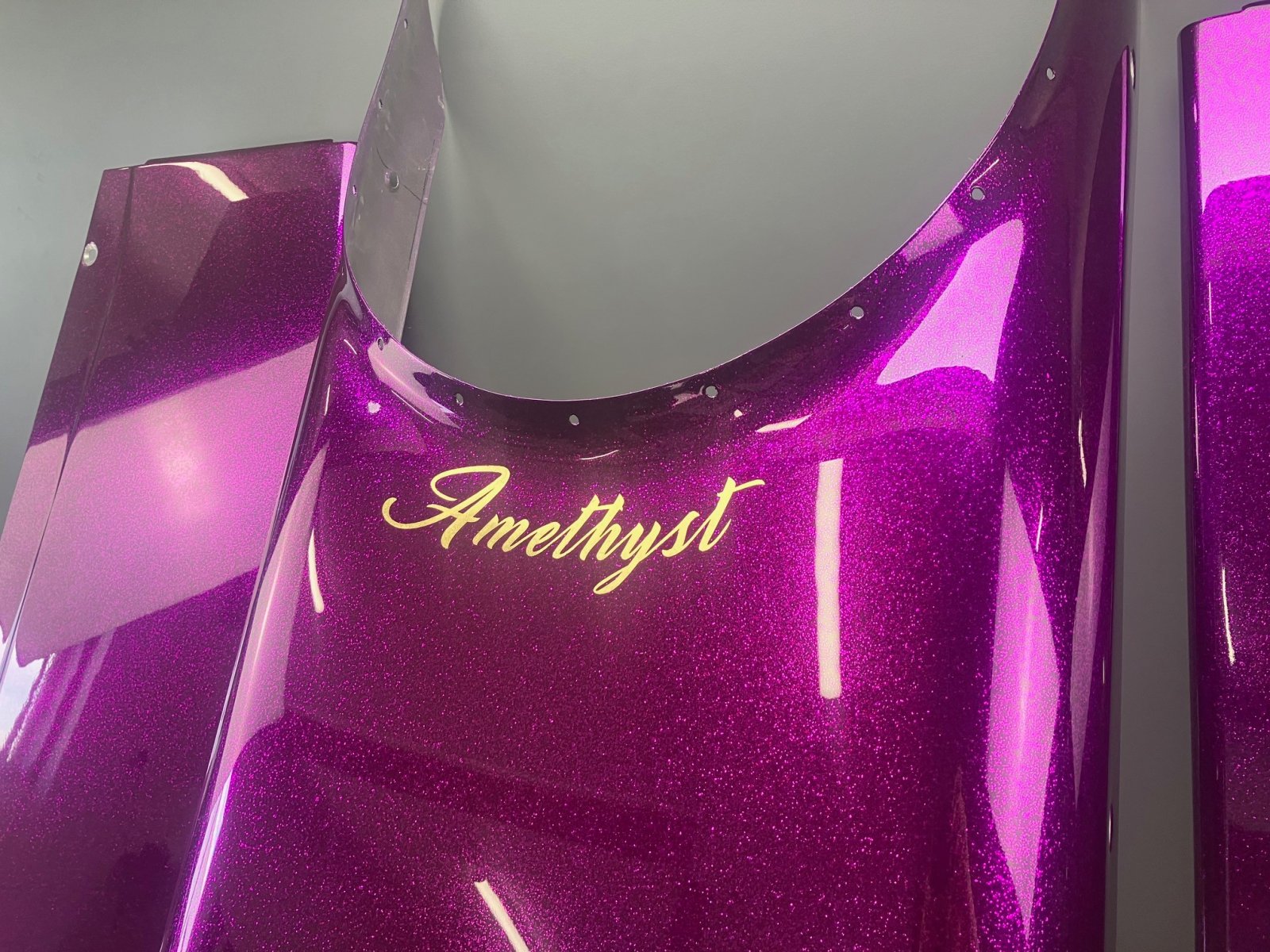

    I love the look of the big metal flake (monster flake?). I can't give you advice on how to lay down flake, but I can post some flake **** to encourage you to have a crack at it. These are the cowl and side panels for my FED.
    Cheers,
    Harv

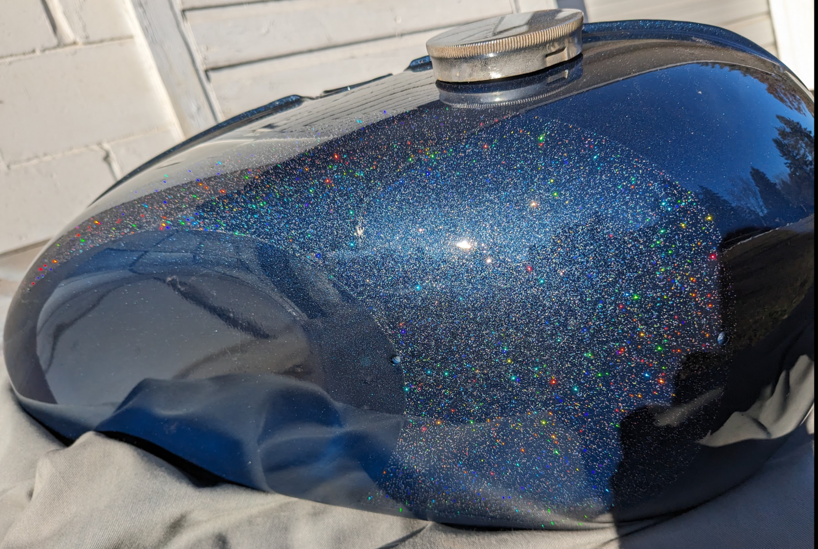

    Here's a Triumph tank I did. Base blue, flake in clear (original style graphics), a couple clear coats on top. All acrylic enamel. It probably should be sanded & buffed, but I don't care. Didn't even clean the shop first. Small jobs like this are easy, doing a whole car sounds daunting.
