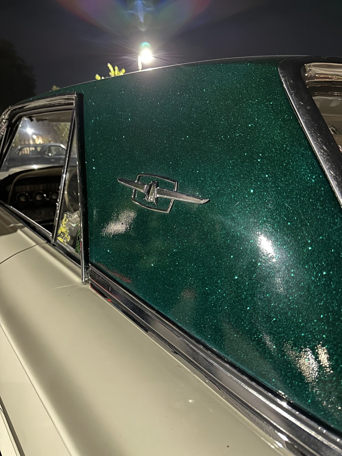

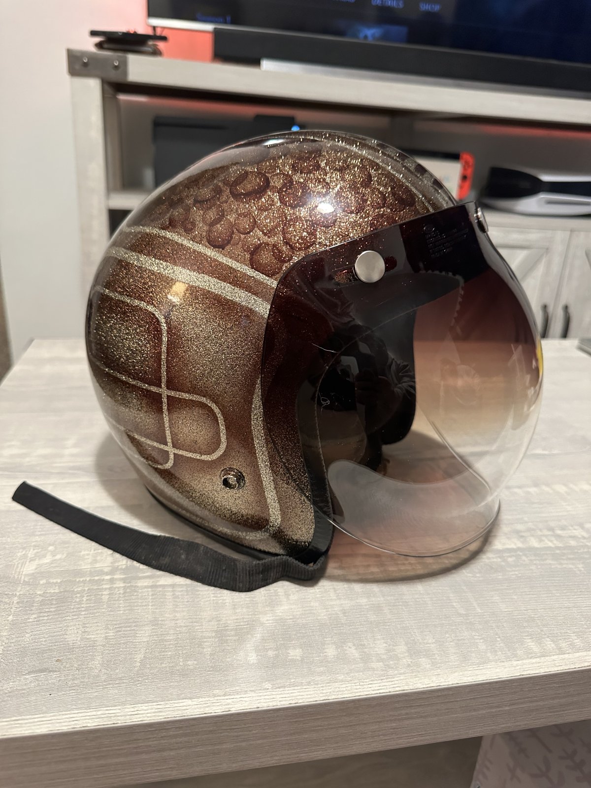

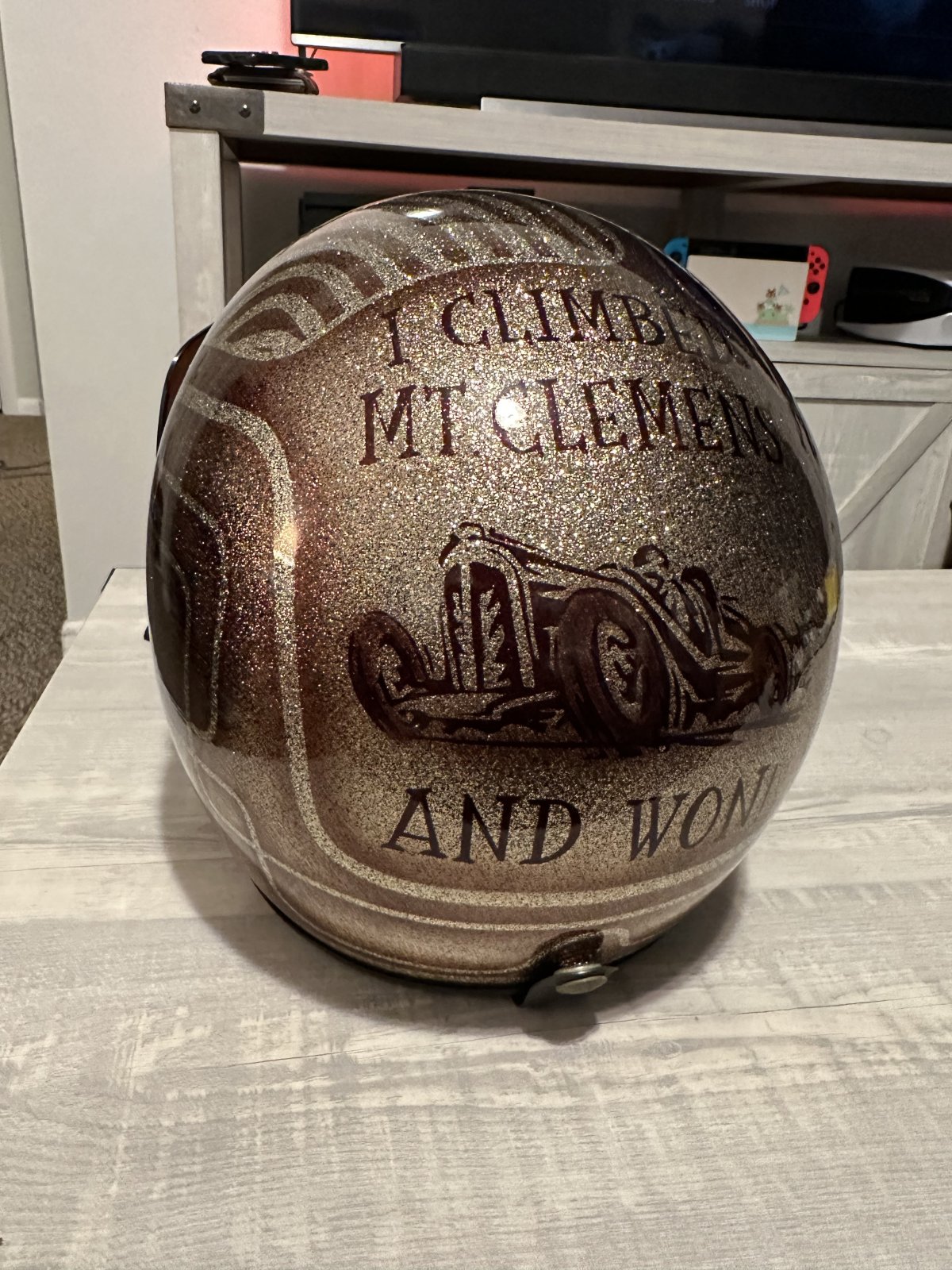

    I pretty much shoot painthuffer exclusively, but starter off with the ditzler big flake. 95% of the product PH sells I’ve successfully shot through my gravity fed Sata with a 1.4 tip, it gives you a chance to layer it without putting such heavy coats on. Second time I shot the roof on my 65 bird I ordered the flake king dry flake gun to shoot the 2lbs of crushed gl*** I had purchased. I very rarely go back to wet spraying these days because of how much I like the coverage. I do always use an intercoat clear in my base clear system. Remember that the technical sheets will tell you what the product is recommend for application wise. If it says you 2-3 coats you might be able to push it to 4 but trying to bury the flake can require an extra couple coats. As stated before you need to be able to flat sand the texture out for that gl***y finish without burning through the color or removing the flake. IMG_1097.jpeg IMG_1483.jpeg IMG_1484.jpeg IMG_1485.jpeg IMG_1509.jpeg IMG_1756.jpeg IMG_5529.jpeg IMG_2889.jpeg
