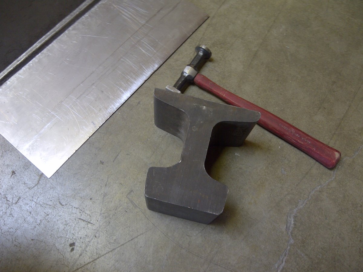

    I spent the first 10-years of my metal forming career with a Martin hammer and dolly set, and a chunk of cleaned up railroad track.
    I used this:
    (Yes, that close-quarters double-brake was made with a hammer, on the railroad track.)

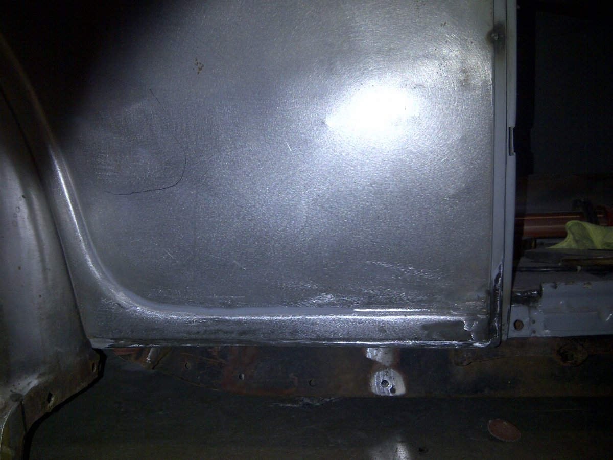

    To make this:
    It is the whole section, from the soot on the B-pillar, down. The weld-in was tricky.
    You don't need a garage full of tools. They might make your work faster but they might not make it better.
