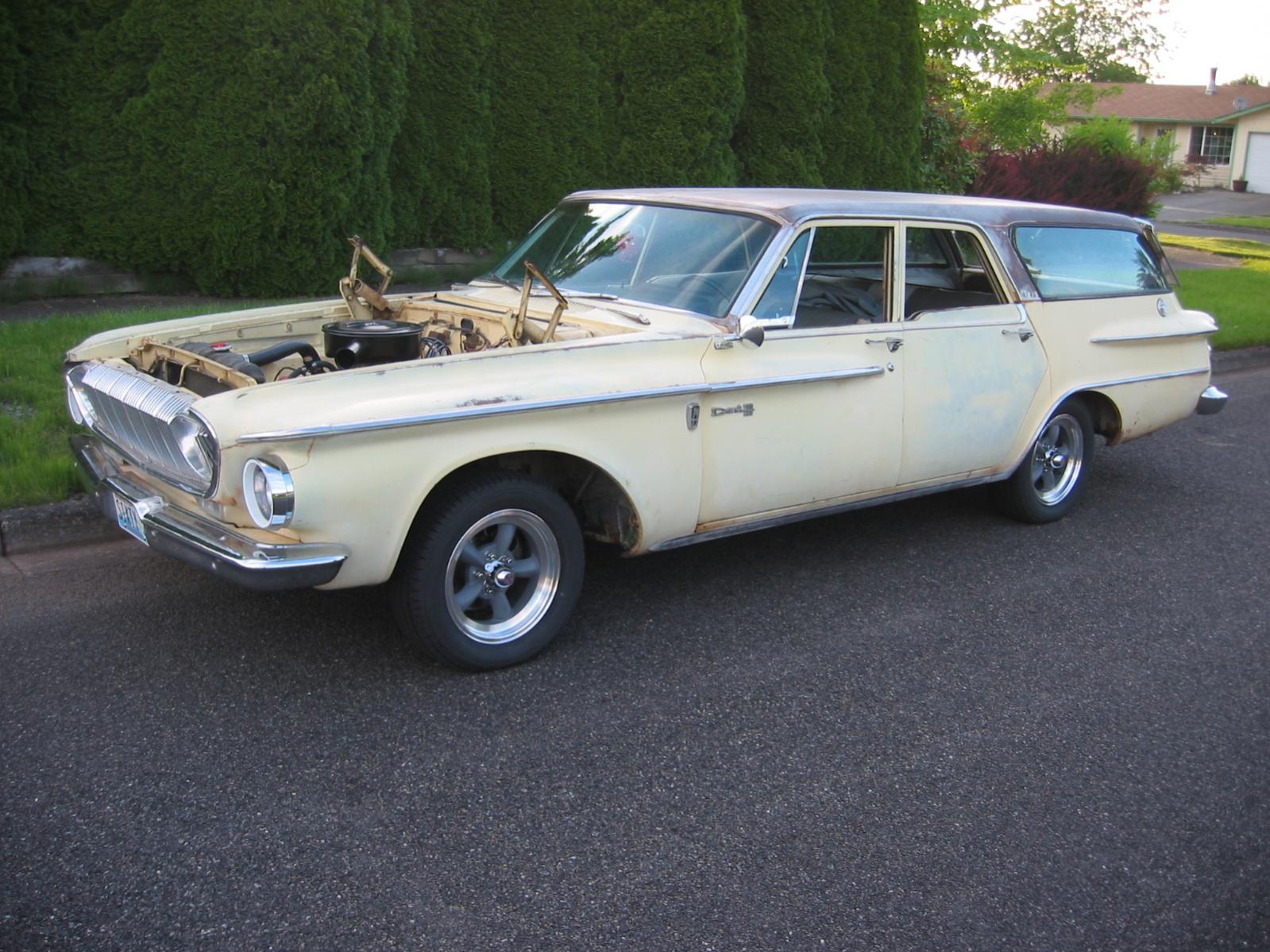

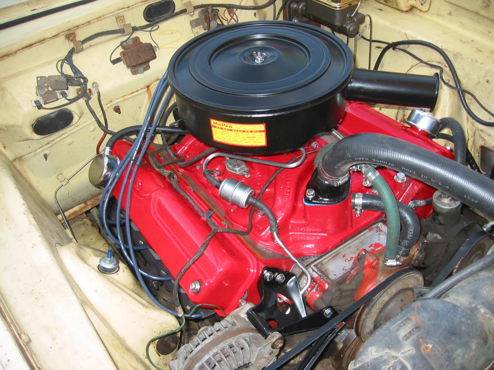

    I just installed the intake on a 318 Poly in the '62 Dart....... Good how-to article here.
    In the Fel-Pro intake kit was a small tube of black RTV. The instructions say to use RTV around the water ports, and use a gas proof sealer around the intake ports much like the article above.
    Instead I used Hylomar on all ports, tossed the foam seals and used Right Stuff on the ends.
    My next choice would be Aviation sealer, and if I had to choose an RTV for the water ports and ends, it would be Ultra Copper.
