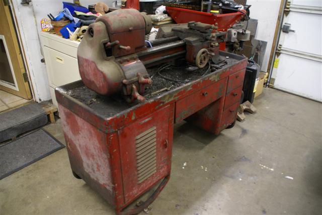

Metal lathe???
Discussion in 'The Hokey Ass Message Board' started by old wood 51, Oct 2, 2008.

    I was given a Logan 10" lathe a few weeks ago, all I had to do was haul it home. After some serious cleaning & lubing and tightening, it works like a charm. The bonus was when I broke into the drawers and found three like-new chucks, all sorts of tools and wrenches and a full set of collets. A super score for me!!

    A few things to consider, when was it last run, is it 3 or single phase, can you hold small parts (under 1" diameter), are parts available for it, what is the general condition?
    It would be a ***** to get it home and find that some feature of it is inoperable or the spindle bearings are shot, rendering it as a "clunker". If possible, get a machinist buddy (bribe him with beer and a free lunch) to look it over first. If the thing is still under power that would be a big help.
    If all checks out, think about getting a machinery rigger to pick it up and move it. Some really big machine tools can be broken if they're not picked up right.
    Bob
