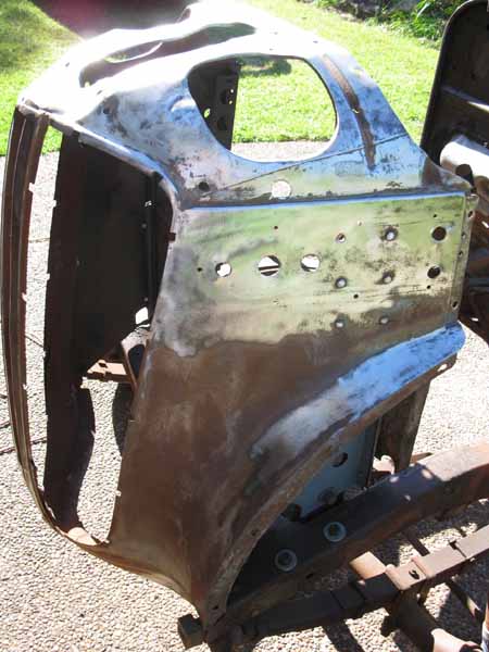

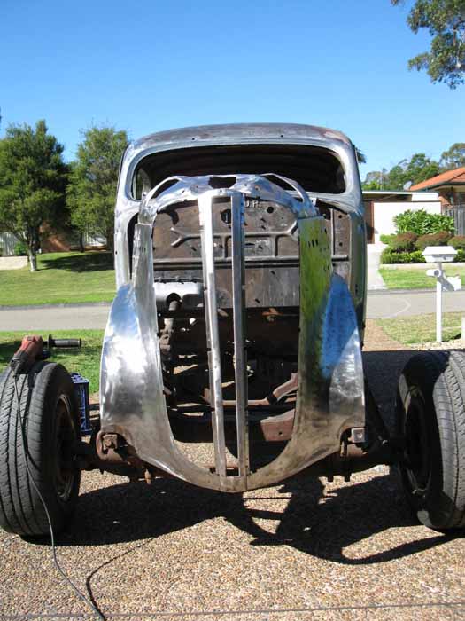

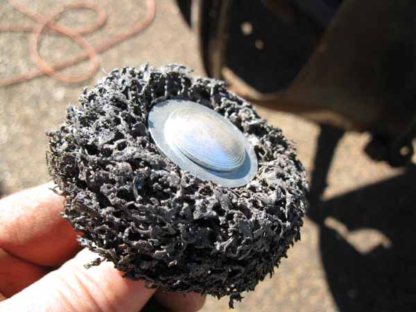

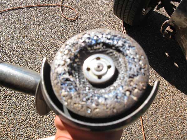

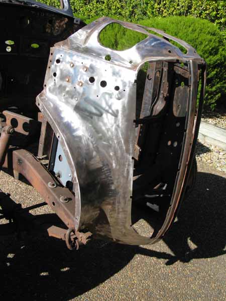

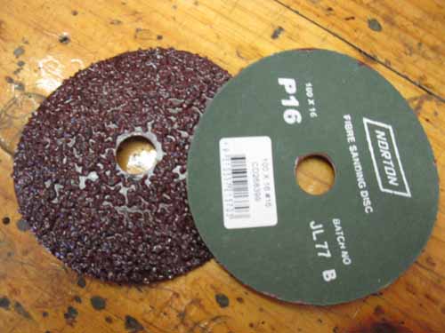

    Guys this may have been done to death, but here's what I found by my own experimentation.............
    No chemical/acid treatments for me, firstly.
    So, with that in mind, I went to the hardware store, and grabbed a few types of abrasive discs.
    I have a '37 Dodge 4 door sedan, the patina/rust on the roof is damn hard to remove.
    So, I have tried super coarse sanding discs; which do the job, but "dull off" well before the disc is dead.
    So I tried the poly discs, one made by 3M attaches to the drill, and some cheaper poly discs that go on the 4" angle grinder.
    Test piece was the grille shell.
    The Poly disc got me through half of the shell before it was used up. A good result, and the steel is bright with no "carving up" type of damage a sanding disc would do to the steel.
    So I try the 3M job on the other half. Well, what a disappointment!
    3 x times the cost, 1/3 as effective, 3 x times the effort to remove all the crap. Let's just say, this will be my first, and last 3M abrasive purchase.
    So, back to the hardware store for some more blue poly discs.
    I know the rust on the roof is hard to remove, so it is removed by degrees. First, I had to use the poly discs, get the rust off, the steel turned black, there were still lots of small "pock marks" in the steel. Followed up by sanding discs, 36 grit then 60 grit, then hit it with a fresh blue poly disc, I have silver steel to look at on the roof. I know, a lot of stuffing around; but no acid/chemicals used. I must be too worried about chemicals coming out of the woodwork after spending hard earned on a nice finish.
