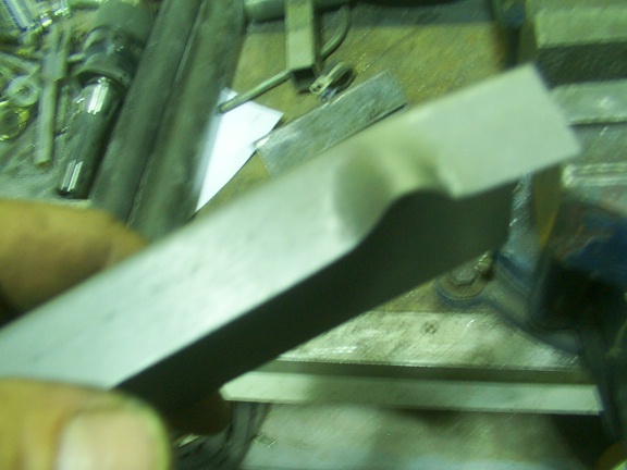

    I was making a metal repair on a door jamb and thought it would make a decent little tech piece that shows how to shrink metal with bsaic hand tools. I had already cut and cleaned the rusted area before it occured to me to create a tech piece.
    The repair was for the leading edge of the door jamb where it transitioned from the sill turning upward while leaving a perpendicular edge to hold the gasket.
    The pics are not high quality, shop camera you know, use them along with the description of what i'm doing.
    The first 3 pics show the rusted area; the sheet metal marked to bend; the bent piece with the vice and the two hammers i used. Vice and hammers all all the tools you need to form the sheet metal. I don't know the proper name for that body hammer, some kind of a verticle blunt chisel but that is what is used to make the tuck.

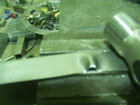

    To make the tuck i open the vise jaws to 3/4" or so and use the chisel end to make the bend, you don't want to hit so hard to tear the metal - just get it humped up. I close the jaws to about a 1/16 or so and slide the piece in as far as the bend. I pull the metal to accentuate the bend while tapping with the ball peen on either side and guide the bend to keep it straight.
    I open the jaws and slide the sheet metal in far enough to support both side of the bend. With the ball peen strike the peak at an angle to drive a flat lip into the front of it. The pic showing this has reflection on the formed lip. When you've formed this lip you can just pound it on thru and down (if you don't create this lip you won't be able to shrink, you'll just be pounding a bent back flat, got to have the lip). The last pic shows how much you shrank it with just i tuck.

    Just keep working around the flange, keep the tuck hieght and distance apart consistant and you won't have radius issues. When you start trial fitting you can then deal with the radius. The tuck size i demonstrate is just an easy one to work with, experiment with tighter, wider and deeper tucks - once you get the concept you can really take off with some of this stuff.
