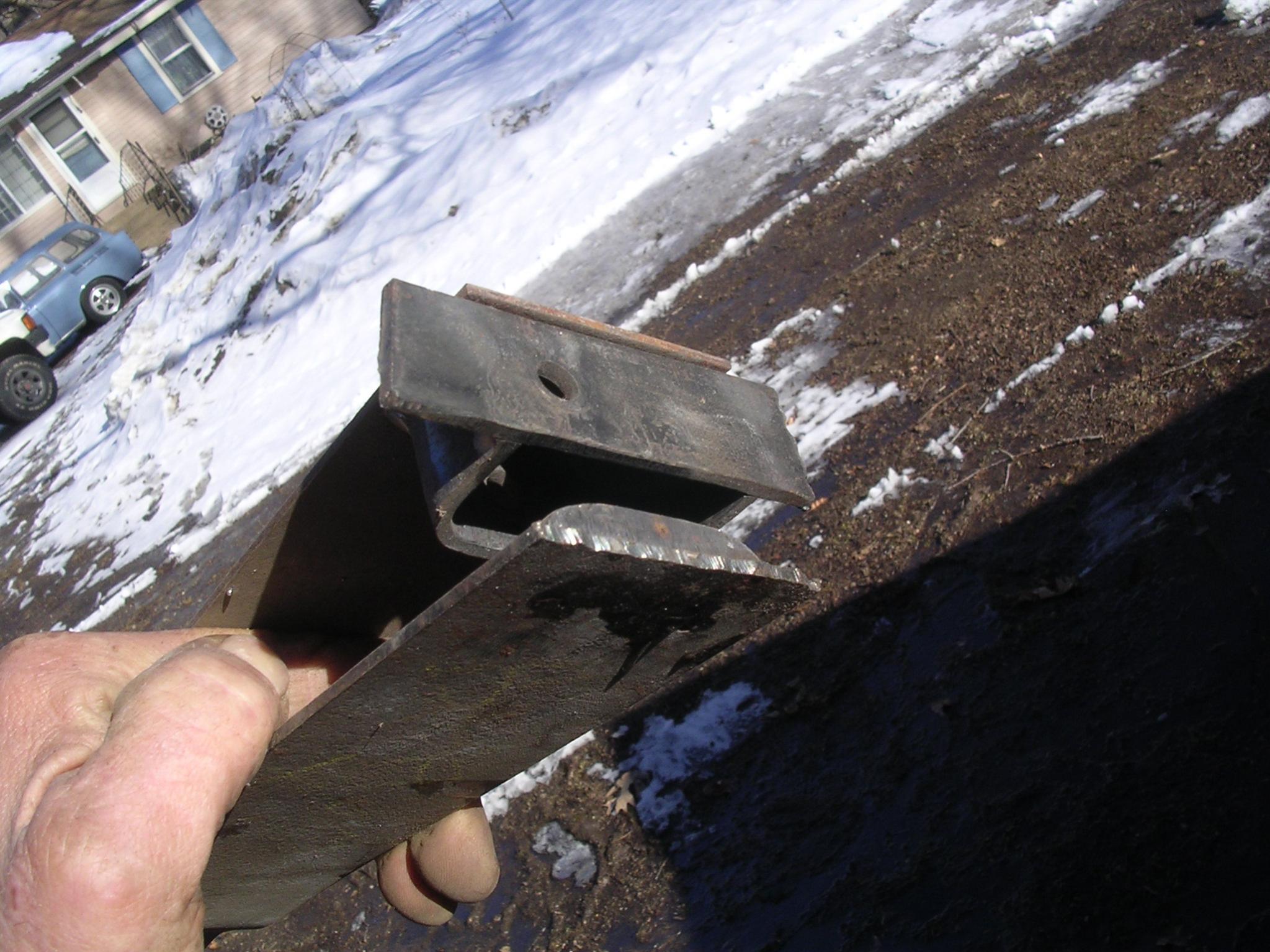

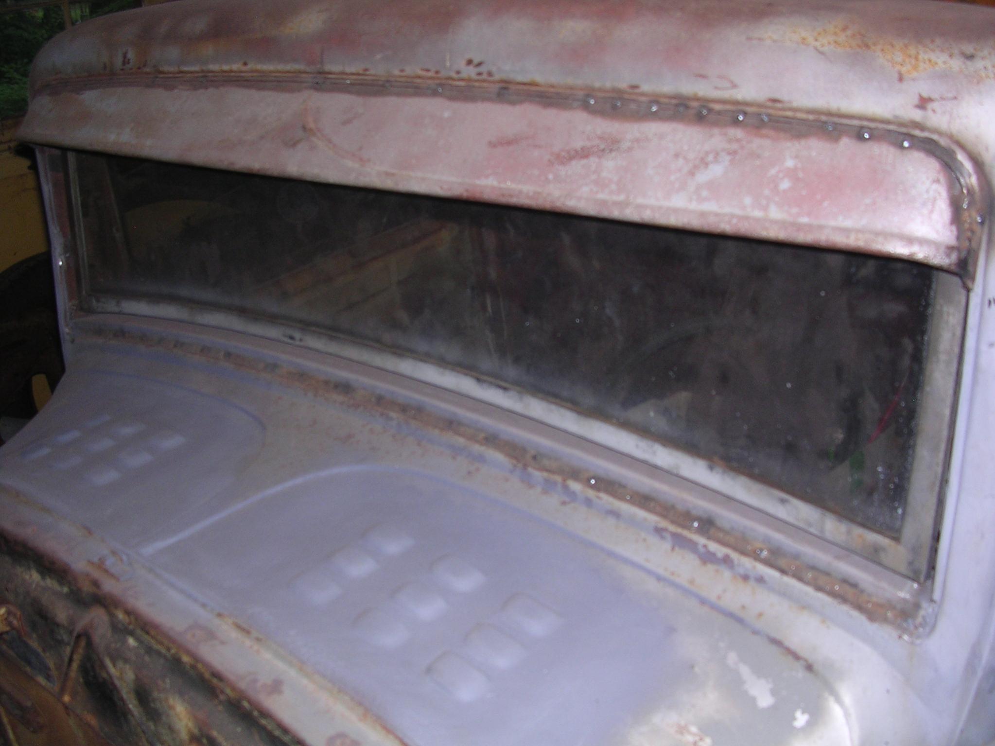

    Someone asked to see the simple louver die I made for use on small panels in a big bench vise.
    It is hinged like salad tongs, with a welded end on two 1/8" thick alignment plates. I was going to use a house door hinge but those have slop. So I welded it.
    The female die is just 1/8" thick band steel standing on edge in a D shape outline, welded to one alignment plate.
    The male die is 1/4" thick hand ground to shape. I drilled 2 holes through the other alignment plate so I could plug weld to the back of the male die piece.
    I was not pre-slitting the louver openings; if I knew how to pre-slit real accurately on each louver, it would be better and last forever. It did start to dull at the cutting edge as I finished the two cowl panels
