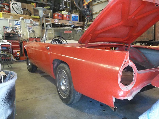

  1. As some of you know I'm rebuilding whats left of a 57 T bird. I've hesitated to do a build thread, as it is neither a rod or custom. Quite a few folks have asked about it, and I've posted a picture or two. This thread will be more of a "what I did in the shop today" thread. I welcome anyone to add whatever metal repair or shaping they are working on. If the moderators feel it's too of topic, please delete it. I'm not sensitive :D
    I've learned more on this car, than any others in a very long time. It's been fun, the owner understands that I'm the guy saving it, not the one (many actually!) that ****ed it up. You'd be surprised how many don't really get that. It's also my last. I'm excited. After this I get to use what I've learned over the years for my own selfish pleasure ;) I'll start with what I started with & what I did today, and randomly throw in older stuff.

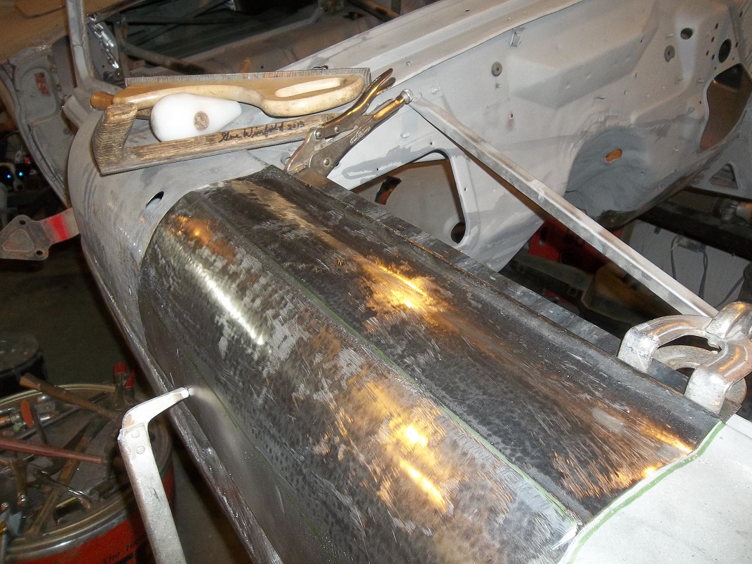

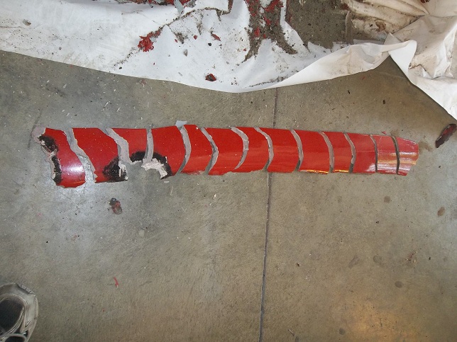

  2. I made the patch for the top of the fender. I broke the piece 2 inches from the edge, to allow enough metal to make the flange that welds to the inner fender. The fenders are welded on the body rather than bolted. The edge that meets the hood has a slight curve. I couldn't fit the 2 inch flange in my shrinker so I used a variation of tuck shrinking. Notice the high tech machinery involved!

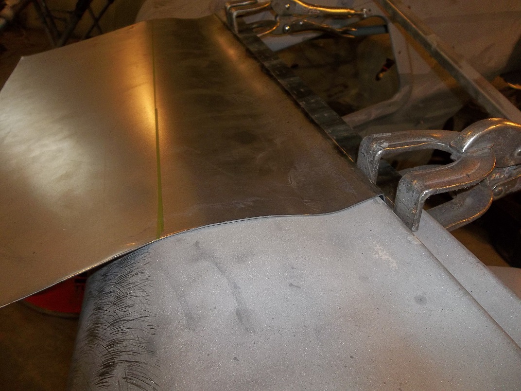

  3. I guessed at the amount of crown I'd end up with after flattening the tucks. I heat the ridge, and hammer towards the tuck to capture it. I ended up with what looked to be about the right amount of crown. If you get too much, you just hammer the flange against steel to stretch it back out. If you need more just repeat the tucking. Then the basic curve of the top was made bending over sections of pipe.
  4. I marked the center ridge, and made the "line" with the break. More curving over the pipe, then fitting and adjusting with my 100.00 planishing hammer. Fine tuned and smoothed with a small E wheel.

  6. With the piece clamped in place, I filed it with both a flat and rounded file. Bumped down some high spots, and filed some more.
    Tomorrow I'll do a slight bit of bumping and filing and weld her in.

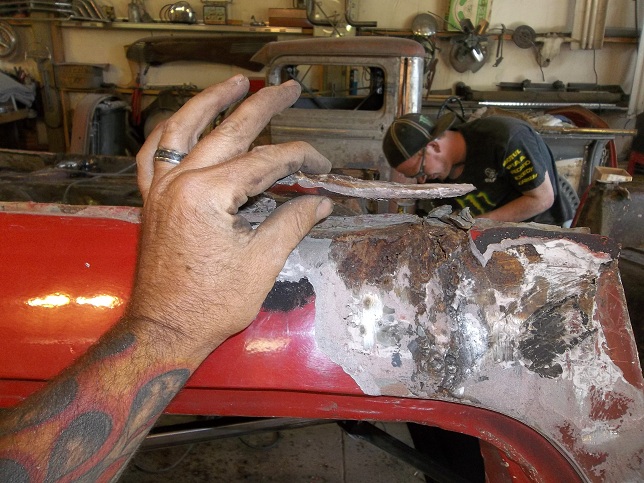

  10. Thanks Squablow. Yeah I was surprised at both the lack of repo parts available, and the horrible quality of the pieces we did get. I've made most everything, and should be able to fabricate the few remaining pieces.
    It didn't look too bad when it came to me. Once on the hoist, and as we got it down thru the four paint jobs, It looked bad. Each step from there was worse! The car was from Alaska. It had been hit pretty hard in the drivers side. The wheel houses were still pushed sideways. 1&1/2" on the left, and 1/2" on the right. Both quarters had been replaced, over the top of the damage. Then of course things were bent and bashed to get it to "fit". :rolleyes:
  11. Nice job gicknordon! I built an F1 before the bird. Love those trucks!
  12. The wheelhouse was actually a very easy fix. Too bad they didn't figure that out when the quarters were changed.......the first time :D
