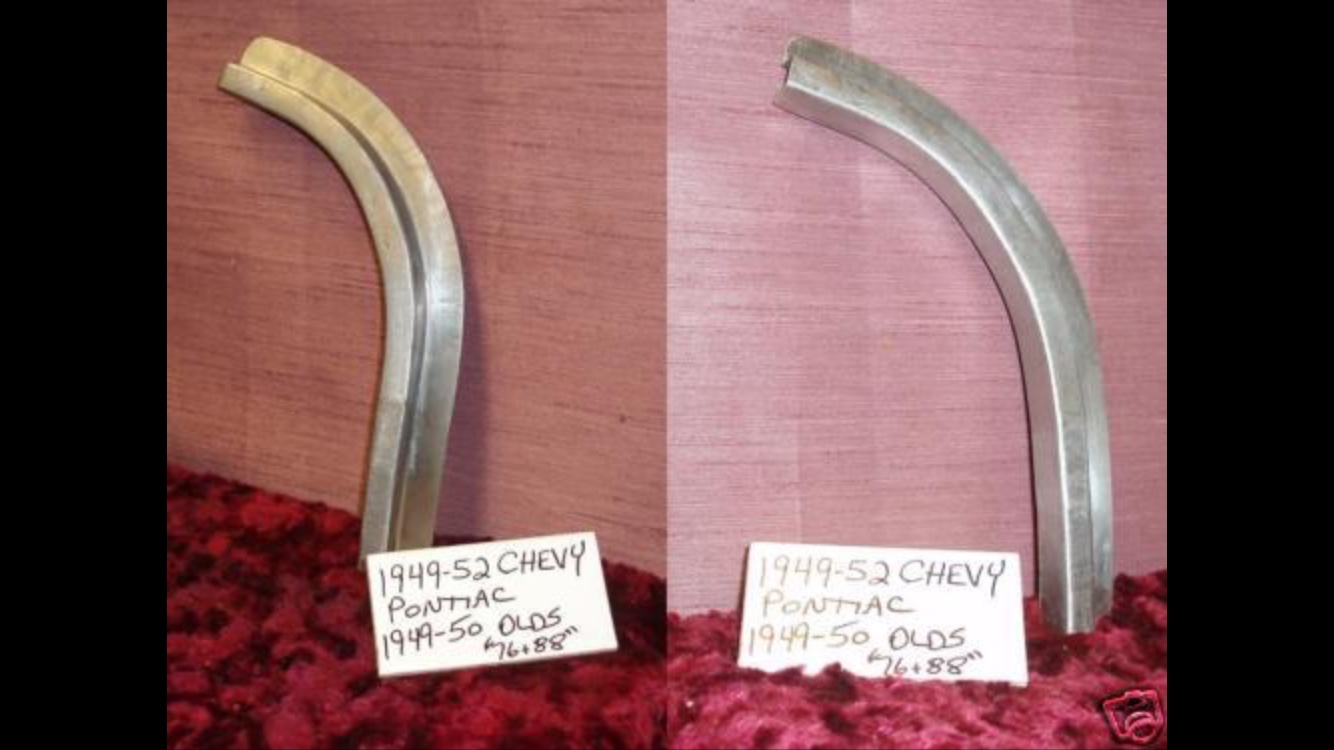

    Hey all,
    I know a 90° can be curved easily with a shrinker stretcher, but how about a compound series of 90° like this dogleg? A single dude in a shop makes these... for relatively little considering it's producing many... how does he do it?
    Thanks [​IMG]

  2. cretin
    Joined: Oct 10, 2006
    Posts: 3,059
    cretin
    Easiest way is 2 pieces that have been stretched or shrunk, welded together.
    Looks like that could be the case here, but hard to tell.
  3. Happydaze
    Joined: Aug 21, 2009
    Posts: 2,381
    Happydaze
    Looks to me like he'd start with a Z profile and then be progressively and continually alternating shrinking one leg of the Z and stretching the other leg. I'll bet he has 2 machines, else most of his time would be spent changing dies! The stretching could be hammered I guess, but the machine would afford more control?

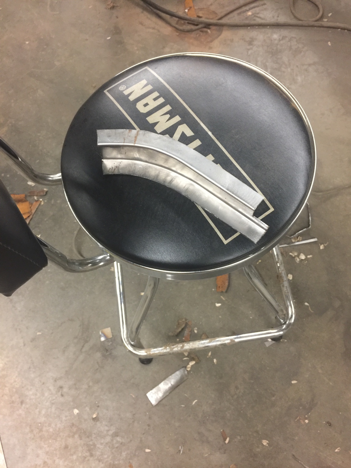

  10. jackalope
    Joined: Mar 11, 2011
    Posts: 692
    jackalope
    Hard to tell the size but the first piece could have been through a bead type roller with a stepped die and then shrink stretch.
    Made a similar piece yesterday.

  12. drew1987
    Joined: Nov 22, 2015
    Posts: 682
    drew1987
    I am learning fast - thick steel fab and "engineering" parts that work is my background and as I work more toward sheet metal and body work/ ornate fabrication, every night in the garage is new info. For example, when I made my fresh air heater (pardon the link of the site hope it's not rude if so I didn't think it was http://www.chevytalk.org/fusionbb/showtopic.php?tid/339839/) I learned how amazingly I can move and shape metal by taping with pieces of 1 1/2" thick wall round and square tube. That will be huge for body work.
    When I was building my semi concealed radio and didn't wanna move metal to close a small gap, I used a strip of sheet metal 1/8 thick as filler rod with MIG and got s gorgeous well across the gap.
    So I am learning, had a fellow H.A.M.B.er locally show me some stuff that helped.
    I want to know more about what you said - let's say a 1"x1"x10" 18g sheet metal 90°.... could you get a nice 1/4 circle out of it for like, a wheel well or dog leg using a table? If I see it done I can do it

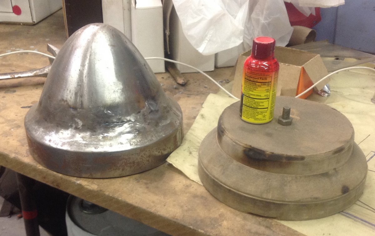

  13. Sure, but a shrinker/stretcher would make quick work out of that task.
    Hammering the edge would make it stretch, but that's LOTS and lots of hammer work.
    Making "tucks" and hammering them in wound make the edge shrink, but again LOTS and lots of hammer work. You could make relief cuts and weld them up too. You could make that from 2 pieces,1 cut to the curve and another to make the edge. You could also make a "hammer form" and beat the edge down forcing the metal to go where you want it, this would require a larger piece of metal and then t******* the 1/4 circle out of it.
    All in all 1x1x10 into 1/4 circle is Less than 10 mins work with a shrinker/stretcher tools vs hours upon hours and thousands of hammer swings.
    These buckets are from 5 pieces.
    Made a wire skeleton for patterns.
    Used the shrinker on all 5 pieces, used the E wheel on 4 of them.
    Hammer form for consistency of shape and to hold it together for welding.
    Hand planishing welds over a trailer hitch ball and oxygen tank cap.
    Took about 8 hrs for 2.

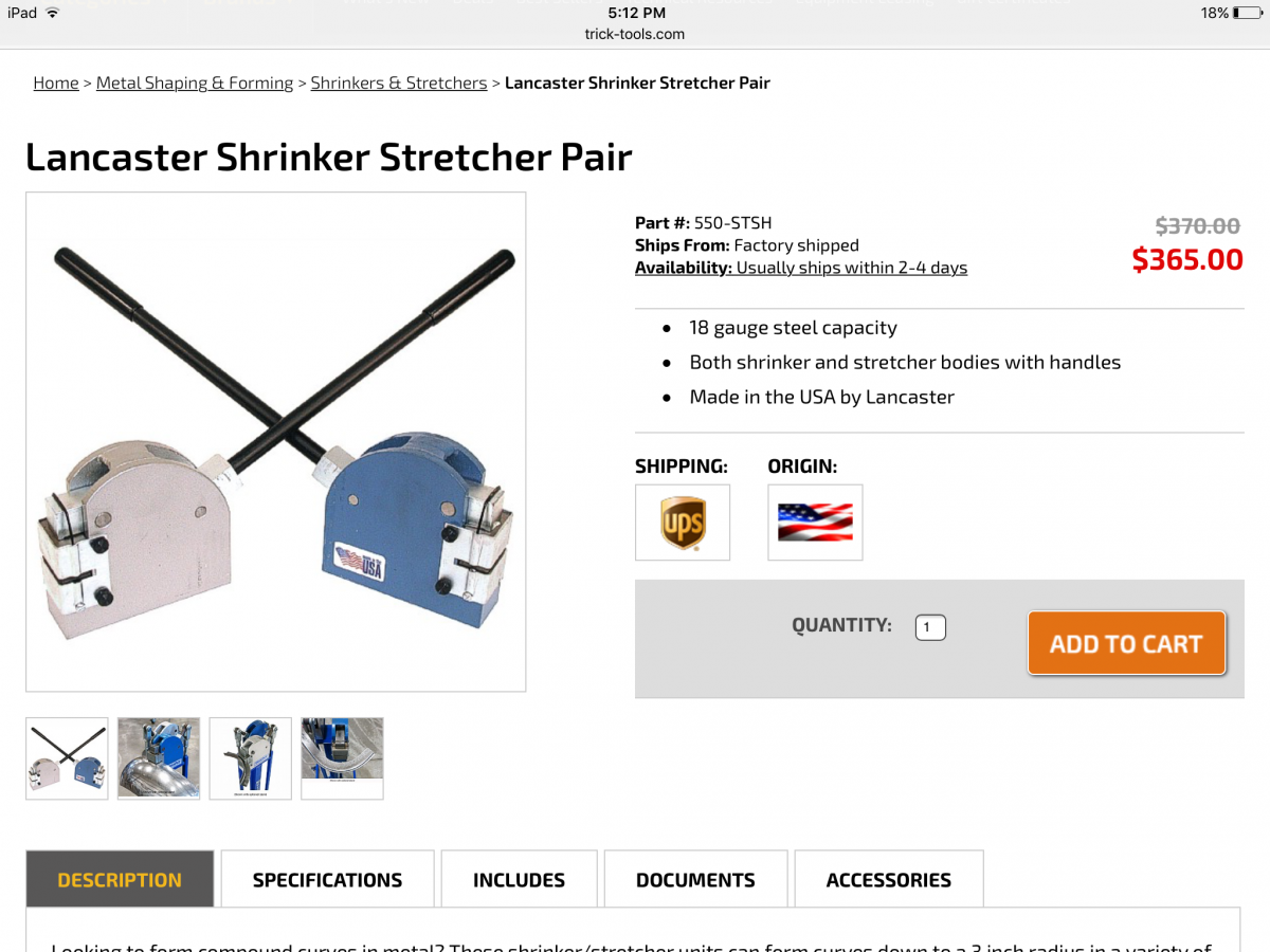

  15. drew1987
    Posts: 682
    drew1987

  17. The pics should get bigger if you click on them.
    HF has them on sale, the stand is ok but the Legs are flimsy.
    After a thousand strokes you'll need to redo the pedal pivots.
    Then if you want a quality tool theses are way better.
    You probably won't notice the difference until you get used to one then try the other.
    It's a quality original vs cheapest bidder copy and no contest.
    But they cost almost 4x as much

    Get the shrinker/stretcher! I had a band saw for a while, and now its gone. I cut with a sawzal, cut off wheels, or a plasma cutter, and clean up any edges that need cleaning up with a grinder, or a flap disc on an air sander. But I seldom large diameter solid stuff. Gene
  19. jackalope
    Posts: 692
    jackalope
    I agree with Gene on the bandsaw for car related sheet metal work. I have a Roll-in vertical and DoAll horizontal and they are useless for car related stuff. Much more useful in heavy production or fabrication projects.
    I bought some cheap Eastwood shrinker/stretchers awhile back. They are not the best quality but they do the job. Just need to be patient and/or make the return spring modification. Basically HF stuff.
