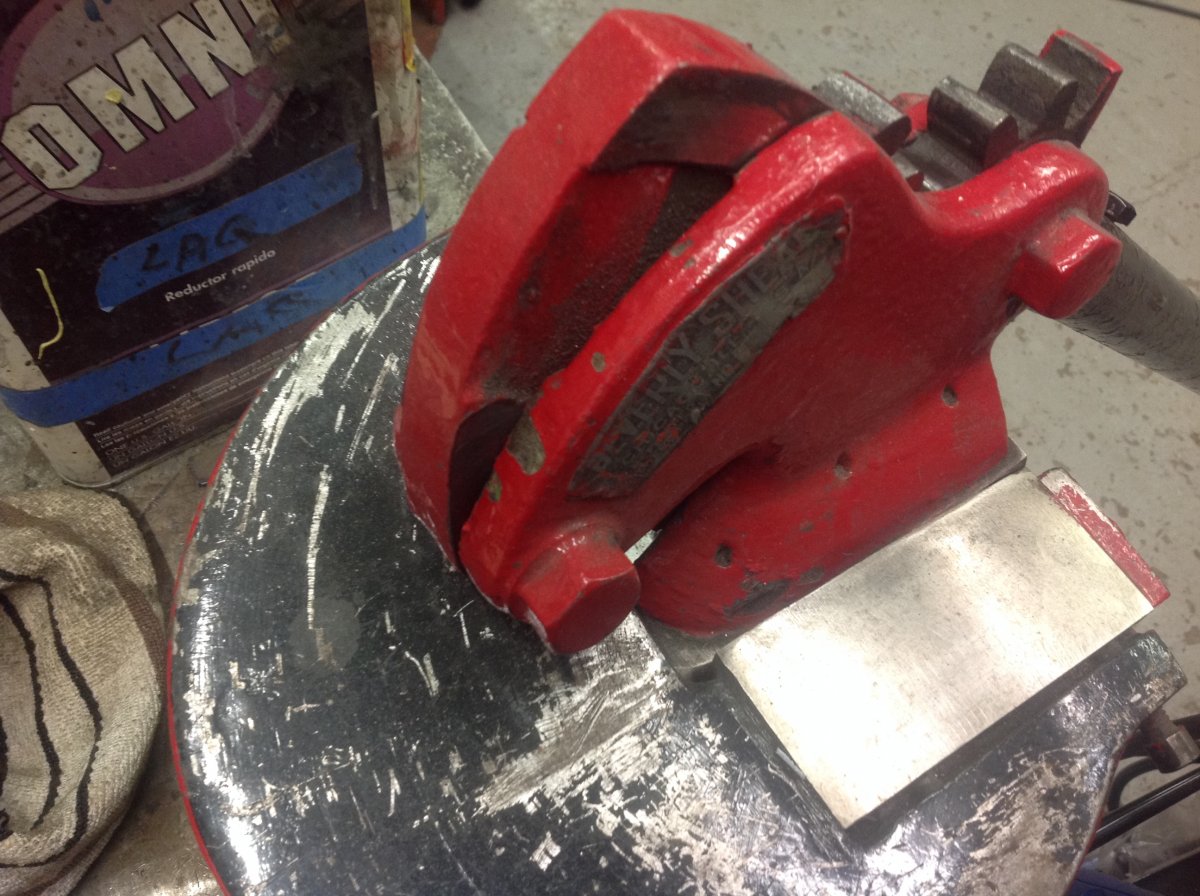

    The biggest problem with the copy cat Beverly shear is not the blades, it's the pivot mechanism and guide system for the moving parts and the drive gears. Blades can be sharpened easy enough. When cutting with a shear, snips or even sissors the blades can't be slopping around at the pivot. If they do your wasting energy dragging edges and really just smooshing metal thin enough to rip, not cutting it. Click the pic and it should get bigger .
    image.jpeg This thing is older than me and you put together and has been worked hard and it still works way better than a brand new chinabrand copy. I don't now what a brand spanking new Beverly feel like but I can't imagine it getting much better. I got lucky, because I was kind to someone they gave me this Beverly. As far as I can tell from cruising alibaba.com is that there's one company in China making them for everyone who sells them, HF, EW, BI, just different paint jobs and different retail prices. If you care to order 100 of them they will paint it the color you want then you can sell them too.

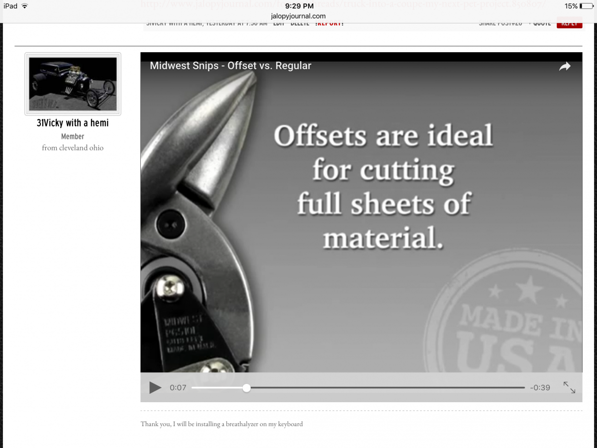

  11. Did you watch the video I posted about using snips? It's all explained there.

    K13 you know… I started to, got about halfway through it, I got sidetracked, and must've forgotten to finish it! I'm going to finish it now.

    The video was very informative but basically told me that the snips aren't for going across the middle of a large peice... that they are rated for 1/4" cuts off edges. Don't know if this is different with the offset ones

    K13, Thanks for the snips video. Very educational and worth taking the time to view. As a hobbyist I basically trade my time for money I would otherwise have to spend on the more expensive tools or to hire someone to do the work. Since I like doing all I can at home,this allows me to spend more money on parts that I cannot make for my projects.

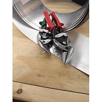

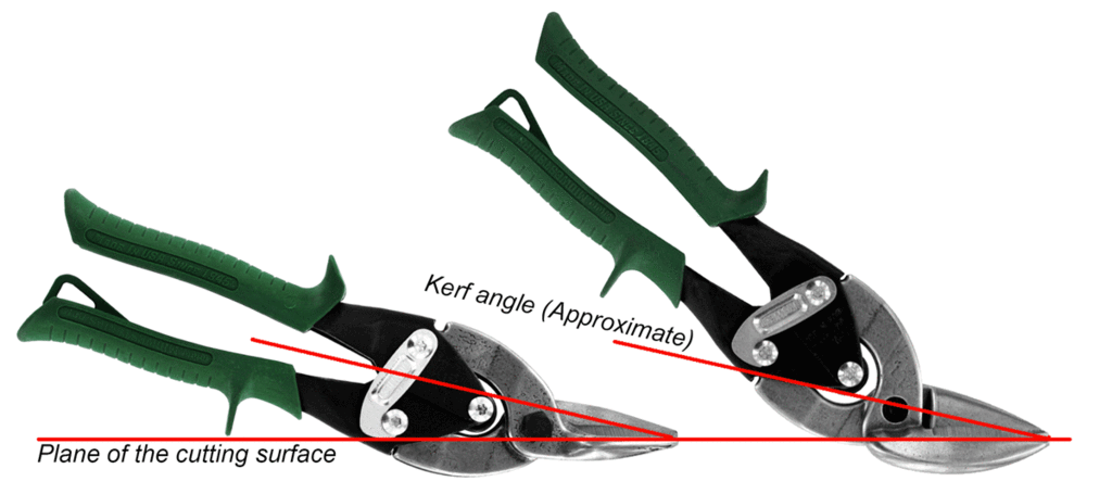

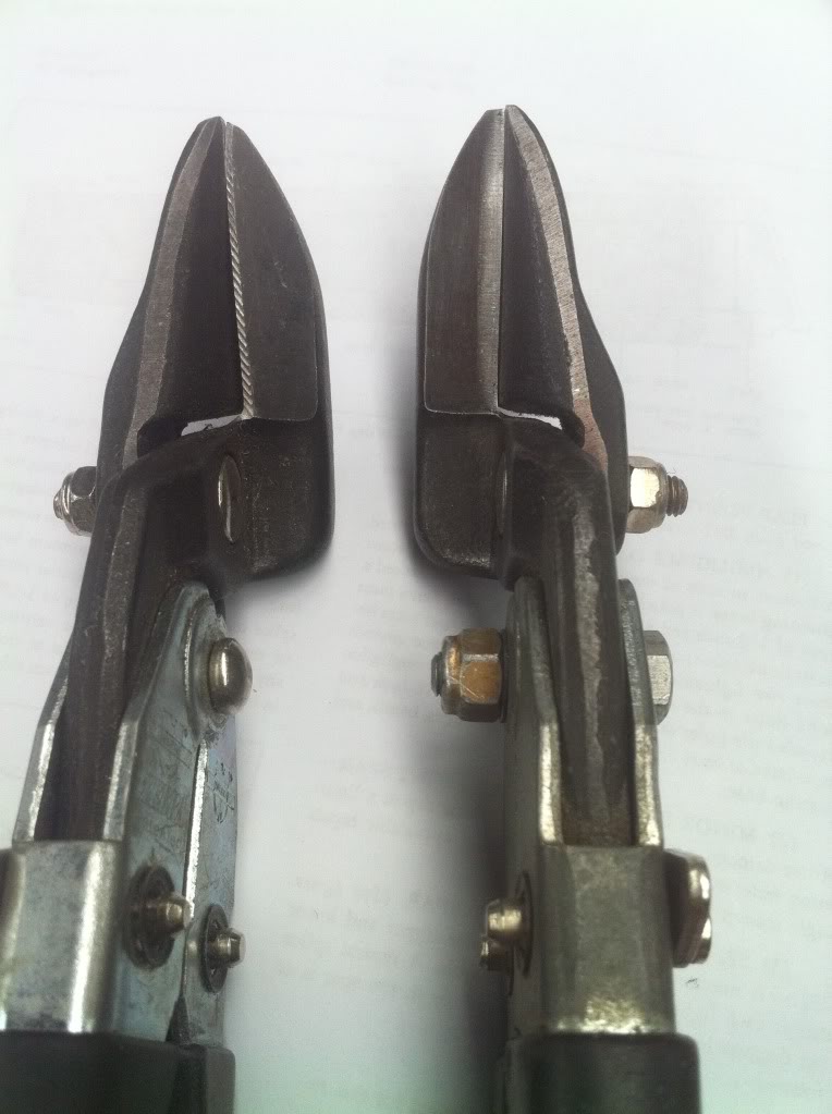

  26. Aviation snips ^^^^^ fit that description
    The blades are offset, that's why they are called offset, Unlike aviation snips. The handles are angled to the blades to keep your hands out of the full sheet your about to cut thru.
    Those are aviation snips
    Not true.
    These are offset snips. Study the blade configuration
    They work hand under or hand over the sheet.
    They will trim down to thousandths (0.02) or rip thru the middle of a sheet.
    Did you watch the video I posted?
    Go back, pause it at 0:06 seconds read it 3 times slowly and give me screen shot.
    Should look something like that.
    Both of these snips will get your knuckles off the sheet. Only one is offset.
    The ones on the left are aviation snips and work well at trimming.
    The ones on the right are offset snips
    Both offset snips. Left and right.
    Aviation snips.
    Waste to the right, straight and waste to the left.
