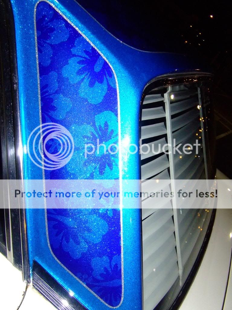

  12. My wifes roof as painted by Mat Egan of Extreme Designs, Melbourne.
    Another photo one of a mate-BadNews31
