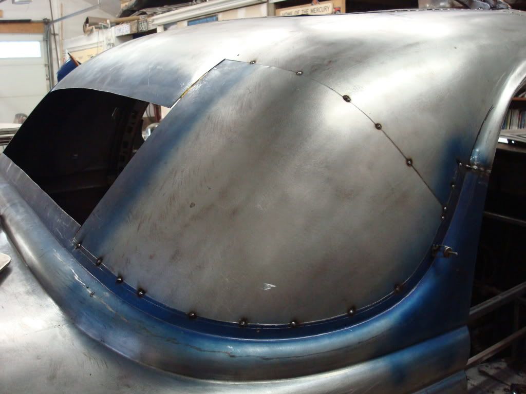

  8. cretin
    Joined: Oct 10, 2006
    Posts: 3,059
    cretin

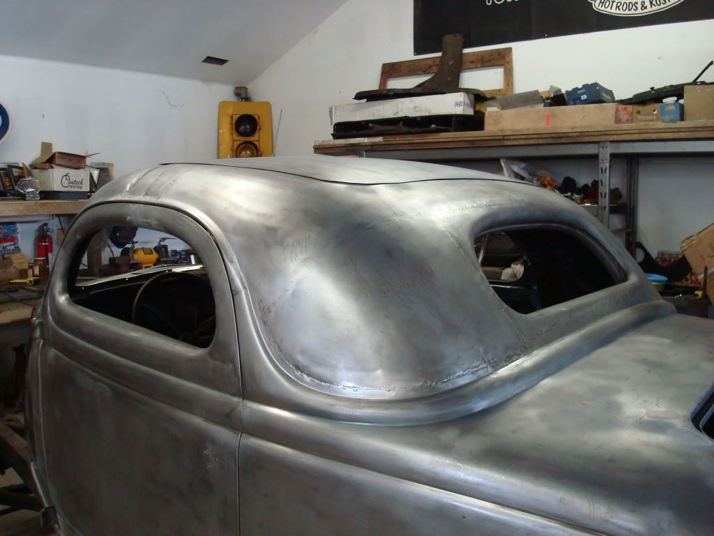

    This is a 5 window I chopped back in 2012. This is how I handled that area, hopefully this helps.
    I tried to cut through the apex of the curve, and had to cut up pretty high to eliminate the pucker.

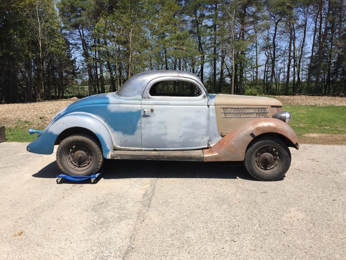

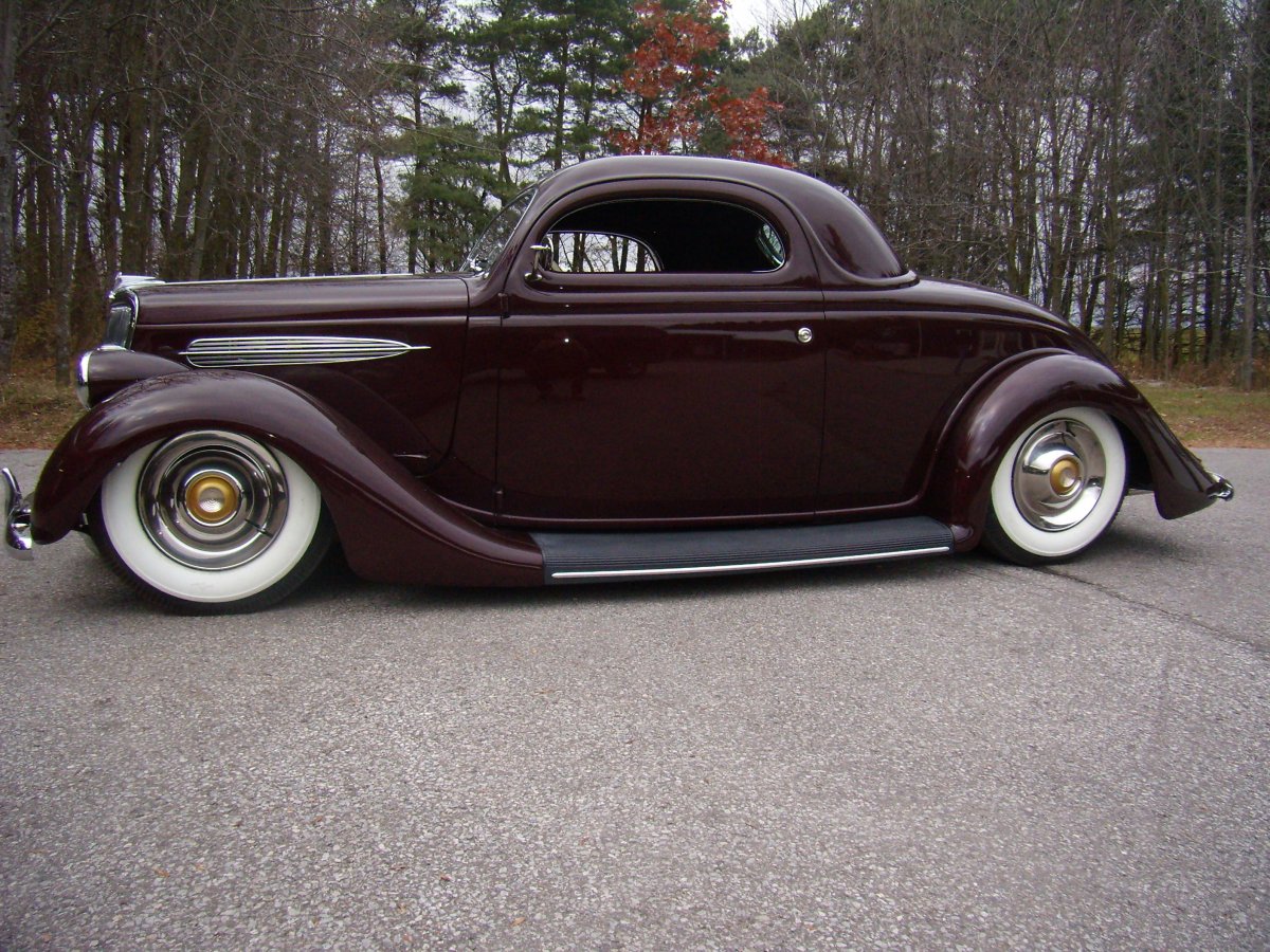

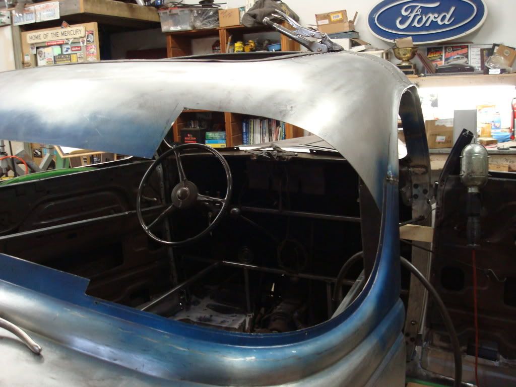

    I've cut two '35 three windows, in both cases I did it this way:
    -cut the entire rear corner of the top out, leaving a strip above the body line.
    -remove desired amount at door opening, in this case four inches.
    -cleco the corner in place.
    -tip the lower edge forward to match the slope of the corner tail.
    -scribe, cut, fit, tack and weld back in place.
    -repeat other side.
    If you can, tig weld all areas of the skin, this makes it possible to shape the panel with hammer and dolly.
    Mig welds are hard and tough to shape.
    Hard to describe in words, hopefully pics show the process. Both cars had the rear window replaced with a sedan piece, you could use this approach while retaining the original window also.
    JStGchop23.JPG JStGchop21.JPG JStGchop22.JPG JStGchop29.JPG JStGchop65.JPG JStGchop 001.jpg

  17. Halfdozen
    Joined: Mar 8, 2008
    Posts: 633
    Halfdozen
    In my opinion, a successful chop requires planning- know where and how much you're going to cut before you start. Here's how I do it: make one inch checkerboard strips with cardboard and a sharpie, stick 'em to the car, take pics, cut up pics till you like the shape of the profile, read resulting dimensions off the cardboard strips.
    I agree with 31Vick, I don't like small slivers.
    I can't stress enough that IMO tig welding is the best way to do skins. Oxy acetylene would be second choice, especially with a Dillon/ Henrob/ Cobra torch. Keep the heat affected zone to a minimum- ***** JOINTS ONLY*. Remember that anything you weld WILL SHRINK to smaller-than-original dimensions when it cools. Hammering the weld on-dolly after it cools will return it to pre-welded shape.

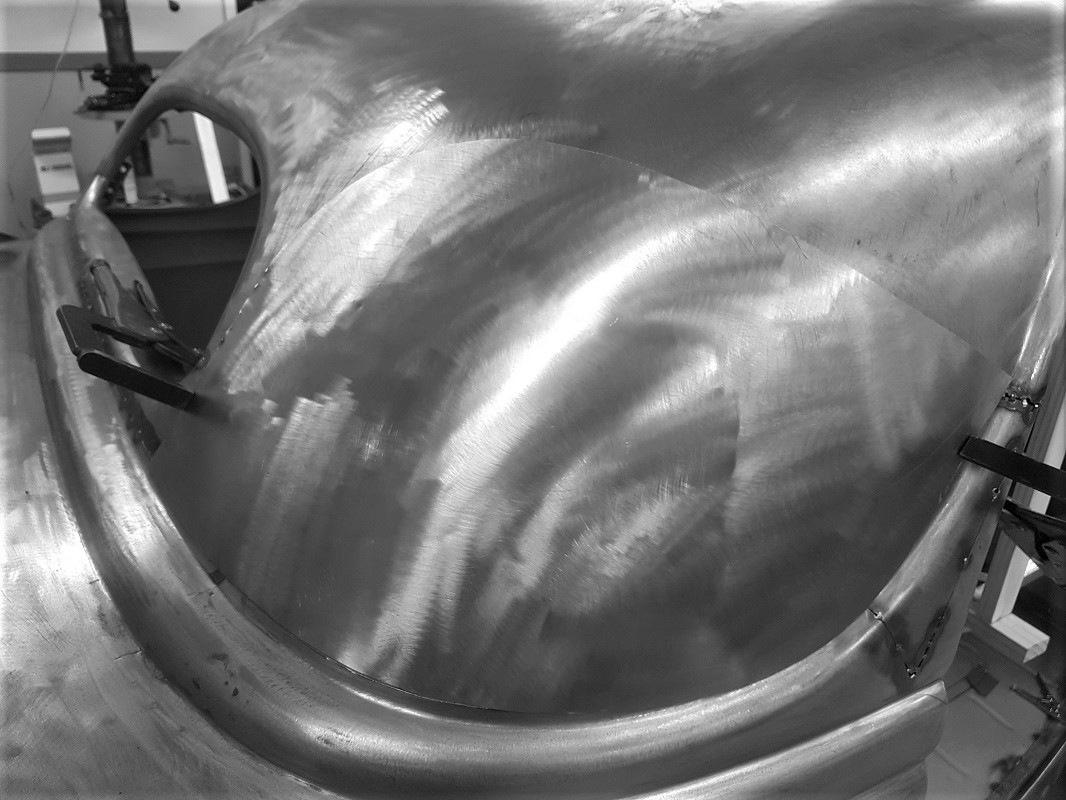

  21. Surf City
    Joined: Mar 5, 2012
    Posts: 469
    Surf City

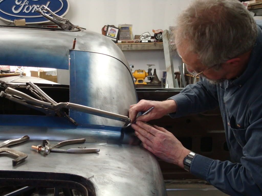

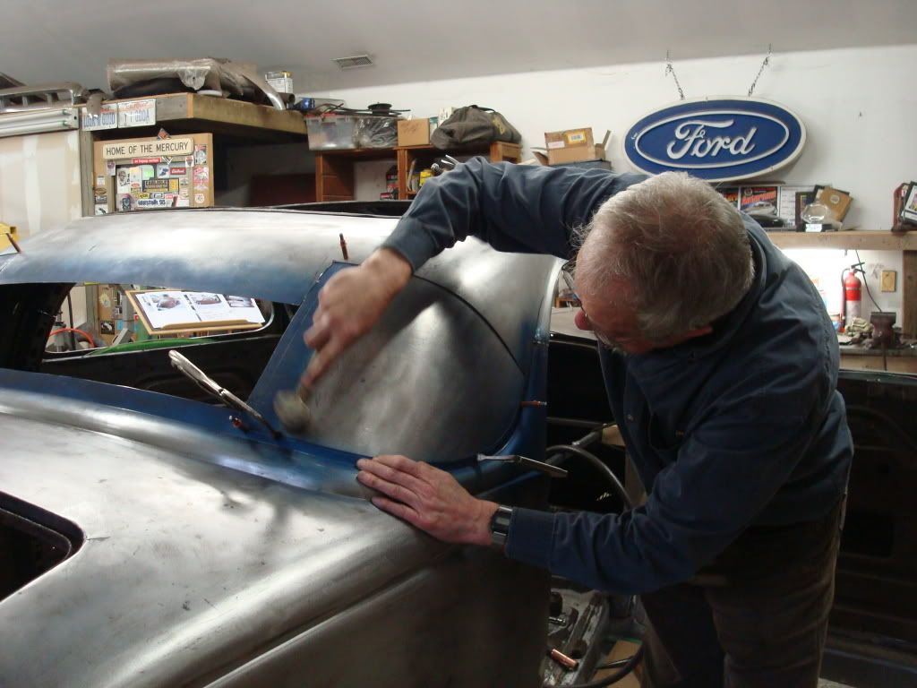

    So I ran a profile gauge over the rear pillar area and figured out where the curves were the most consistent, and marked out some cut lines, then carefully cut off that section with a thin disc, (bearing in mind that all of the original rear pillar material was still attached, just hanging down inside the body, prior to this cut).
    I sat the removed piece out and over the hole sliding the patch up so that the lower edge was almost back in it's original position ( there was now around a 3 1/2" overlap at the top which was going to make it difficult to tightly fit it on the inside of the rear pillar). Once I figured out how much material I was going to need, I rough cut the top off the patch, giving me about 3/4" extra panel to work with.
    Then I test fitted it on the outside once again, checking that the curves all matched up nice.
    Then I blued up the panel, test fitted and tightly clamped it to the inside of the hole, and scribed a cut line.
    Trimmed the piece to a nice fit, then clamped it in place.
    I guess I won't know for sure until I have cut and fitted the door, but right now I'm pretty sure I've got the profile exactly where I want it, just enough additional slope in the rear window angle to avoid the 'bulge' that comes with a more traditional chop, but not enough to make it look like a "wanna' be Zephyr":D
    Bear:)

  23. Halfdozen
    Joined: Mar 8, 2008
    Posts: 633
    Halfdozen
    Nicely done!
    IMO, the calculated approach always results in the nicest finished product. You obviously share that opinion- your careful measurement, layout, scribing, cutting and t******* have resulted in very nice fitup, which makes welding much easier. You can then fine tune the final shape with hammer and dolly. Very little filler required. Excellent work. NF3window6.jpg
    Personally, I like the "wanna be Zephyr" look. I cut a little higher into the crown and leave more of the flatter tail at the beltline. It more closely matches the slope of the rear pillars to the slope of the deck lid. A subtle difference, noticeable when you compare two different cars.
