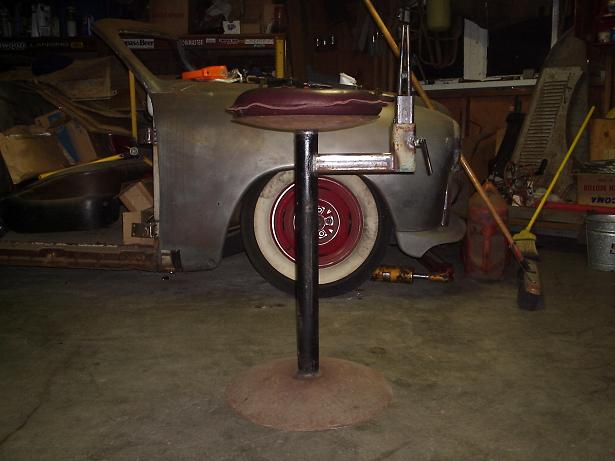

    hi guys, this is my tucking tool and stand. i copied this design from kerry pinkerton of imperial english wheels. the cool thing about having your tucking tool on a stand is its much easier to control the making of the tuck. Ian`s right about crushing the tuck from the inside on a flat plate being better as you don`t need a ton of different radius` to do your crushing. the key to tuck shrinking is the angle of the tuck (to shallow and the tuck spreads back out giving you no shrink.), the direction of the hammer blows, and patience. tuck shrinking is a lot of work. the best explanation i found was on www.metalmeet.com . do a search on tuck shrinking.

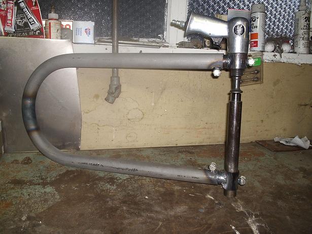

    Here is one I did a couple years ago:[​IMG]
    I used Delrin for the dies,as an experiment,but wouldn't recommend it.
    Study all the pictures you can find,and figure out how to make one for less.
    Any questions,just ask.

    here`s a pic of my portable planishing hammer, i have virtually no money in except i bought the good dies. if you have a lathe and a radius guage you can make your own. i`ve never tried the plastic dies, what was the thinking behind the experiment Unkl Ian ? i`m guessing no stretching just smooth planishing ?
    gary
