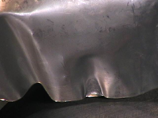

    I'm working on a video with some information on how to do tuck shrinking in it...slow going because I'm moving at the same time. Attached is a picture showing what I think is the easiest way to learn tuck shrinking. Just hammer the top of the tuck with medium blows using a steel hammer. It takes time but shrinking will result. Unhammered tuck on the left, partially shrunk tuck on the right. More in this album:

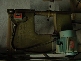

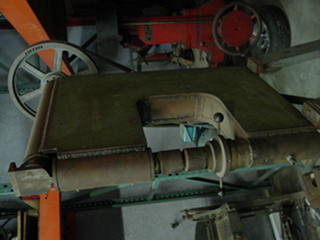

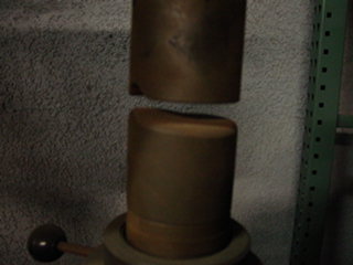

  7. Bluto
    Joined: Feb 15, 2005
    Posts: 5,113
    Bluto
    I know you thought I was just another Yuppie sports car guy :D
    Look close you can build your own machine Since I got the Kraftsformers I don't use this much
    Remember No flex!! The only way you get tight,big,parts is by being able to control pressures. If not you have extra fitting and cleanup
    Anybody tells you a flexible English wheel or Hammer is OK is just wrong

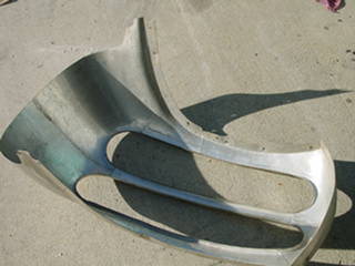

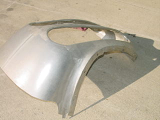

    OK No problem........
    First I'm a mechanic not a 'Tin Man' I don't have a s**** book. This is just part of my job!
    Second I NEVER work in steel only aluminum I only gas weld
    I made this....... It's just an average unfinished piece for me AND I'm NOT impressed with myself either but this shows I'm not talking thru my hat
    Like many of you I started with homemade tools Most of us can't afford good tools but that doesn't make wrong right
    I do use a cast wheel and a KF 460 and I still 'pick and file'
    I only work on my own stuff.When parts are finished they go on the car. I have no customers. As to a living? My last car sold for 2.5 million
    I've had five heart operations in the last 20 months I think it's fixed now and look forward to working on my projects again
    Two things I'm sure of ....
    With 30 years of doing this some of you might understand what I talking about
    And you have no F'n idea who I am...... And I like that!
    There is no 'Before' photo it was just a sheet of 3003

    Wow, Bluto, that looks awesome.
    Like you say, you're not talking through your hat.
    That looks a lot like a BMW 328 grille shell. Is it?
    Is it really made from a single sheet of 3003?
    If so, you know how to form a lot better than you can weld! :)
    You say that "It's just an average unfinished piece for me AND I'm NOT impressed with myself." Why not? It's obviously an impressive piece of work. Why shouldn't we be impressed? Why wouldn't you be?

    hi bluto, i am impressed. duece this grille was made in a few pieces and welded together. congrats on the 2.5 million , i hope you take 40 dollars of it and buy a shrinking disc as i believe you will grow to love it.
    as far as your secret iden***y, i think most of us could care less about exposing you . thank you for posting your pics. gary
