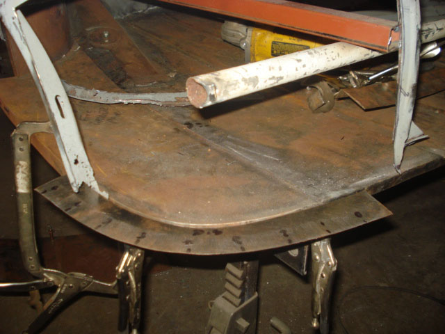

    Sled:
    Wooden bucket right side ready to roll...the paper on the fenders is just to know the amount of sheet metal needed,probably today or at last tomorrow this section will be shaped!Can't wait to have the english wheel,is a big time saving on such stuff...
    Will save the wooden buckets anyway,always useful...
    Luckily i have a very nice hood,requiring almost no work on it....
    As you see i started the bottom trunk flange also,needs more more rounding and shaping of course,but is comin up well too...
    Soon the full trunk area wil be over,makin the job much faster in other sections being the panels more accesible...
    The trunk lid will will be entirely clean,probably will an electric switch only...and an emergency hand cable in case of electric failure!
    Still undecided where the to mount the tailights...always loved em in the bumperettes,an old style trick ...give a very clean rear end wiew!

    More on the rear flange lip on bottom of the trunk...That's only 1 side first and on the last pic i shaped the other side that goes welded togheter...still some curving and adjustin but you get the general idea ....wanna get rid of the trunk area soon,got enuff there...

    Still some comparison from the old/new part....very tedious stage but there is no way back.Tomorrow will keep going on also...more news soon,hope you don't get bored here...
