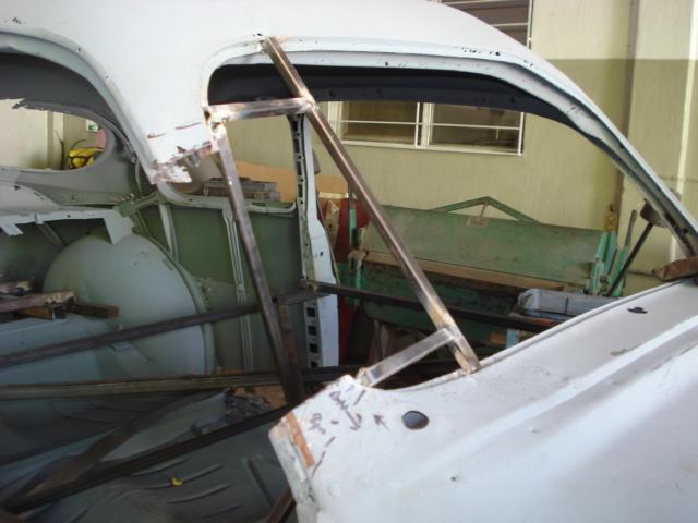

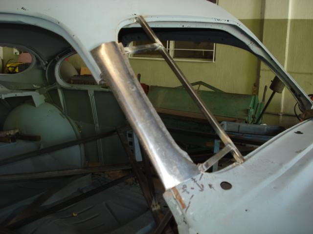

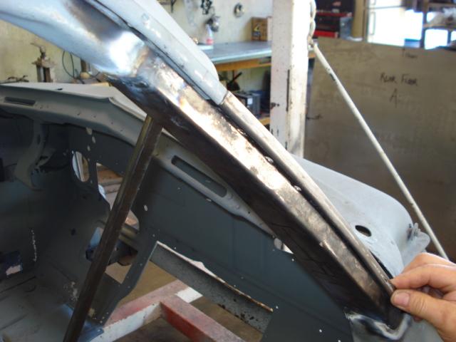

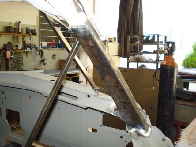

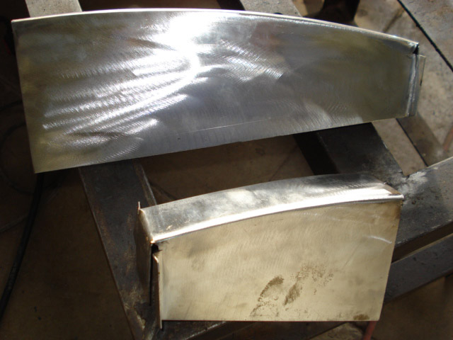

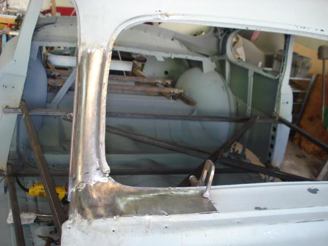

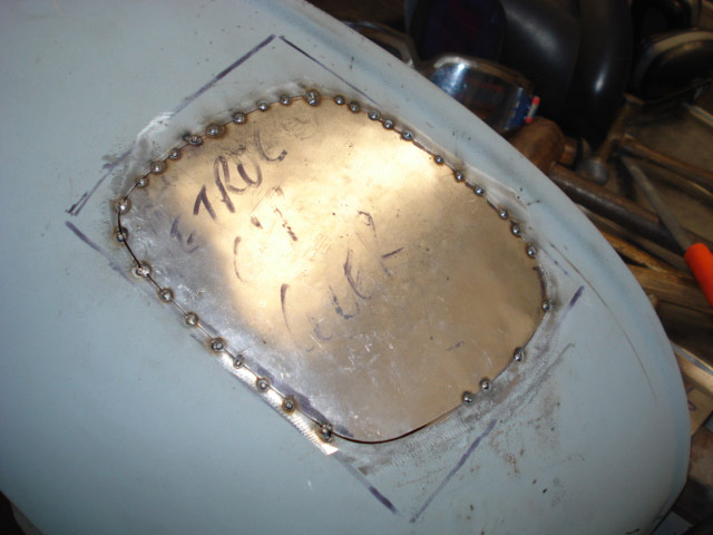

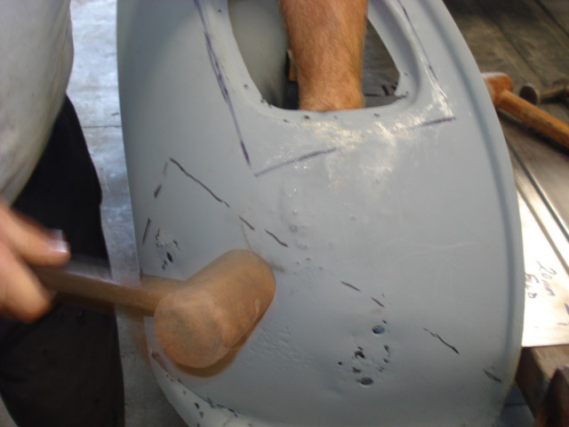

    here shortly the A pillar gone.a new one made in 3 different pieces joined togheter has been made...there are some inside lips and angles to fit,and is a bit tricky to weld it up togheter in a proper way...the rain gutter goes inside too!

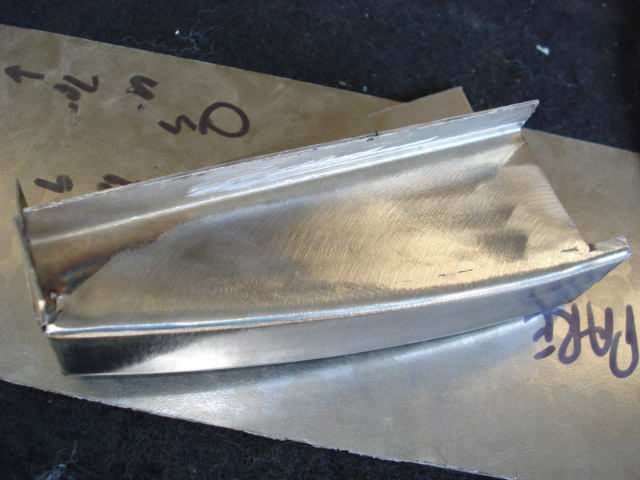

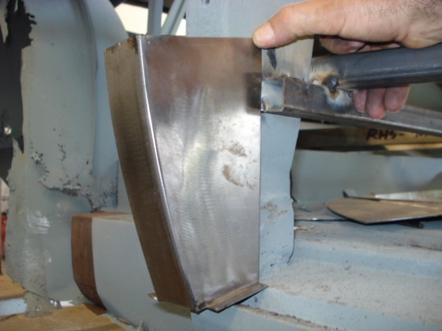

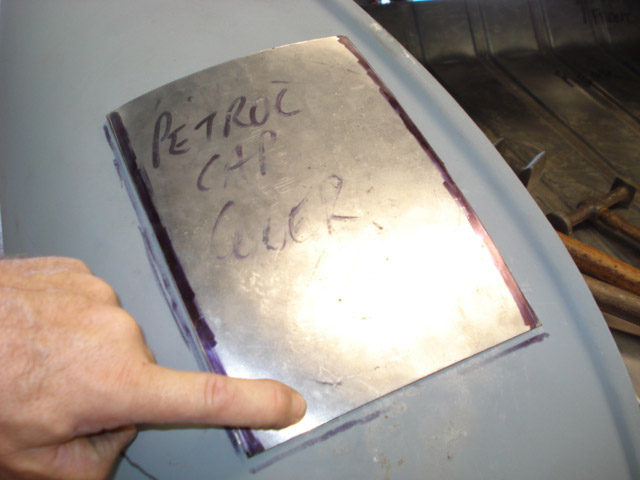

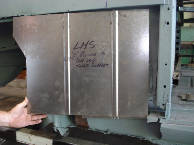

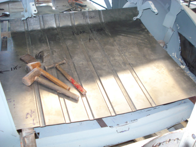

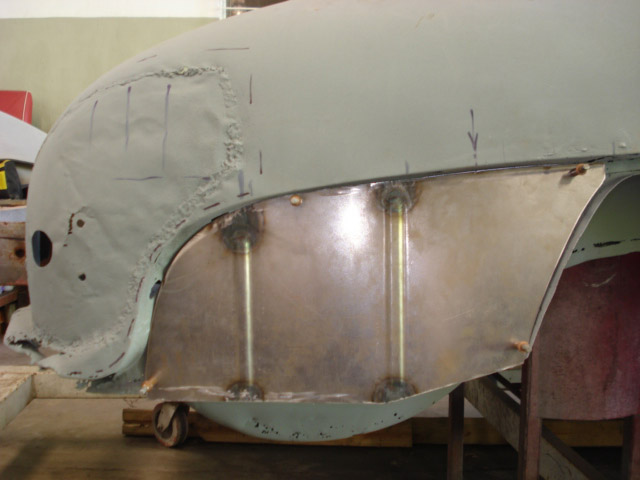

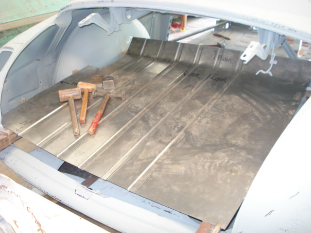

    the fabrication started,lots of measurements for the replacement panels all over...18 gauge cold steel used,same as original.
    floor trunk made,we'll start weldin soon....

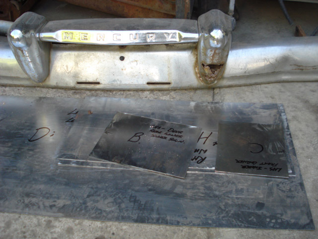

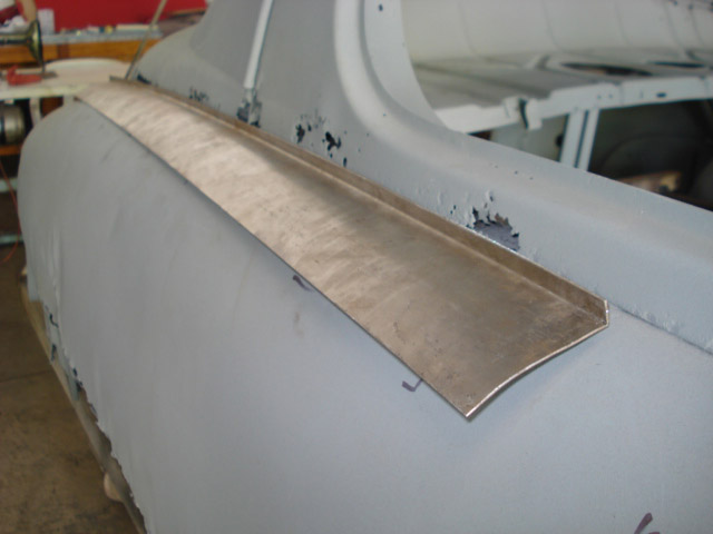

    some more fabrication details..gas door shut and keep on weldin...just the general idea of course...
    fellas,these are the last pix i have ,more to follow as soon i have some more work done..

    what are you using to put the curves and crowns in your panels, especially the longer ones?

    punkabilly,most of the crowns and curves comes from old shool metal skills,using all what you have on hand on shaping...
    mostly handmade with anything available to get the shapes desired.
    but in the real world ideally having access to english wheels ,bead rollers and shrinkers would be the best solution....

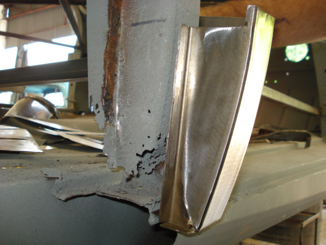

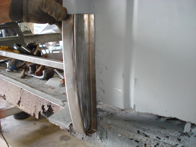

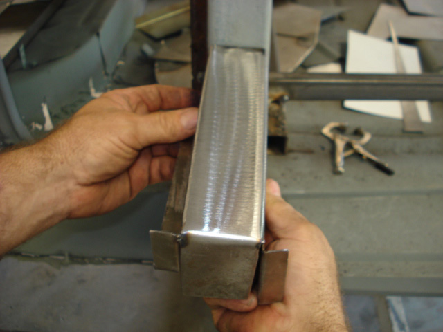

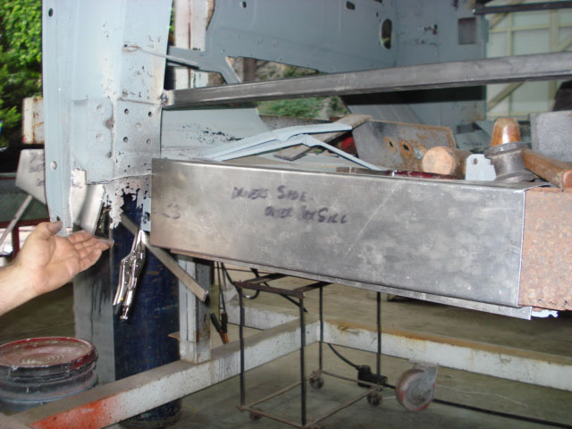

    B pillar lower posts built from scratch...all new!no messin around with small patches...
    did already the other side also...
    plus lots of small panels done ready later on to start weldin in...

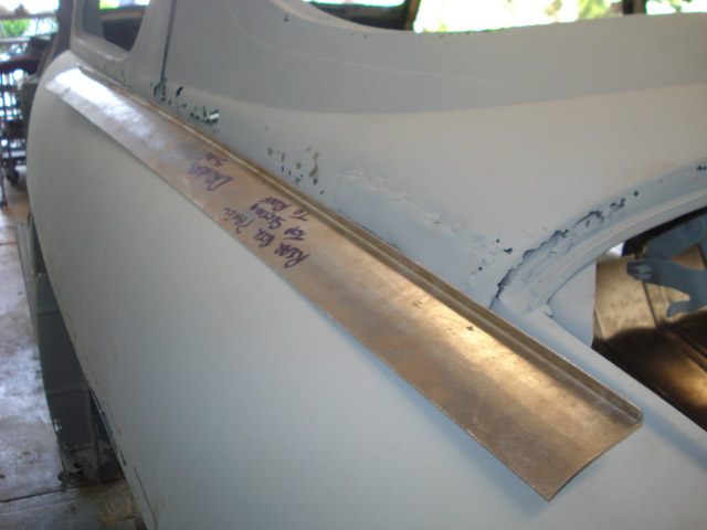

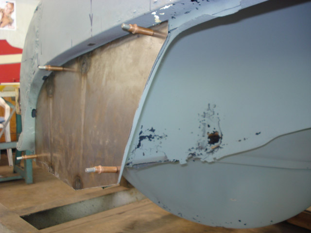

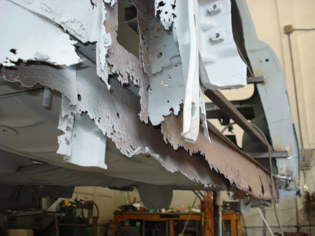

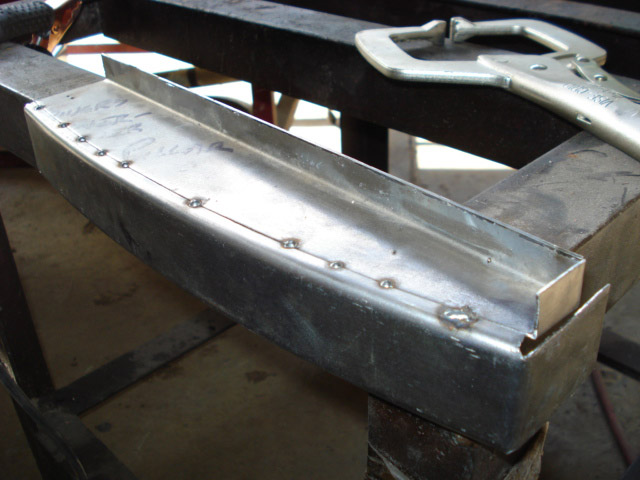

    some more parts done,placed just for mock up...as you see the lower rockers (inner/outer ) are gone.need a big bead roller to build em in 1 piece...
    but is slowly comin togheter...lots of measurements to puzzle all pieces togheter.in any case will keep all templates for the next car,lot of time saved at the distance...
