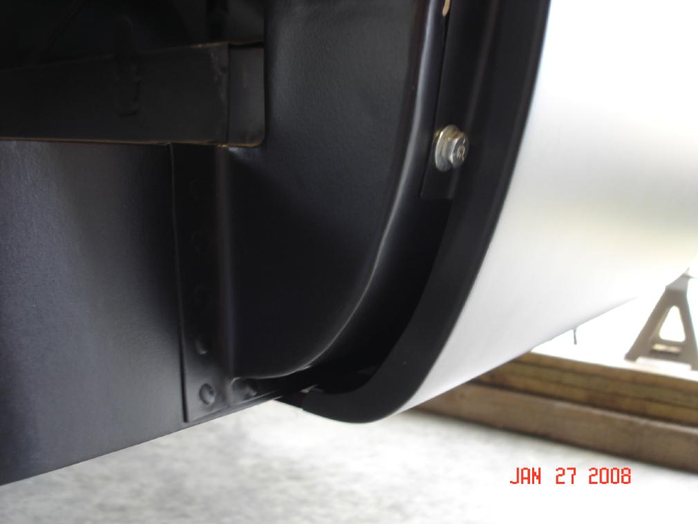

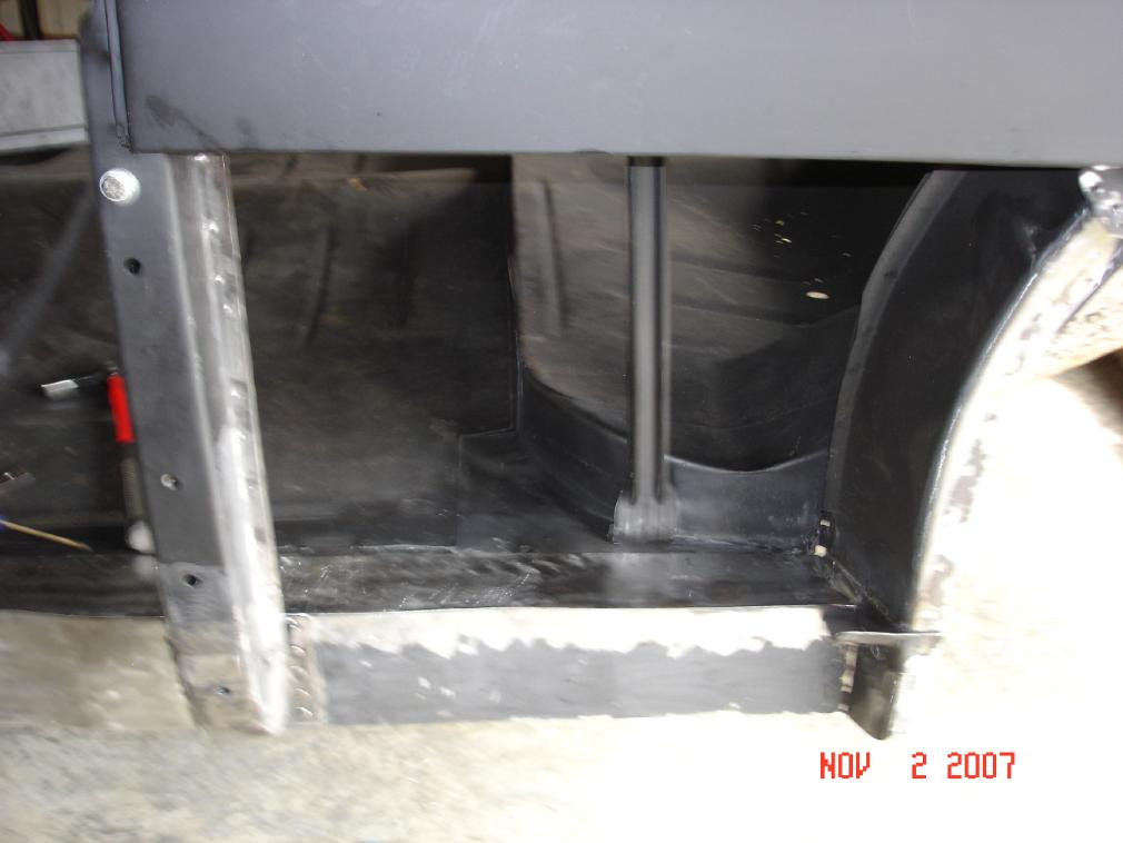

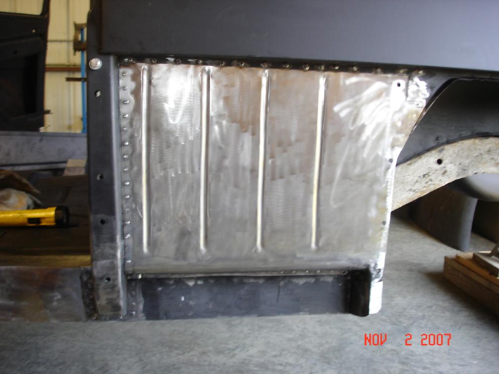

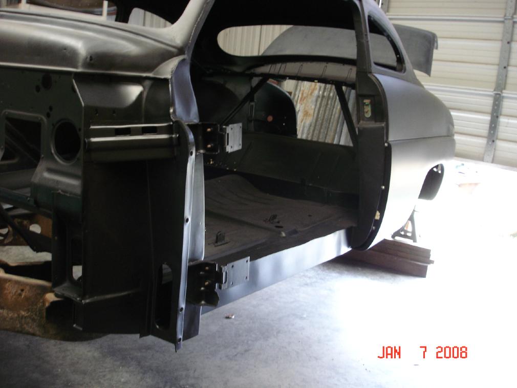

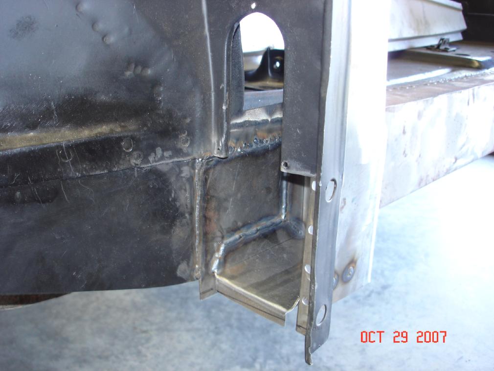

    Sled, not sure exactly what you need, but here are some pics of the left side of my 49. It looks like you need to lengthen your B post down the inner rocker instead of stopping at the top. Outer quarter conforms to the B post and wraps under the inner rocker. I tried to rebuild mine as close to original as possible. I have more pics of this area. If these do not help, let me know and I will try to find some that will. Ken

    Im doing the same thing right now on my 51 coupe, I dont have any measurements with me but I did cut everything out so I can replicate it close later.
    You will have to extend down the b pillar as said, there are two small upward tabs that mount to the inside surfaces (facing the door) of the a and b pillars. The b pillar then tapers down and the rockers also weld up to that.
    The bottom of my a and b pillars (surprise surprise) are junk and I have to redo them.

    Mid-Century-criser, thanx a lot for the pix...they help for sure!!need some more pix on the base on the B pillar from different angles and most important the exct measurement from the top of the B pillar /where the 3/4 panel is bolted to, to the bottom of the B pillar...
    i notice the B pillar stops a bit above the bottom rocker,how much is measures there ? half inch,3/4 inches or???
    i have pretty much clear the idea now,wanna just be sure to go correct with the m,easurements and start lenghten the B pillar tomorrow mornin right away...

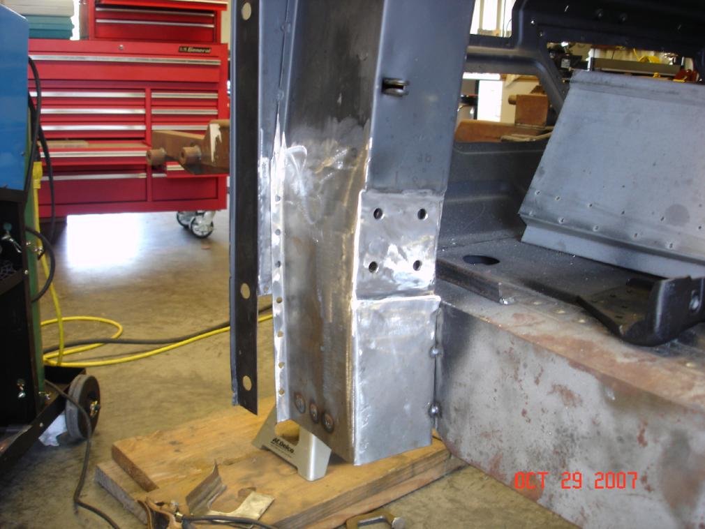

    Sled, here's another pic of the B post. Measuring from the top of the upper quarter to the bottom of the B post is 32 inches. Also measuring from the top of the inner rocker to the bottom of the B post is 4 inches. I don't think the length is critical as long as it doesn't go down far enough to interfere with the (bolt-on) lower quarter panels fit. I used my lower quarter temporarily bolted on, along with the door closed to insure I got the correct curvature of the B post when fabricating my lower patch piece. Hope this helps and thanks for the good words about my Merc. It was almost as bad as yours when I started, but I agree with you, these coupes are worth saving no mater how bad they are. Maybe someday I'll get around to doing a progress post on my car. Let me know if you need anything else, Ken

    Ken, thanx a lot buddy....i have all clear now,so i can start workin on quick as hell tomorrow....

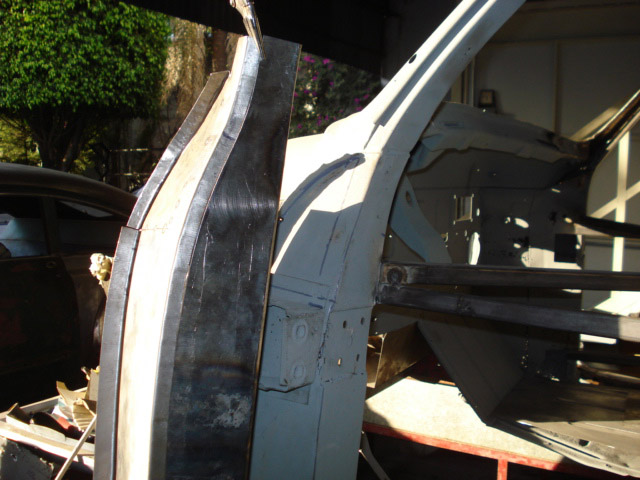

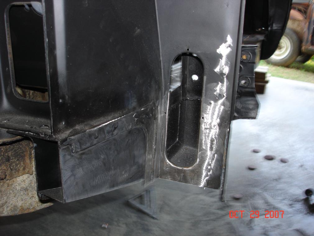

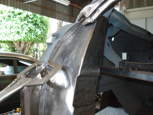

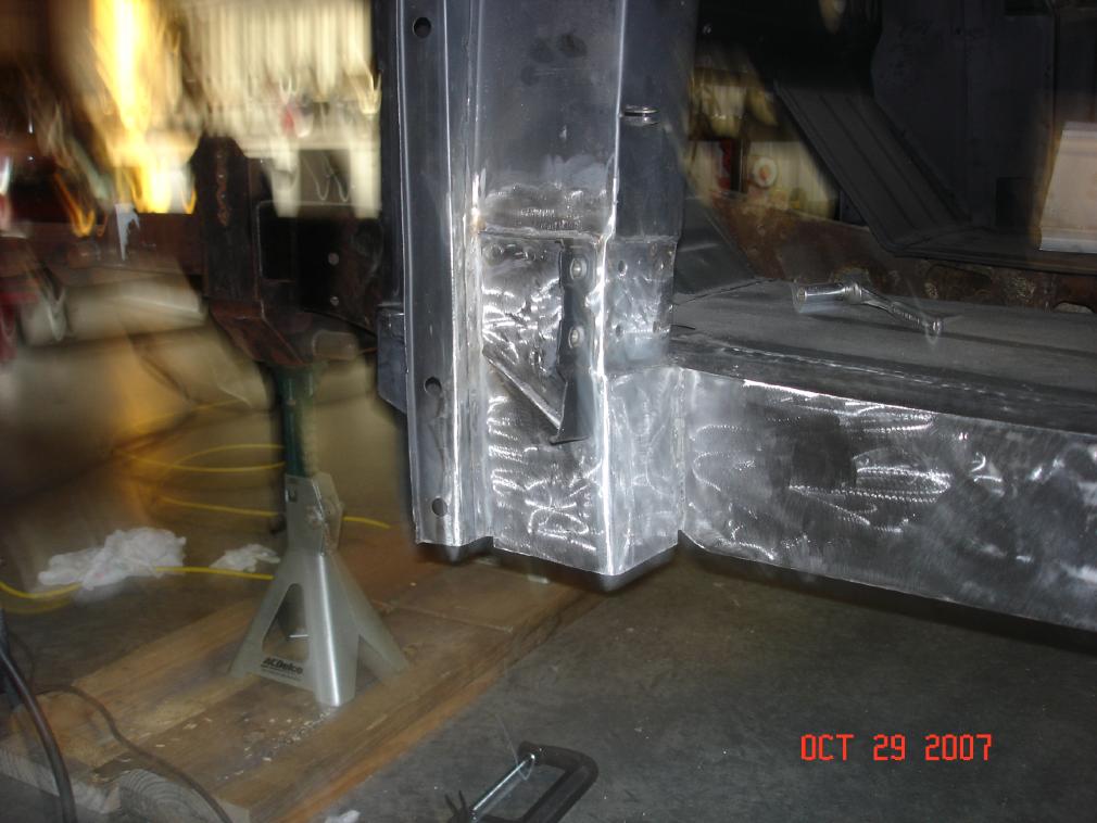

    Sled,here are some pics of the A pillar. Hope these help. My A pillar was only bad from just above the bottom hinge pocket down. I used three different pieces to repair this area just like from the factory. The inner piece curves under to form the bottom. The outer piece forms the recess for the lower door hinge. The front piece forms the 8 inch by 2 inch opening to access the hinge bolts. The top is already chopped, just needs a lot of finish out. I've got a sbc already built for it. I know I should have went with a flatty, but the moneys already spent. As far as the color I will probably run it in DP90 satin black for a while to make sure my bodywork holds up before I take the time to put a slick black or dark purple job on it. Again, just let me know if I can help. I have really enjoyed watching your progress since you are doing basically the same repairs that I am. Keep it coming Sled. I love this ****. Ken

    Ken,thanx a lot buddy,graet stuff...got the full vision now,already started this morning to push the thing....

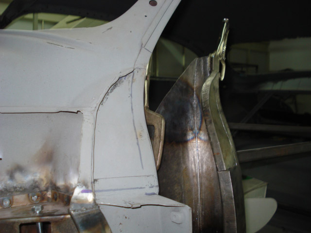

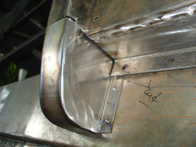

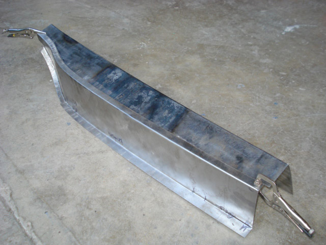

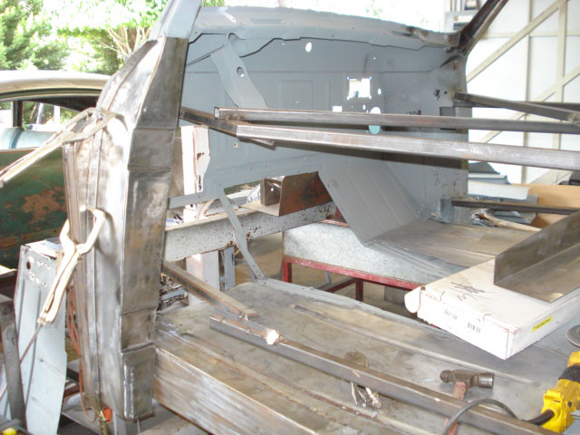

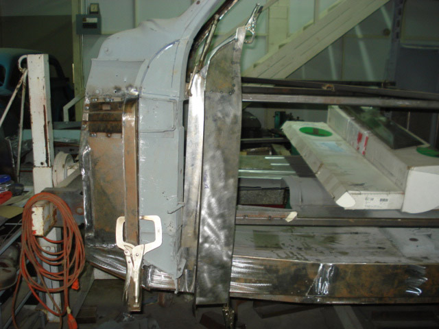

    After Ken pix and measurements (thanx buddy) i was able to speed up the B pillar and the 3/4 panel inner bracket..tried also the outer 3/4 panel and it fits like a glove,yeahhh..
    make me smile,finally!
    So,some small grindin and cleanin and tomorrow i'm ready to jump in the A pillar..will gone in no time,to the top...is rusted out,so a new one will be there soon!!!
    Gotta remove the body brakets soon,to finally cleanin the inner weldings indide the car also...but at list some more shiny stuff is kinda pleasin my eyes!!!

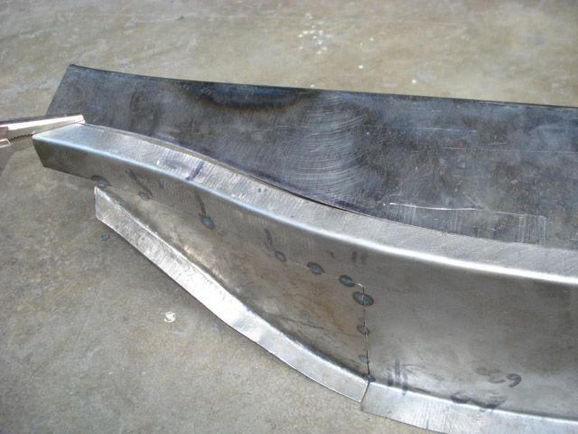

    Just got an idea from this! Awesome, I was wondering how to recreate that contour by the 1/4 panel going into the inner rocker, make it out of 90s! Great idea Sled, this thread is like crack to me.
    BTW...its lower 1/4 you are referring to? I keep reading 3/4 and getting confused... :)

    Next batch in this saga.
    Sled:

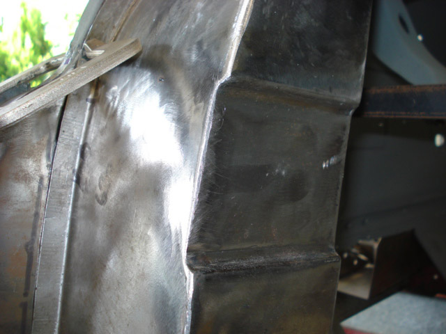

    A pillar shaping time...started to crete the whole A pillar,bendin,shrinkin and welding!
    it will totally replaced,up to the window line...
    also the inner B pillar section has been donne already...more shiny!!!

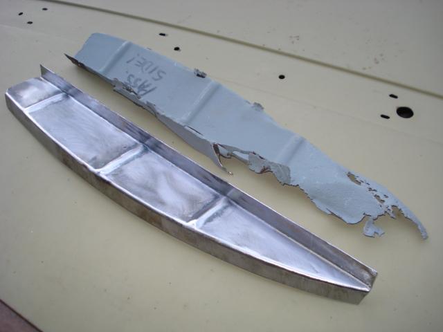

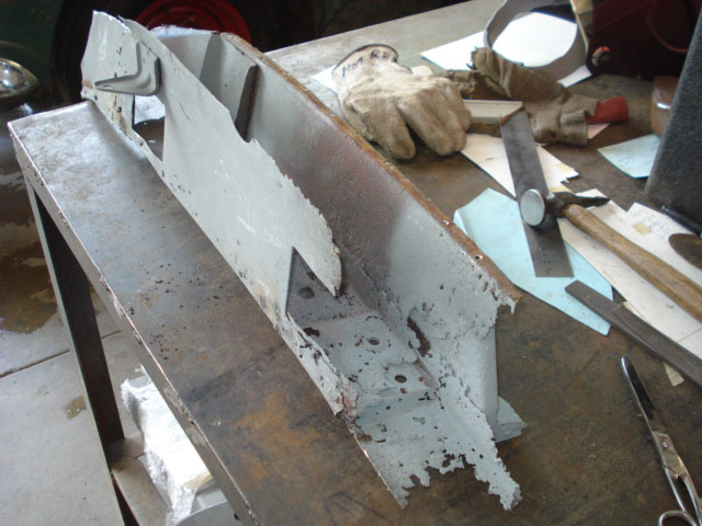

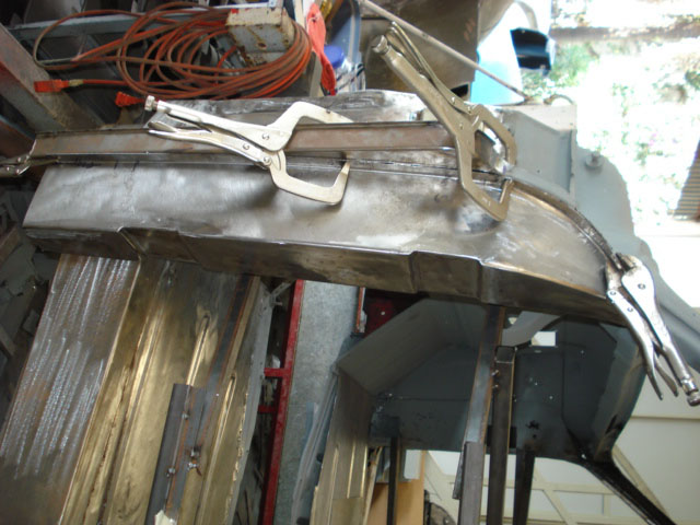

    Finally the A pillar is on...what a nightmare!this first set in,needs all the hinges reinforcment in the inner side,but hey..it fits perfectly!!
    Makes me smilin,really...this is a tuff part to shape,all the countors go in all directions...
    it makes a whole new difference!!
    as you see the rotten original piece to compare....
