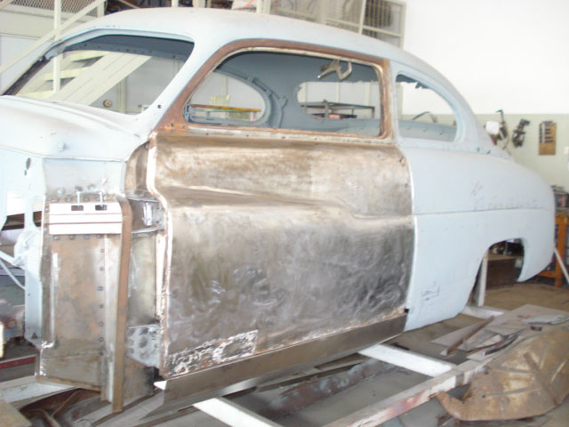

    Ken,i know...is very,very tricky to countor the upper part there...and there is more of course..i saved the inner brackets too..
    so,i took apart all pieces carefully,cleaned up,welded where necessay and start to figger out the correct measurements in the new pillar...
    the hinges position are crutial here...there is no margin of error,otherwise the full lines are wrong..
    both from the closer panels and the doors gap...they must be 3mm flat all around,no bondo or ****...only metal!!

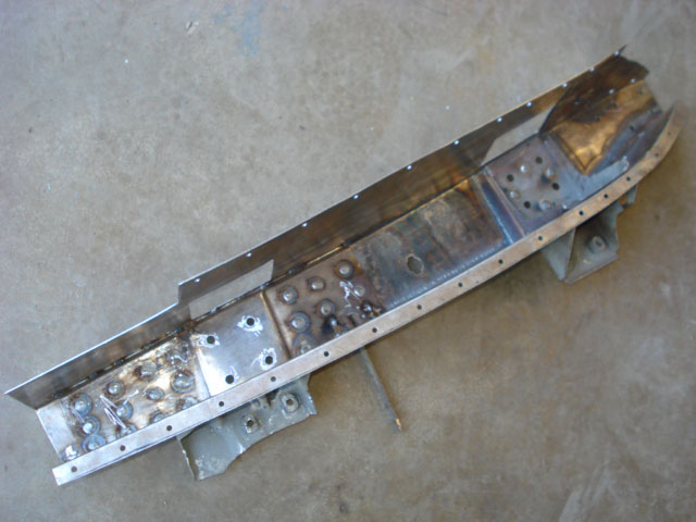

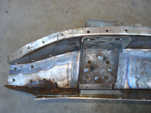

    Finally is over,A pillar is fully done!!Hinges brakets fully welded and reinforced,even better than original!That was something...
    i'm very happy about this,and fits just fine in place...
    so,after this will fly to build the whole rockers...

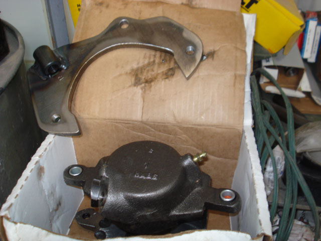

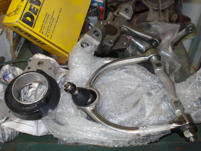

    Christmas is over,but not for me...collecting parts for the Merc...complete IFS front clip,hidden (under dash)brake booster,disc brakes and so on...All NEW,no average **** here!
    the 454 is already under contruction...
    still missing the rear leaf springs but have enuff to do anyway....

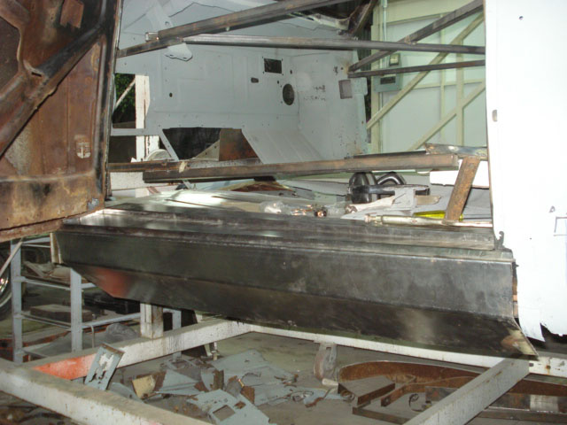

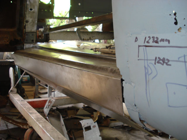

    Keep going with the new rockers,in 18 gauges.Strong and clean!!
    Also the first door fit and everything seems in the right place,no surprises so far...kinda happy about!!of course just presented the rockers in place,and from now on is all about fitting all new shape adjustments,all over....
    the door needs fully resto too..lower outside skin,new brackets and so on...will be like new soon.
    the 3/4 panel is not bad also,just a patch and GO!!!
    this side will be ready shortly....
    Got almost all new body panels ready for the p***enger side already,so it will be much faster then....
