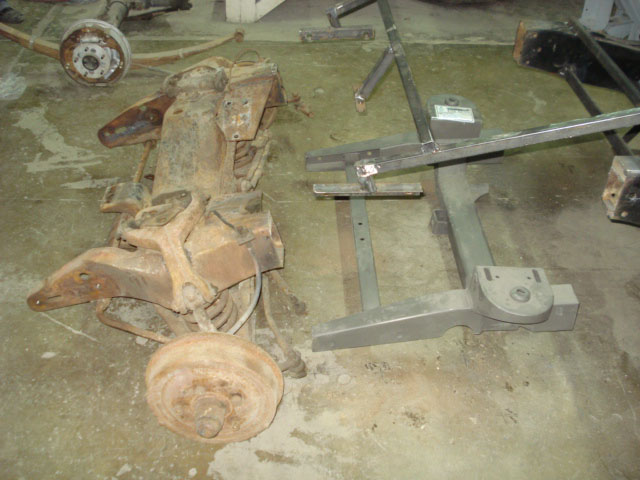

    ch***is time now...full braced and centered.currenly takin my time to level the whole things,and then ready to cut out...will use an IFS Mustang stage 2 from Fatman here,will be much cleaner on the overall look...stainless A arms,nice shiny stuff.
    Also due to the 454 engine use will use front disc brakes,gotta stop somehow...
    Usually i'm more into old style engines but ok,wanna have some fun here..so,will se how it goes...auto ****** indeed!

    Magnus B
    Progress in Mexico
    Message from Sled:
    after some slow times,finally the front clip is ON!!!Took the time to triple check all measurements,aligmment ,diagonal references,and bla,bla....have a tolerance of 1mm here..
    also i found that the original clip was bent,and was not good enuff to follow...
    But is over,1 more step done....
