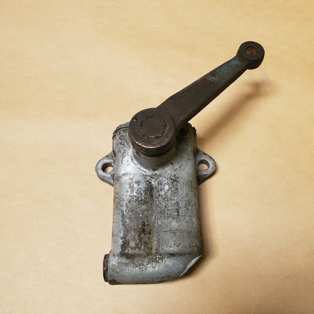

    Another in the never ever ending front end questions, for those of you running MG rear lever shocks on the front of your car how did you connect the lever to the spring perches? Normal dog bones appear that they wont work as the MG levers have a hole.

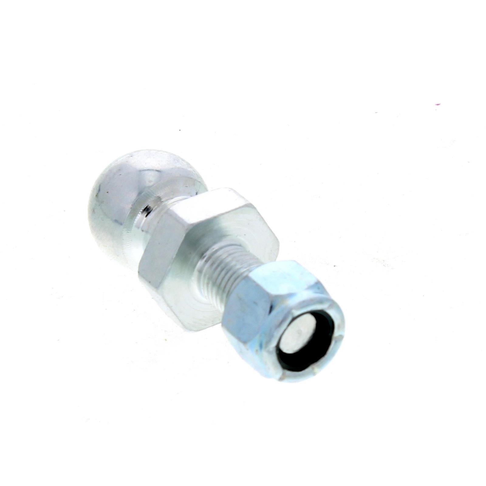

    Some of the stock Ford shock arms have a tapered hole and a bolt in ball. You could do the same. Repro parts vendors sell them.

    @alchemy cheers for that, didnt know they existed but with your help and after a little seraching I do now :) Problem solved, viva la HAMB.
    Dog Bone Link Ball.
