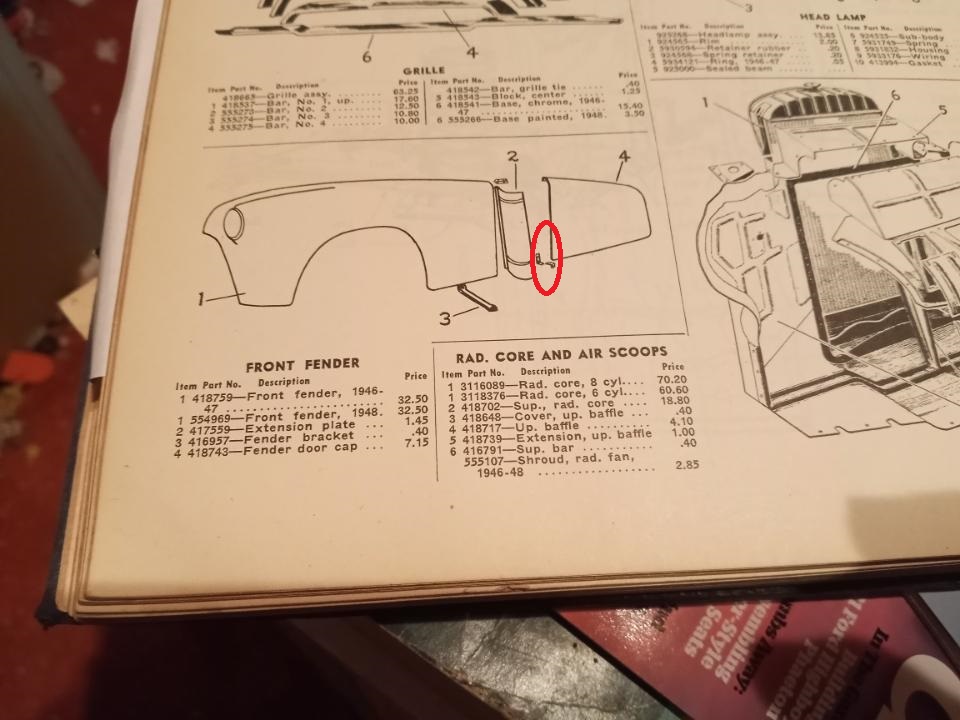

    They bolt around the upper perimeter while along the bottom they have two brackets that are each two pieces with three sides and a slot that slide within each other to be adjustable for depth to get the distance correct so they fit within the front fender when the door is open. The Chevy, which I have experience only with, has two outward bumps on the door sheet metal where the brackets go. I will look in the AM for an extra bracket I know I have if nobody sends a pic along first.

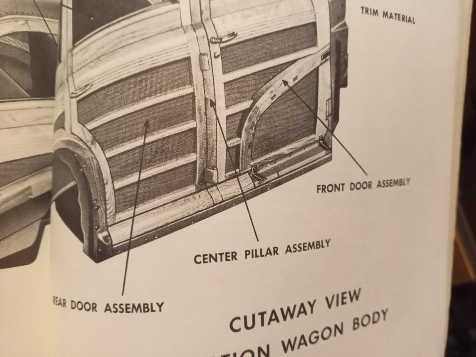

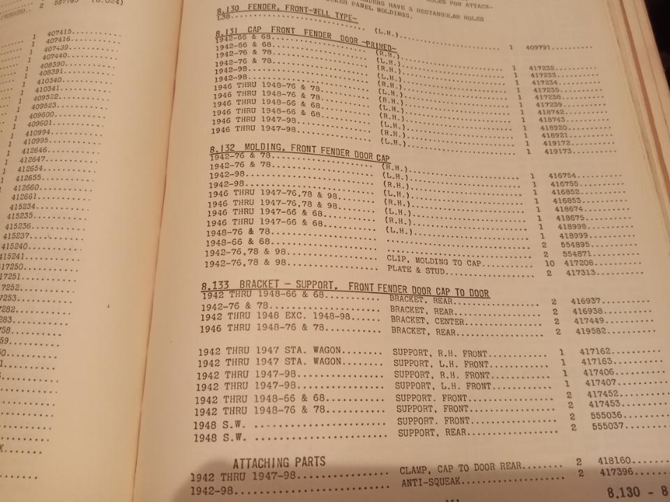

    I was expecting to find a illustration in the Olds parts book but nothing of that. I can look at the 46 Chevy tomorrow also. The woody picture is pontiac but would think it's a similar setup.

    Yup, I looked through all my Old's manuals, but could find nothing :(
