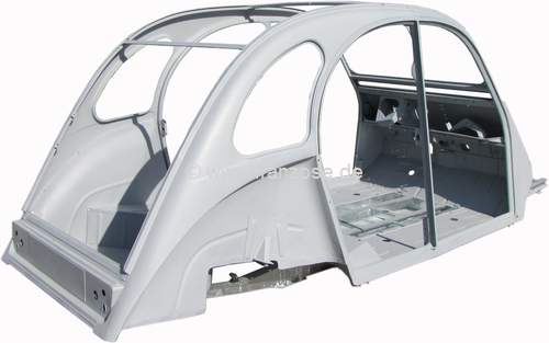

    15010.jpg Thank's Bill,
    on this photo (epoxy paint) you can see the rear end that i made myself, normaly it is vertical and does not folow the line of the car, i decided that it is prettyer when the line drops further with the body 1fcqdz.jpg
    on the first photo here you see an the original rear end :

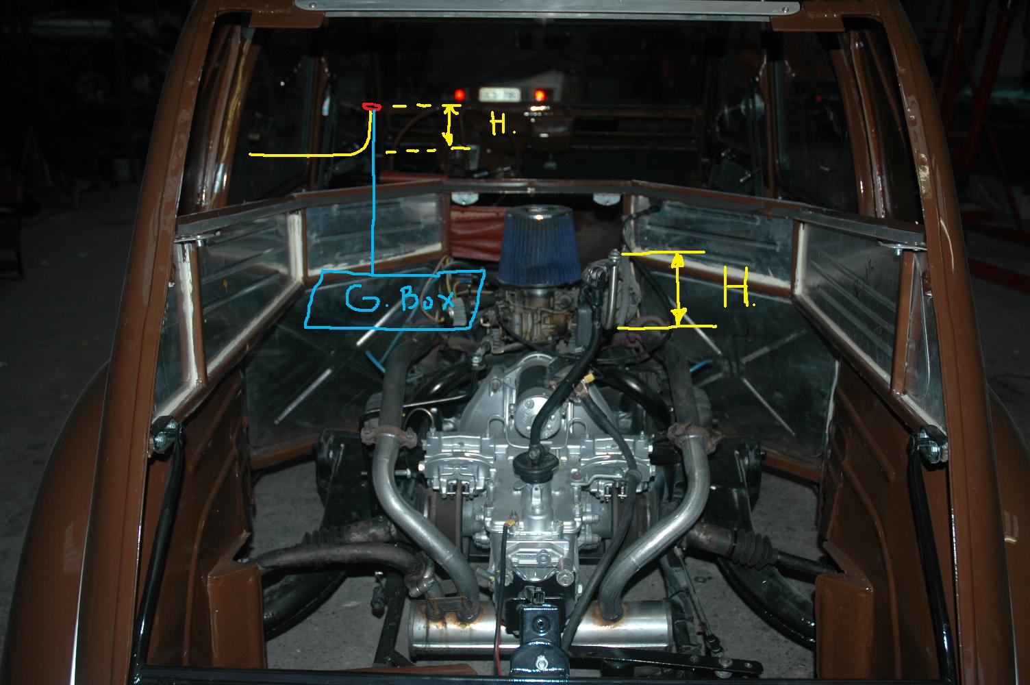

    Those are the homemade inner fenders : a8hf7.jpg
  8. ami6
    Joined: Feb 7, 2015
    Posts: 24
    ami6
    from belgium
    And here you can sse the position of the engine and box with the ultra very very long gear shifter , never thought it would work, but it does to my great surprise! ;-)Also you can see the homemade floorpanels , original was not an option since the body is channeled . m9aqu8.jpg

    To be clear, this is NOT a twin engine! I moved the engine!gearbox
    from the front to the back, that's all,
    up front i have an empty gearbox with the disc-brakes on it and the gastank.
    volvobrynk likes this.

  19. ami6
    Joined: Feb 7, 2015
    Posts: 24
    ami6
    from belgium
    Hello, for Martin,
    whatever you do, don(t know how th original shift lever is on your car, but TRY to keep the original height that i drew in yellow "H" the original height, shorter or longer gives problems! I had to shorten a bit the lever fixed on the gearbox (in bleu) and that allready gave me troubels. again, try and error with s**** metal is the way to go, don(t be satisfied with " well, it's almost ok, i'll leavy it this way" because you can't imagine how much you shift ... DSC_2883.JPG
