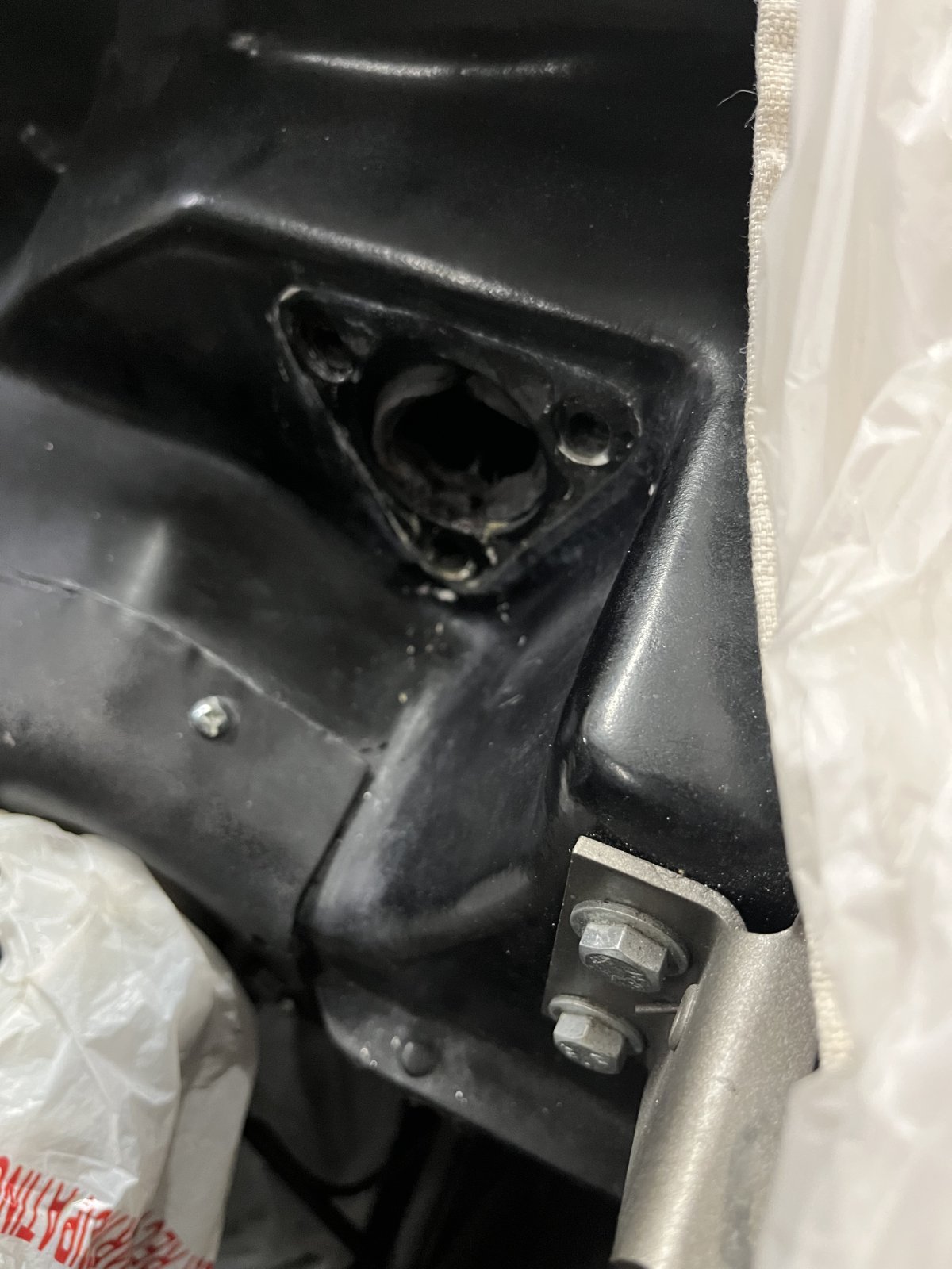

    They're not Corvette brakes, they're aftermarket. The 60s-70s Corvette disc brake master cylinder isn't quite so easy to adapt to the early cars, as you'd hope. It has a three bolt pattern, and is recessed into the firewall a ways.

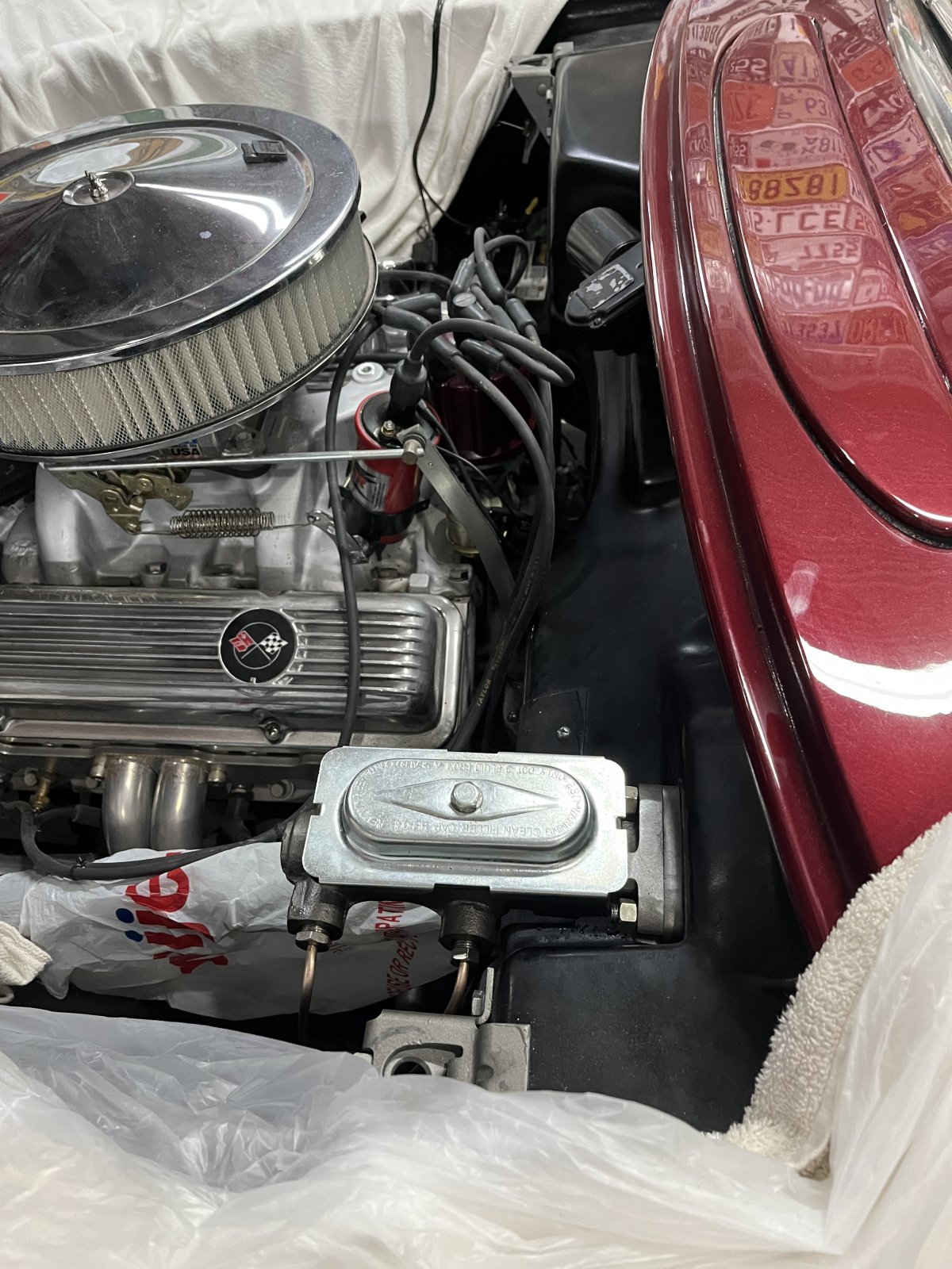

  18. Here’s why it’s hard to use a common master cyl on these cars. The mopar cyl has a larger 4 bolt flange with room to adapt to the vette pattern F4088F7B-CCDA-4F4D-9A47-149A87C35FEF.jpeg D96CC649-C4B3-4EAF-BE83-C2DAD1418EBF.jpeg

  20. Thanks, i bought an auto parts store master and had a machinist buddy cut it up with plans from the corvette forum. It’s a fairly popular swap

    Understood and agree it would look better without it. May Check out the Mopar 1973 Dart (A Body) Master for Manual Disc Brakes. I've used it on several projects with great luck.

    lumpy 63
    Thats whats on my Vette, Scotty sent me the drawings I did it on my lunch break at work.

    What bore size MC did you use?
    Deuces likes this.
  24. I believe it’s 1” bore
