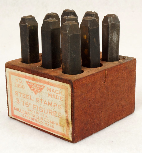

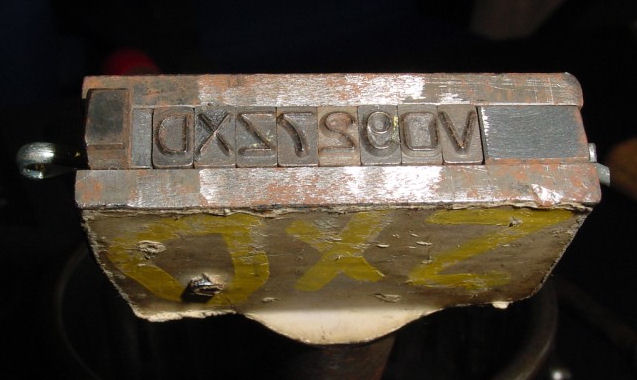

    This is exactly why the engine block stamping's are so correct and consistent, its because of the special fonts and special tool carrier known as a "GANG STAMP"
    That last "F", no matter how close it looked to the others, it wasn't applied with the correct gang stamp.
    More likely than not, somebody tried to use a set of Miller's Fall's letter's, to try to fool who ever wasn't paying close attention.

    That makes sense as they would not unload that gang stamp and use the same “F” that was the first position in the stamp.
    When I was in high school I took printing and we had many letters in the box of “F” s
    So you right it is not the same as the first F

    If you go back and look close at the stamping you can plainly see that the second F is not from the same set of (proprietary) characters that Chevrolet used to stamp blocks. You can plainly see that the bar (cross stroke part of the F that is in the ctr top to bottom) is not the same as the first F distance wise. the bar in the second F is closer to the top and the first F the bar is at the midpoint. even though they are gang stamped and it is not the same letter if it appears twice, they surely would not use a letter that does not match their proprietary letter set. that stamping is certainly a fake....

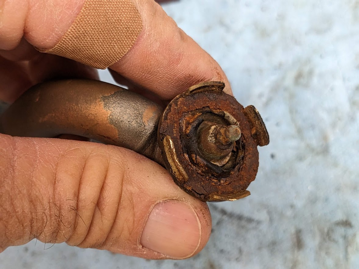

    Now that it's getting cool out, it's time for heat. I've spent the past few days getting the heater installed in the Vette. I got to reseal the Ranco valve, and build a defroster box as well. It's all back together, and ready for the first cool evening test drive!

    It's nice to know you dry state fellas get rust like us rust belters up north of you, somewhere on those solid body rides...:)
    Yeah that needs fixed...

    yeah, but most of the rust is inside the cooling system :) out of sight, out of mind, I guess?

    The heater works. But it does leak a little at the valve, the new repop washer did seem a bit thin around the outer edge. Oh well.

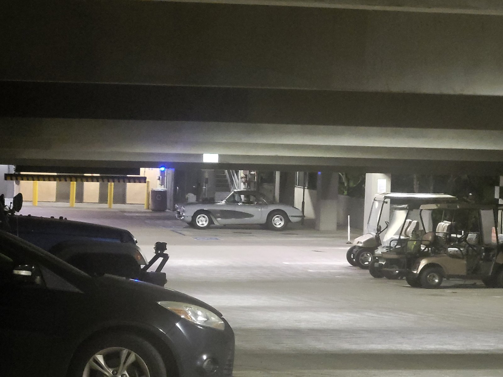

    Seen today - I sent Jim a PM on the taillight.

    Notice the most interesting part of this picture is the presence of a lady in the p***enger seat.
