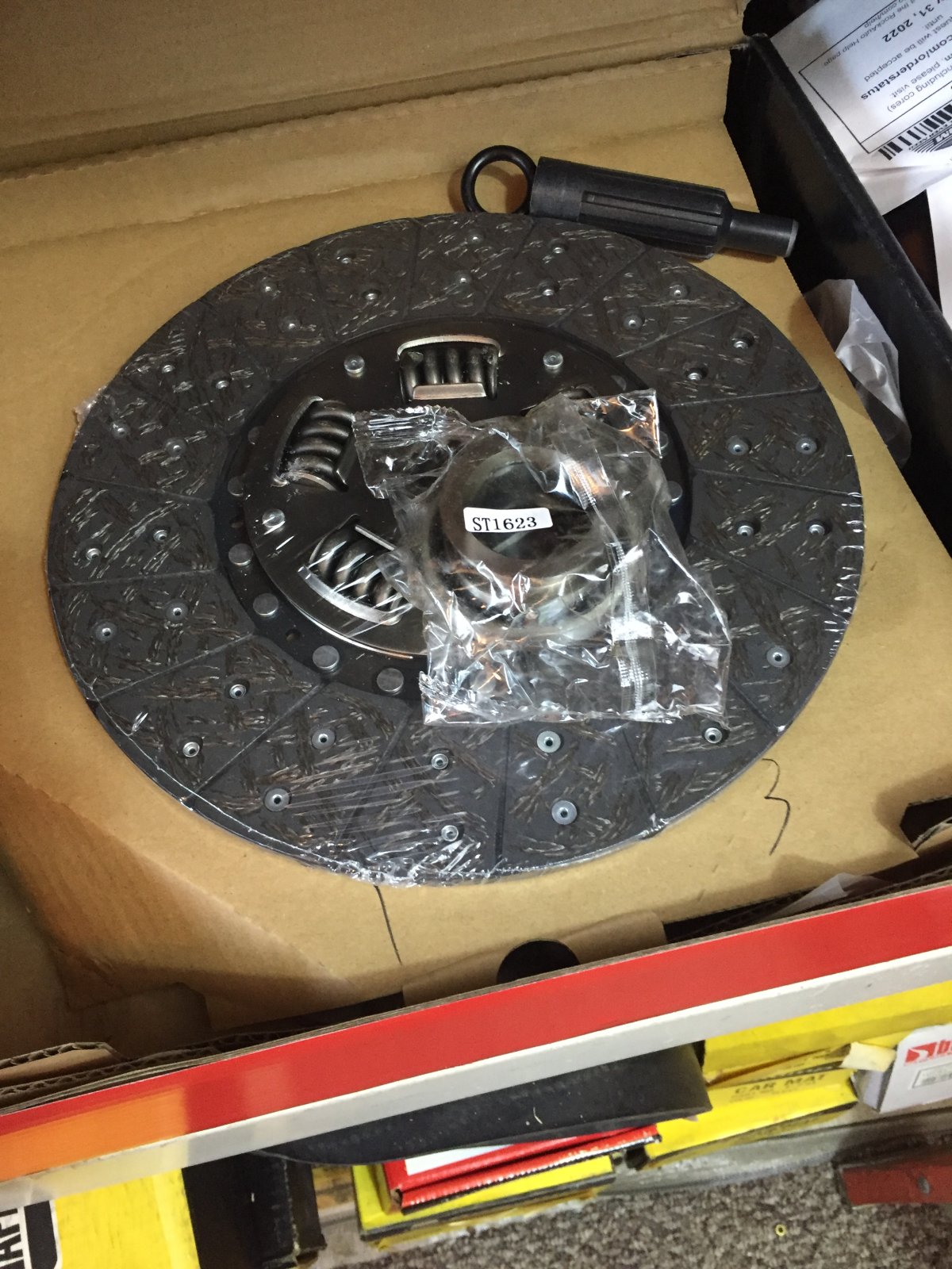

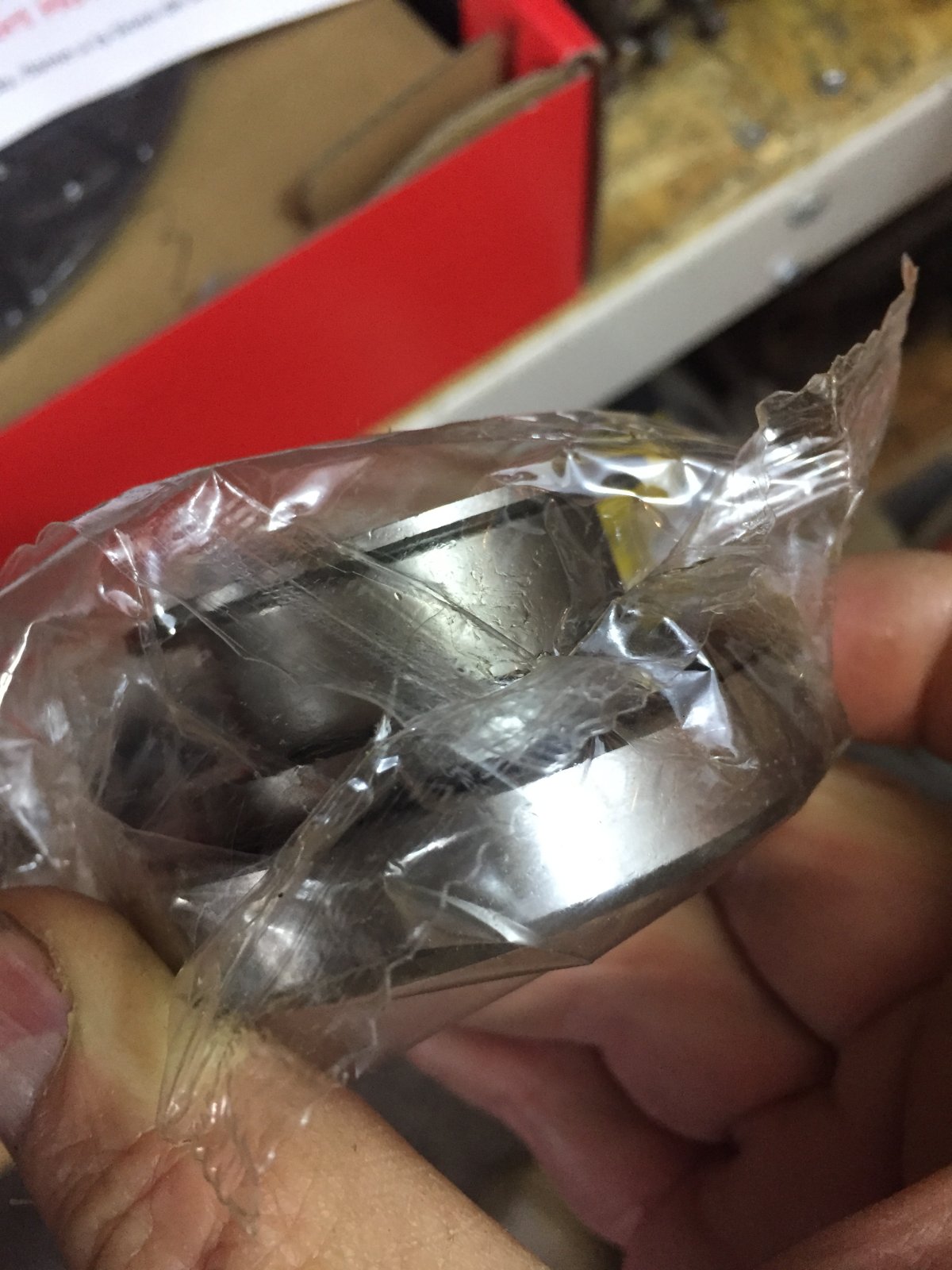

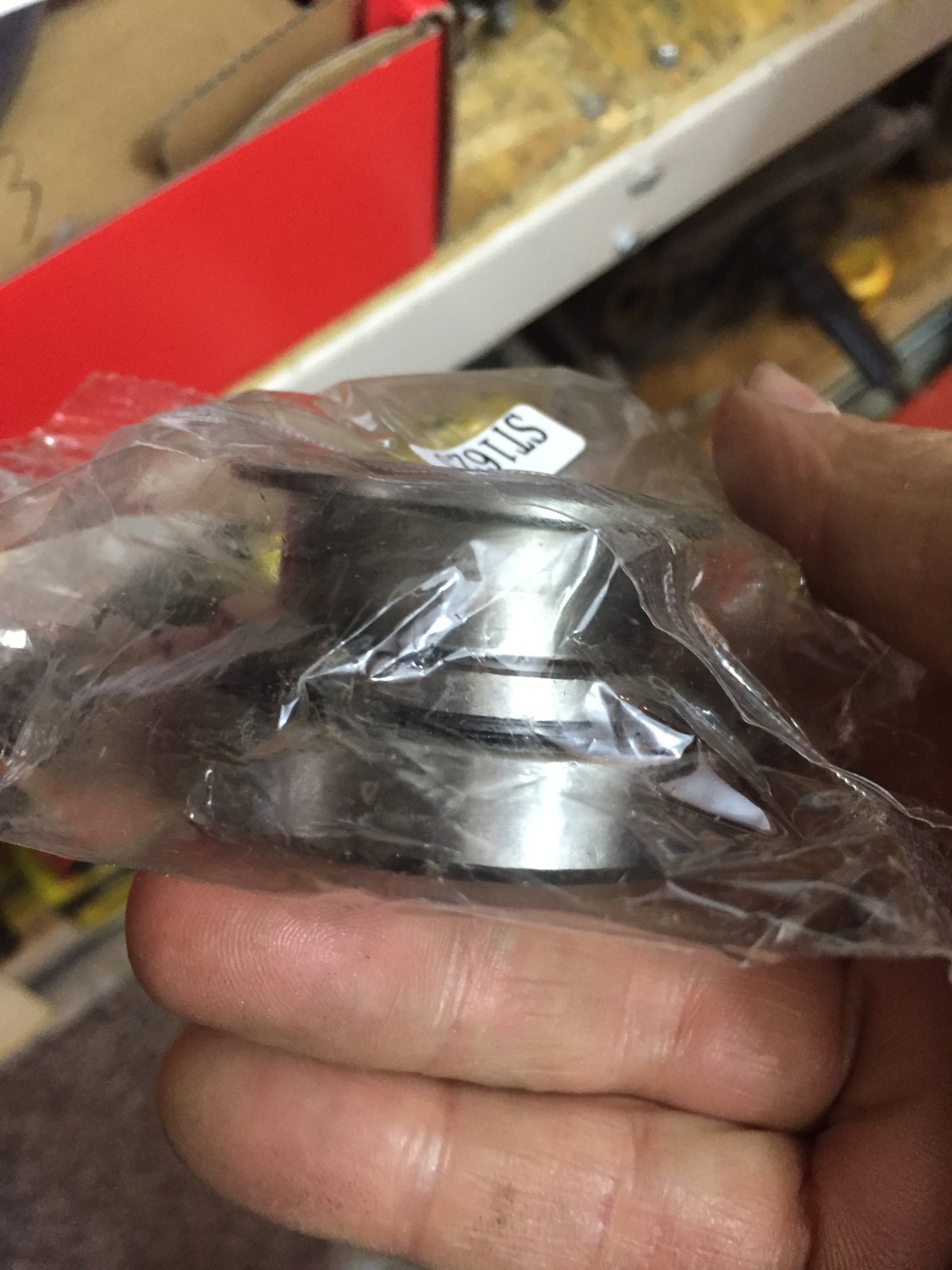

    I keep an 11 inch Chevy clutch here. (I like keeping spare parts on hand) just looked, no bumps. I have put countless clutches in and I have never seen one with bumps. Is this something they just started doing?
