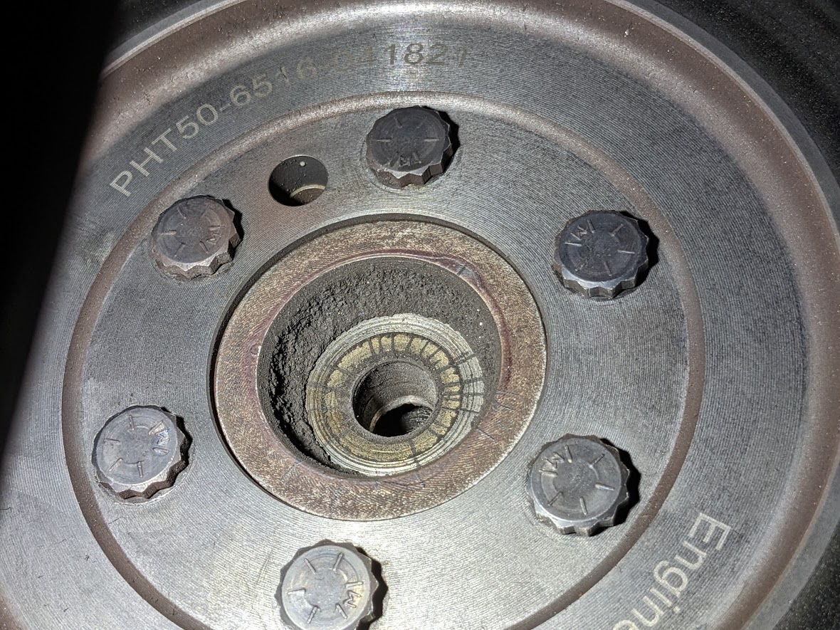

    Been working on the smaller replacement.
    And back to the clutch noise. I pulled the transmission again, and the clutch. Yeah, the bushing is shot!
    But it doesn't want to come out, it just laughed at my slide hammer, and it's giving the cape chisel a run for it's money.
  11. 57 Fargo
    Joined: Jan 22, 2012
    Posts: 6,232
    57 Fargo
    The Lego ‘vette is super cool!
    I’ve taken to just cutting a slot through pilot bushings with a small carbide but in my die grinder.

    I tapped threads in one that wouldn't come out and made a plug that screwed into it with a grease fitting in it. then i used my grease gun to "hydraulic" it out

    Yep, the hydraulic method works.

    This time buy a bearing instead of a bushing.

  19. lumpy 63
    Joined: Aug 2, 2010
    Posts: 3,380
    lumpy 63
    Jim was it gray or bronze looking? I got one recently that was gray in color and I put a magnet on it and it stuck:confused: It went directly in the trash.

    That bushing is suspect. I'd replace it with a proper oil-lite bronze bushing. I've seen other folks use those roller bearings and they dried out from the heat, failed, and destroyed the input shaft.

    When I converted my 56 to manual trans I had a hard time stabbing trans despite using an alignment tool. Next thing odd was car rolled upon start up despite applying the clutch. Things got ok after next try at start up. Then a few month’s later the clutch would squeal. It was the pilot bushing. Changed it out and all good since the early 2000’s.

    I got the old bushing out. I'll do some magnet testing in the morning. I have two replacements, one looks grayish (in a new Dorman package), the other looks bronzish, I think it came from an old Dorman orange bin.
    The pilot on the input shaft looks ok, I polished it up again to be sure.
    I don't like the bearings because they eat up the input shaft whey they go.

    I agree Jim , I never use bearings .

    I don't think it's an alignment issue.

    I used a bearing in the Barracuda, almost all the oem stuff is roller bearings and unless you sit with your foot on the clutch, in gear, it’s not really a factor, although I suppose the lack of turning may be equally as bad for it…

    I made up a couple of bushings during my machine shop days, I should have made a bunch. I used the last one around 1984. I always put a good radius on the entry side and used a small amount of Lubriplate when I installed them.

    I have seen this happen, when the block has been line bored. Needed to get offset dowels to correct it.
