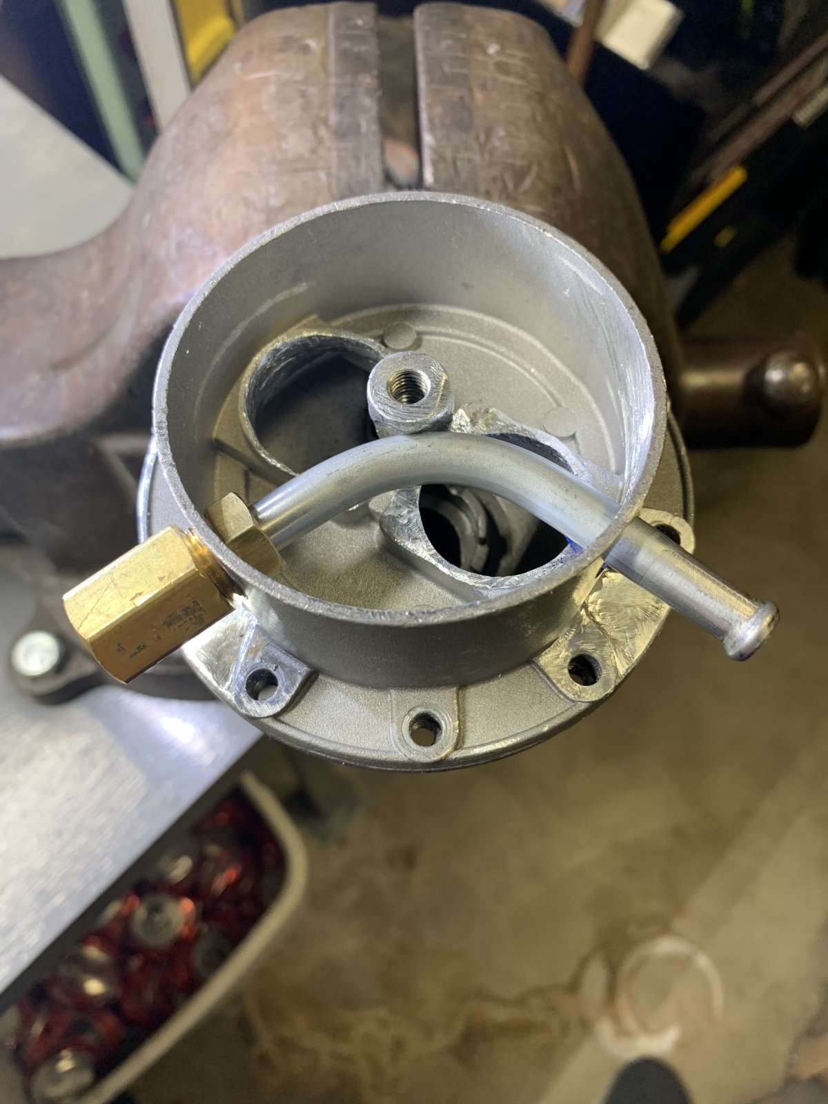

    Carter M6900 made a huge difference in the red 56. So much so I’ll be doing away with the electric fuel pump and this set up in the 57 soon. IMG_0691.jpeg IMG_0692.jpeg
